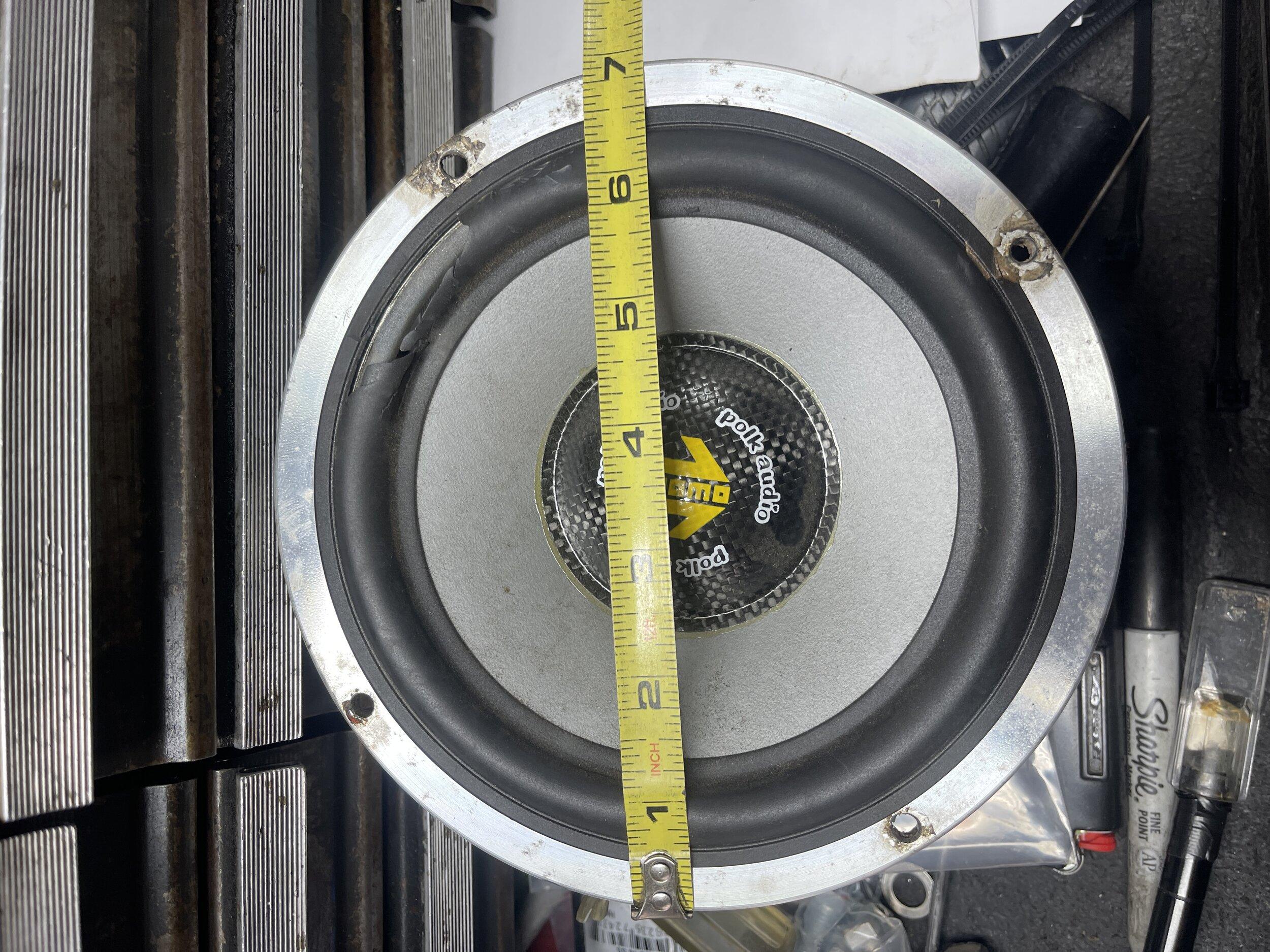

I put an email out to Polk, but im guessing these are going in the trash....

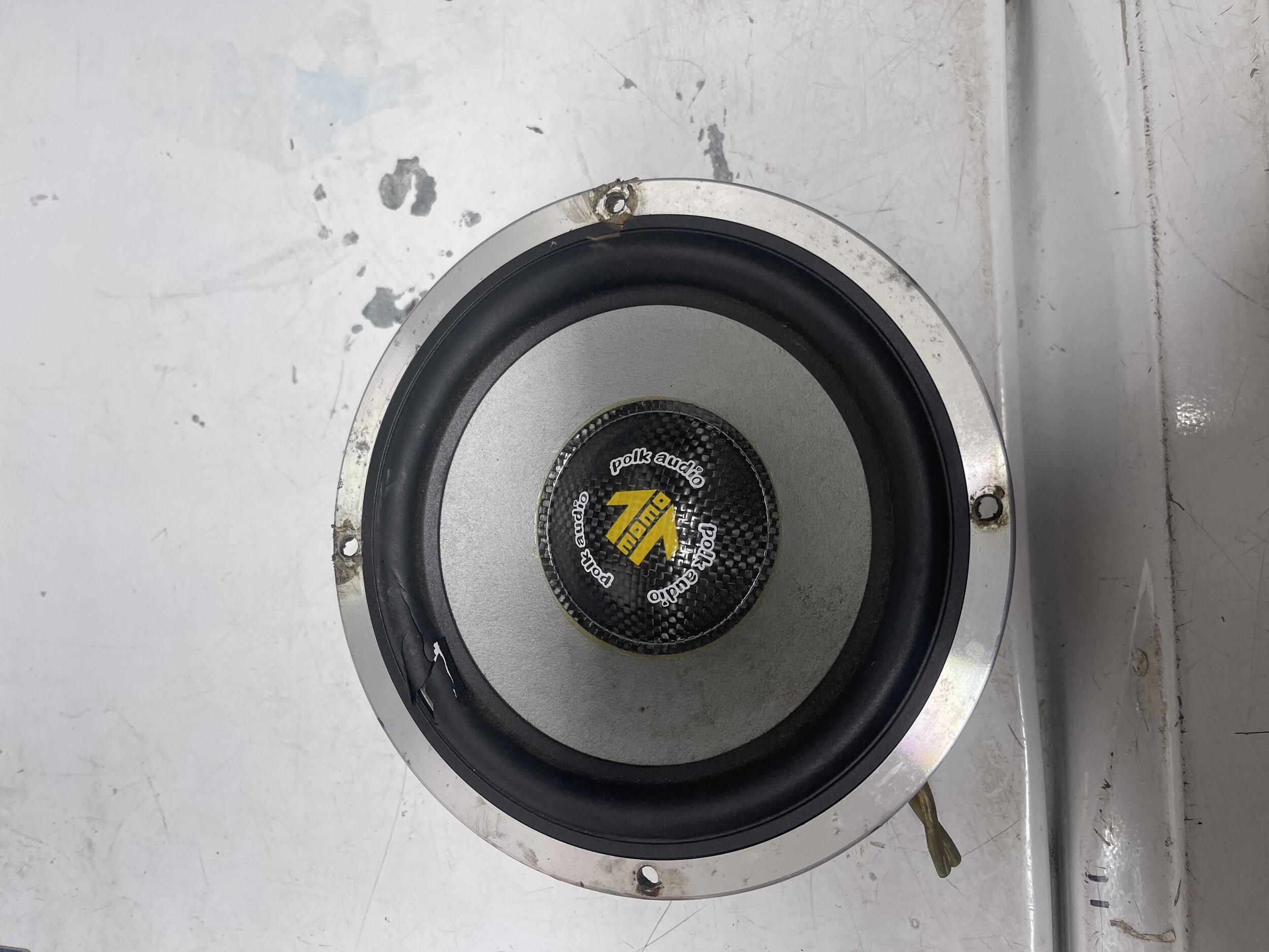

Thoughts, can the surrounds be easily replaced & is it worth it...?
Im not attached to them, but if I remember correctly they were a small fortune back in 00 & they still are really loud...
I vaguely remember the foam surround instructions from Fix-my-speaker, but if memory serves me well, you can refoam them without removing the dust cap. Step was to glue the foam to the cone and once set, glue the foam to the frame while playing music on very low volume. When it is off center you will hear scratching. When centered, it plays clean.

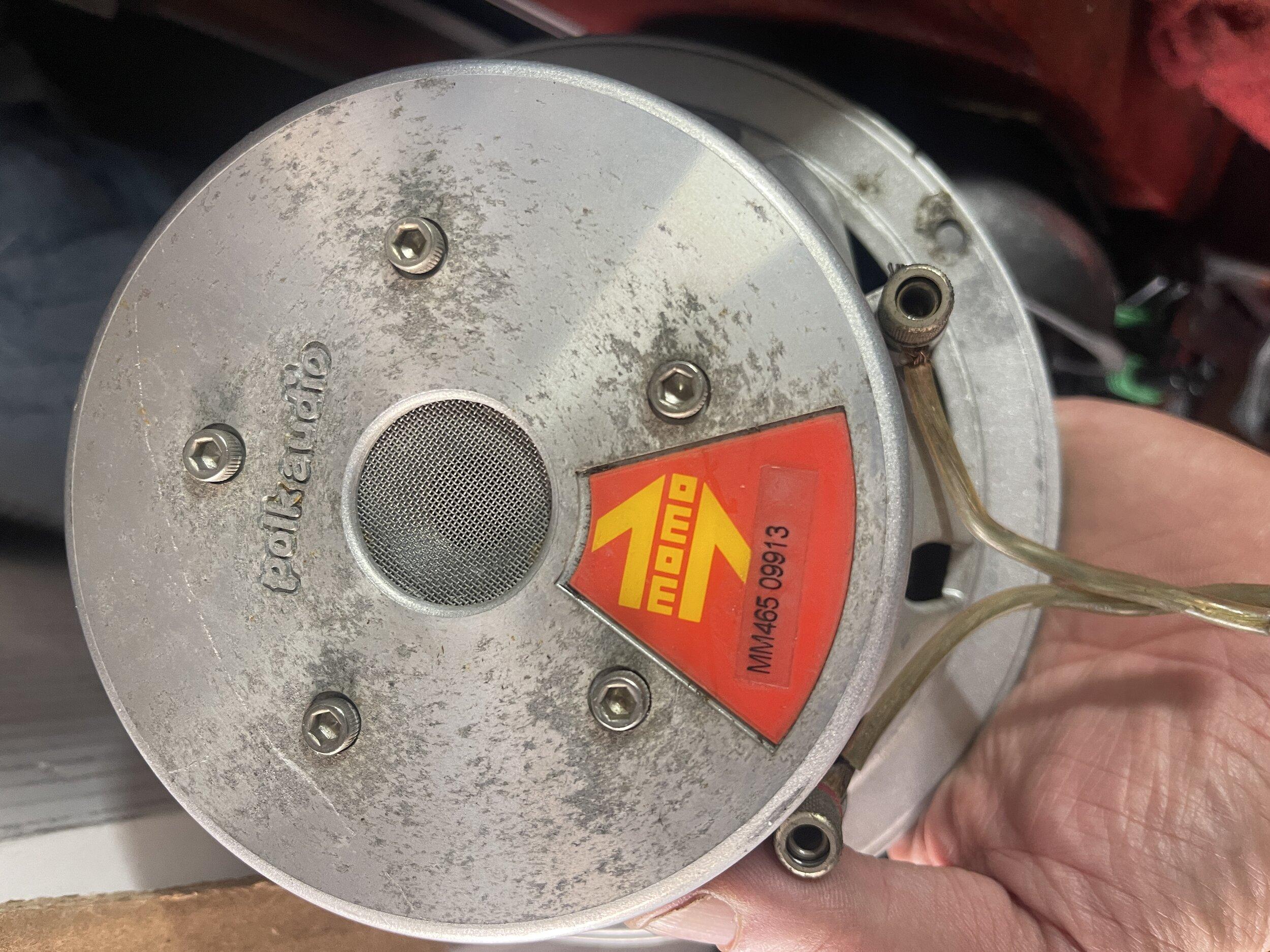

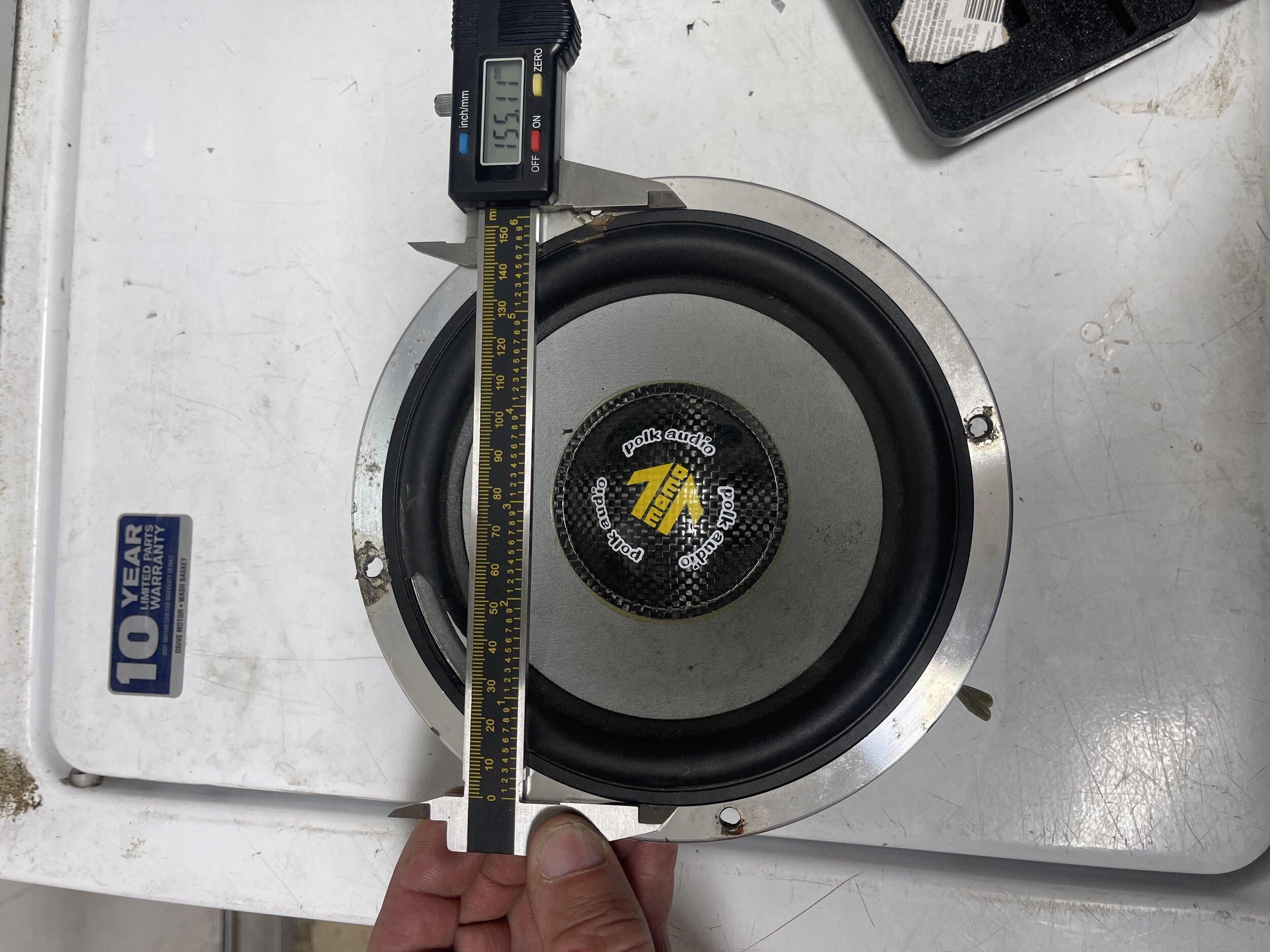

Per specs & verifying with Polk, these speakers are 6.75" & I cant seem to even locate some foam surrounds in 6.75"
Probably not worth the trouble but sucks as these were loud & sounded great....
They still sound great, just surrounds are torn.

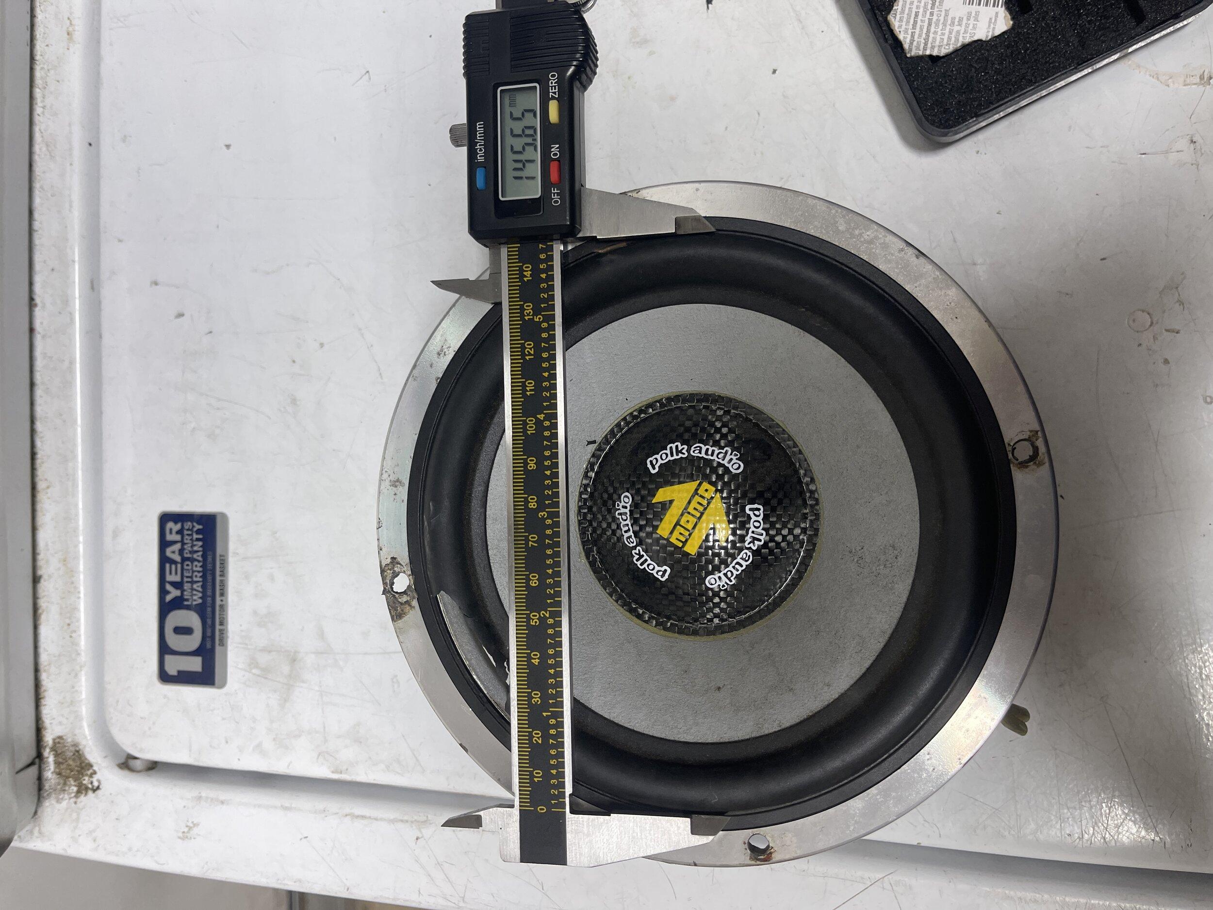

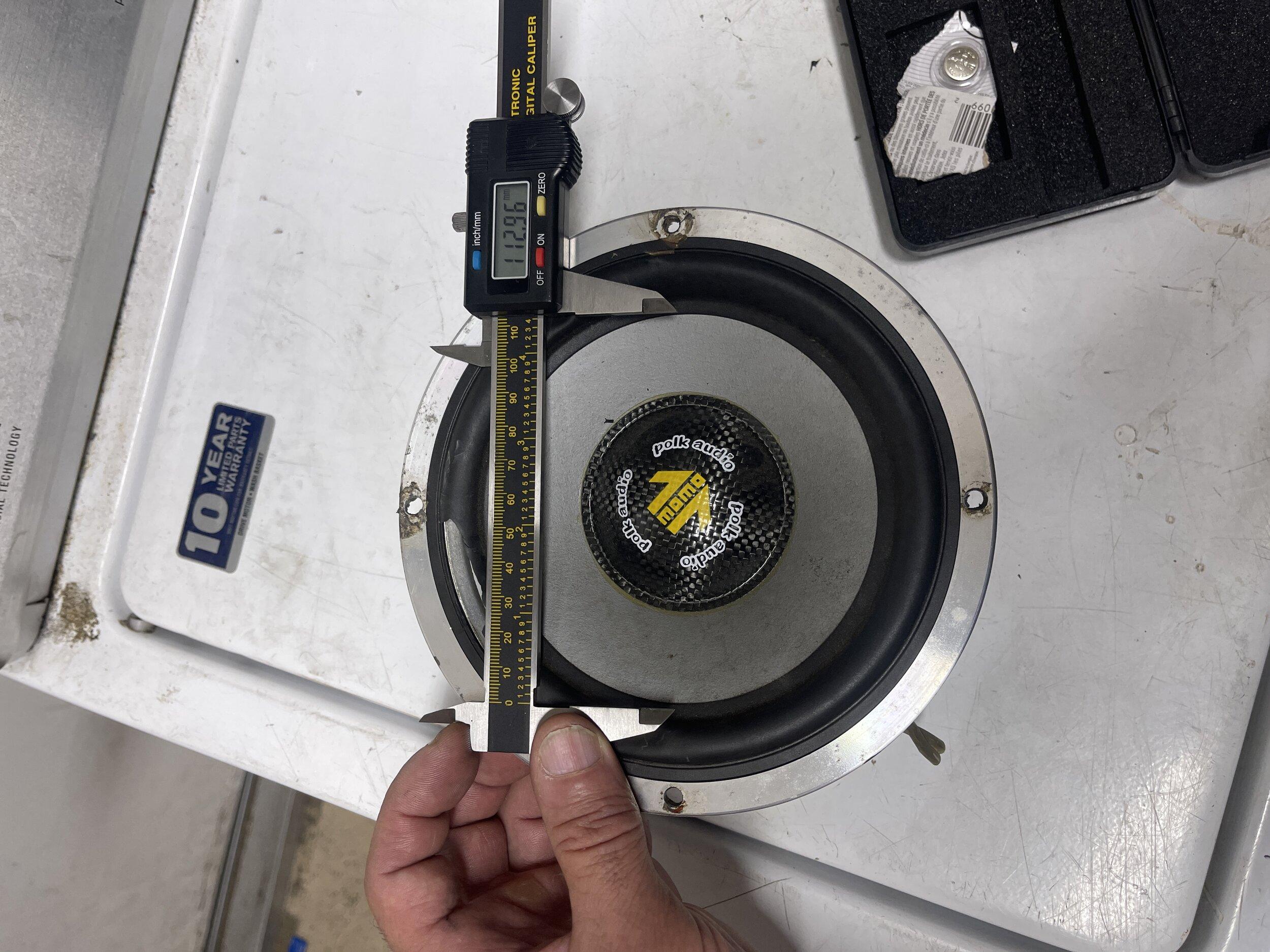

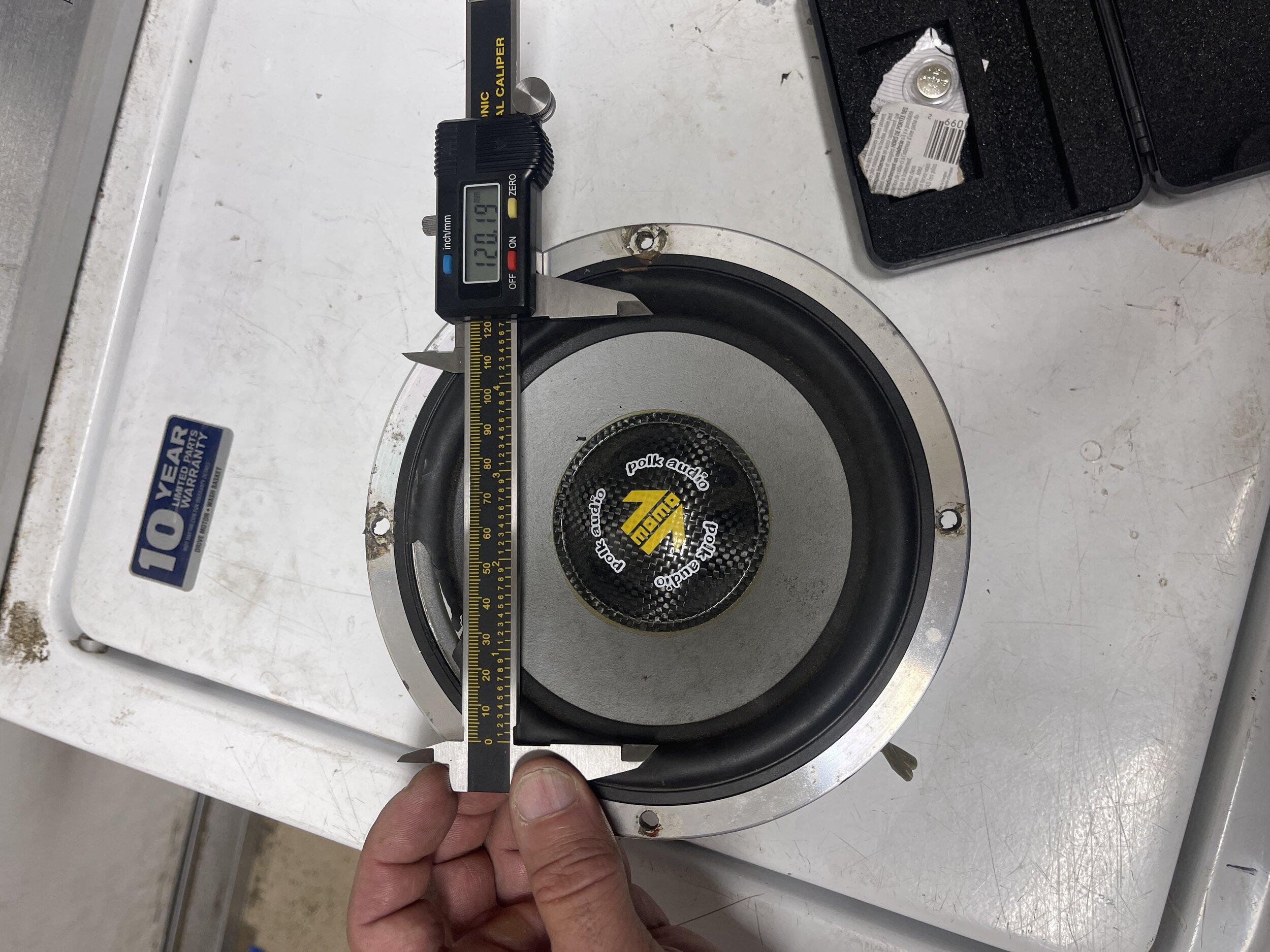

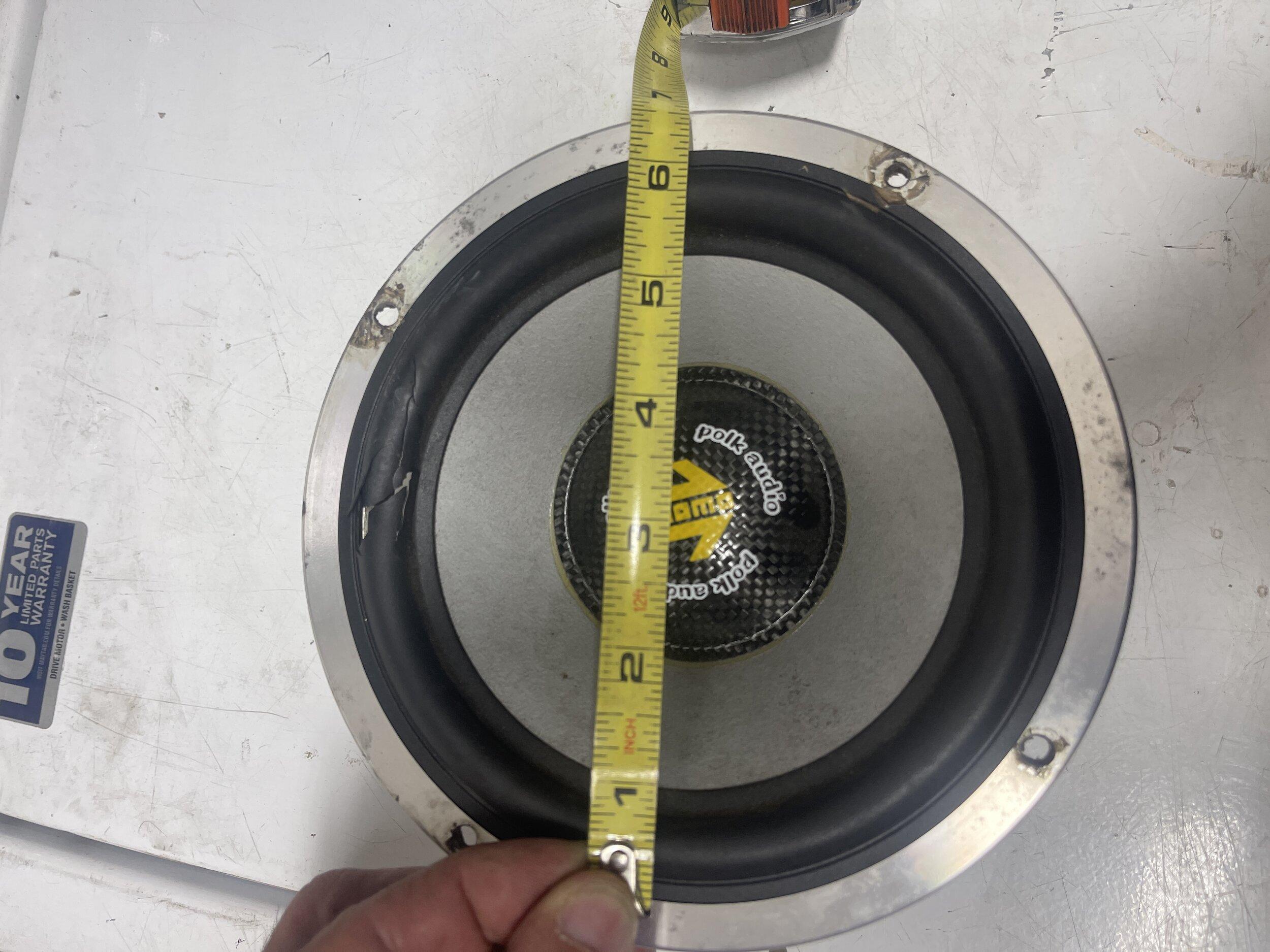

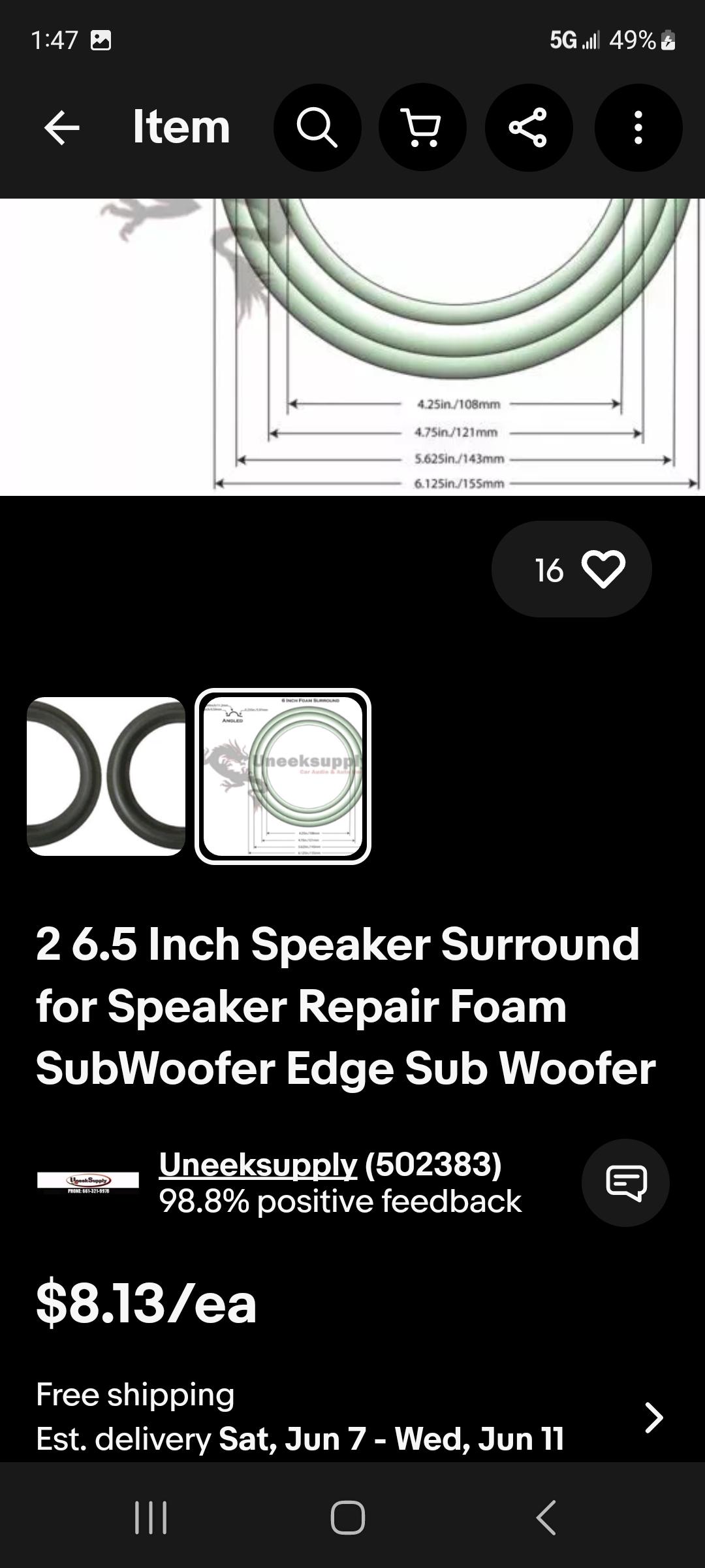

Did you measure the cone's outer diameter? I think the 3/4 only applies to the frame and not a bigger cone. If the cone is slightly bigger you should still be able to fit the 6.5 inch surround on it.
Also measure the landing area's diameter.

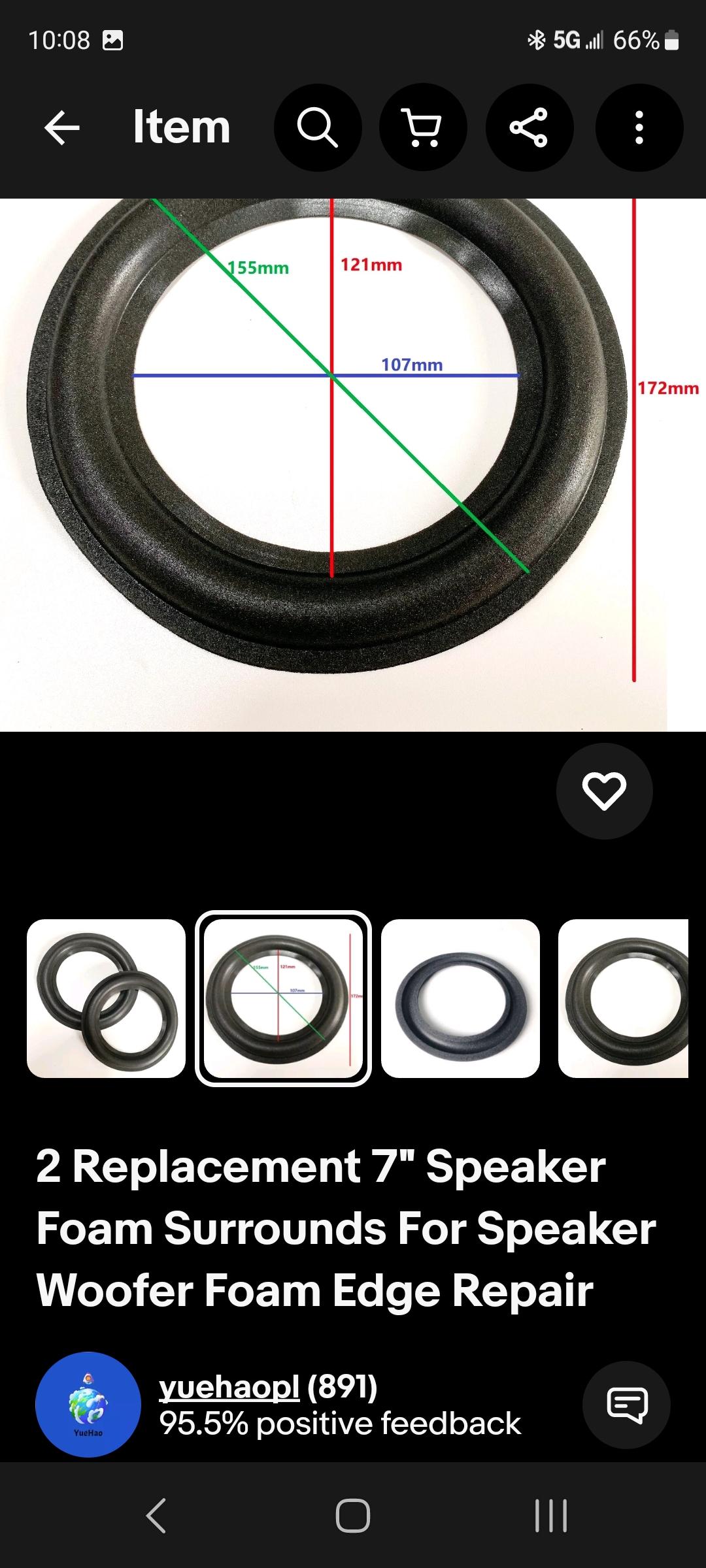

You can also try a 7" surround.
This one is for a 6.5 but the dimensions are perfect for yours.

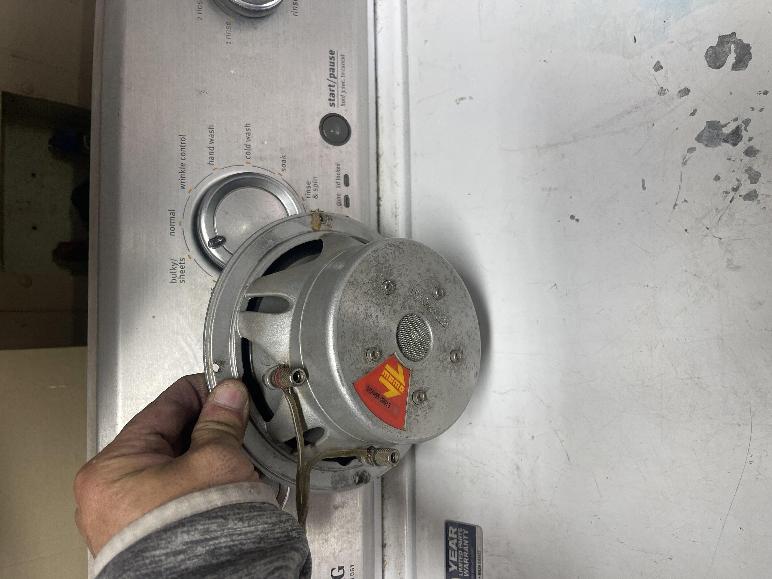

What's the condition of the tweeter and x-over?
tweeters play fine...
Dont see any issues with the x-overs...

Might be worth picking up those cheap surrounds & see how they fit.
Seems like a super easy job unless im missing something, seems like the surrounds will easily peel right off the cone from me trying at the torn edge.
Will have to slice the surrounds off the frame area as its super thing & appears to be super secure...
