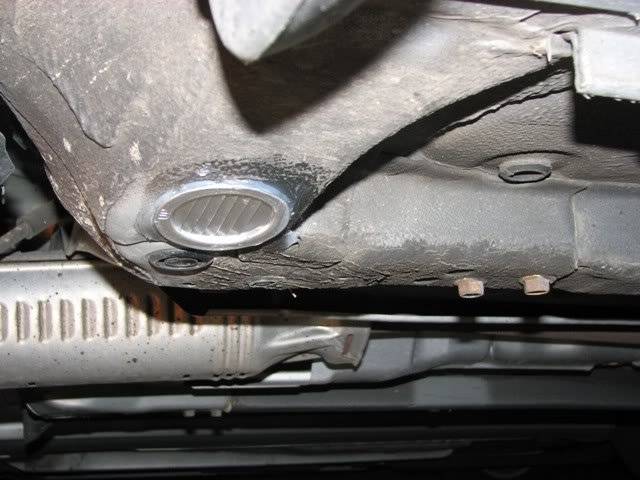

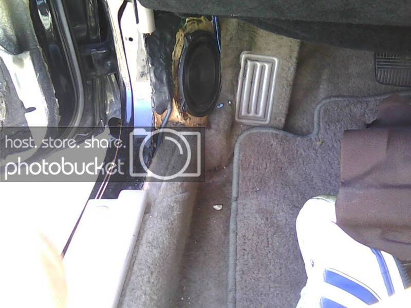

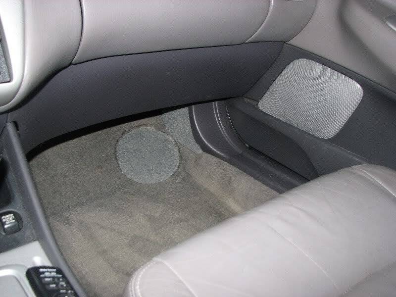

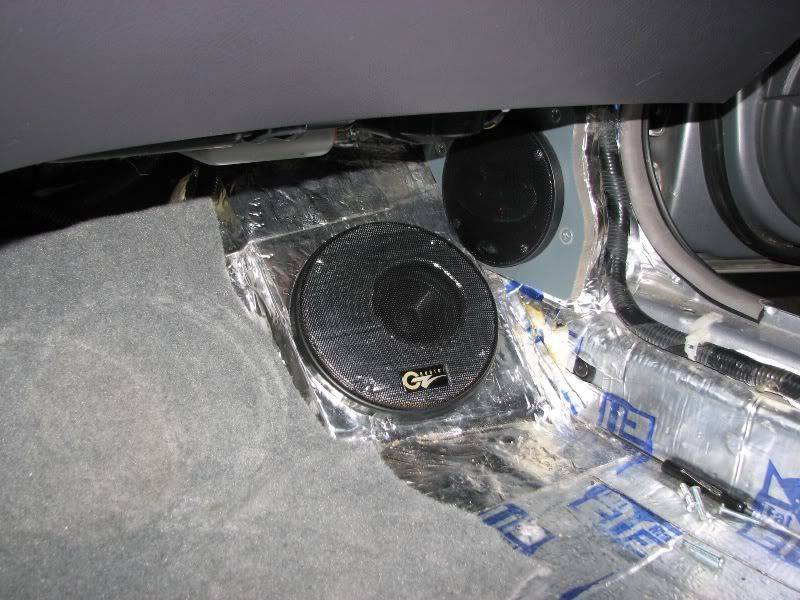

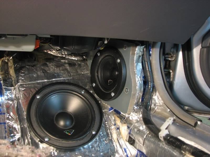

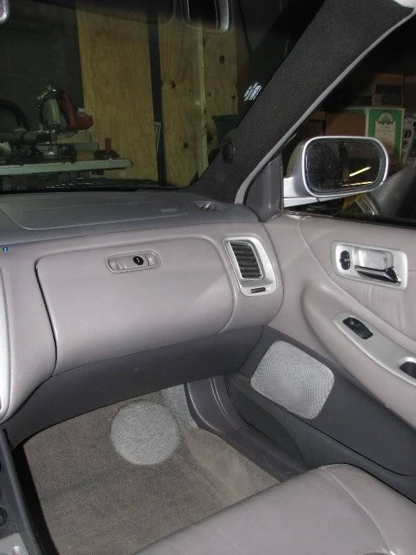

my kicks resulted in zero loss of foot well space. i had a vented floor cavity for the midbass, and the midrange used the frame cavity.

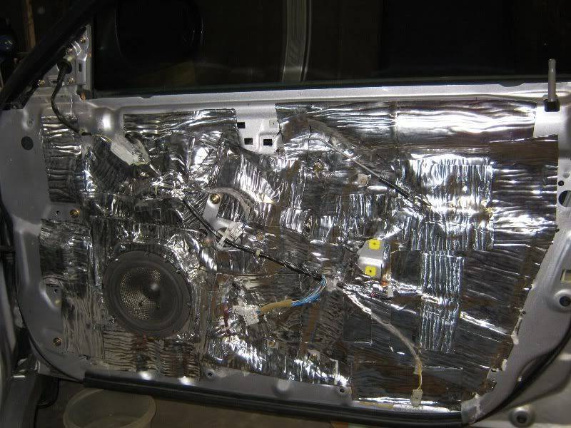

i've recently stopped running the side mids and moved the 4" mid to where the 6.5" is, and moved to a 6.5" in the door.

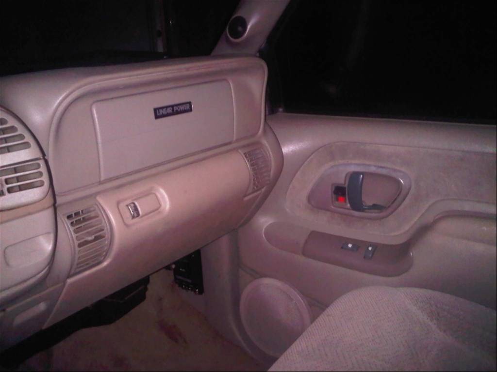

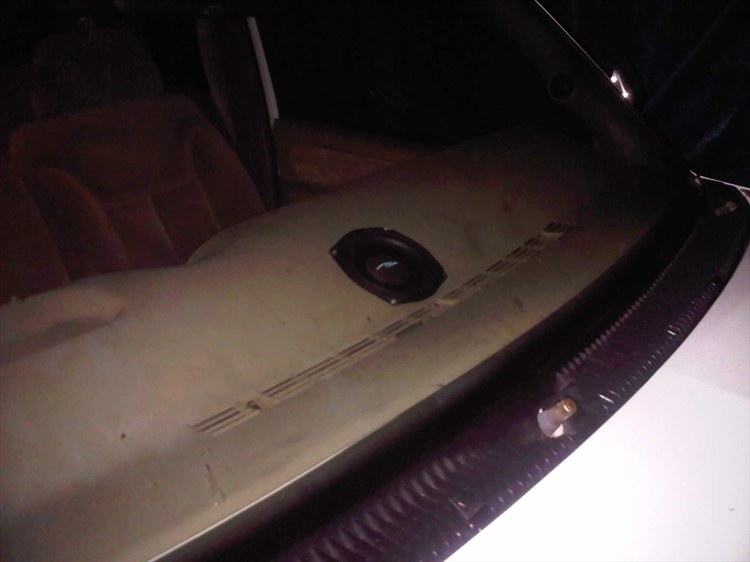

i built custom pods on the dash for my midds and tweets works well

Im not reading everything...but its probably been mentioned the Kicks are your best location because that is the best place in a vehicle to acheive close to equal sound wave paths....other locations will work using time alignment to shorten or increase the sound wave....time alignment is also a plus even using the kicks ...the object is to get both sides arriving to your hearing at the same time ....also positioning speakers so they aim at ypu is a plus...I use laser alignment on mine....
