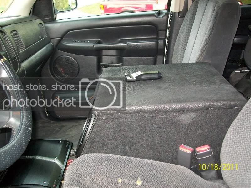

I pulled my midbass driver out of the kick pannels and went into the doors for several reasons ...
more air space without shooting a hole through the outside of the vehicle ... I have a work truck, venting through the bottom would let water in while at work ...
better left and right separation ... made things more distinct and accurate ... and better aiming matched the tweeters ...
Drivers basically came "alive" in the doors ...
putting the 5.25 in the center channel (at a VERY low level) just seemed to bring everything together and enhance stage and image ...
the tweeters in the rear was installed to enhace the stage and image also ... creating more width to the listeners (2 seat judging) ...
all of this done WITHOUT time alignment and processing ... and basically flat EQ ...

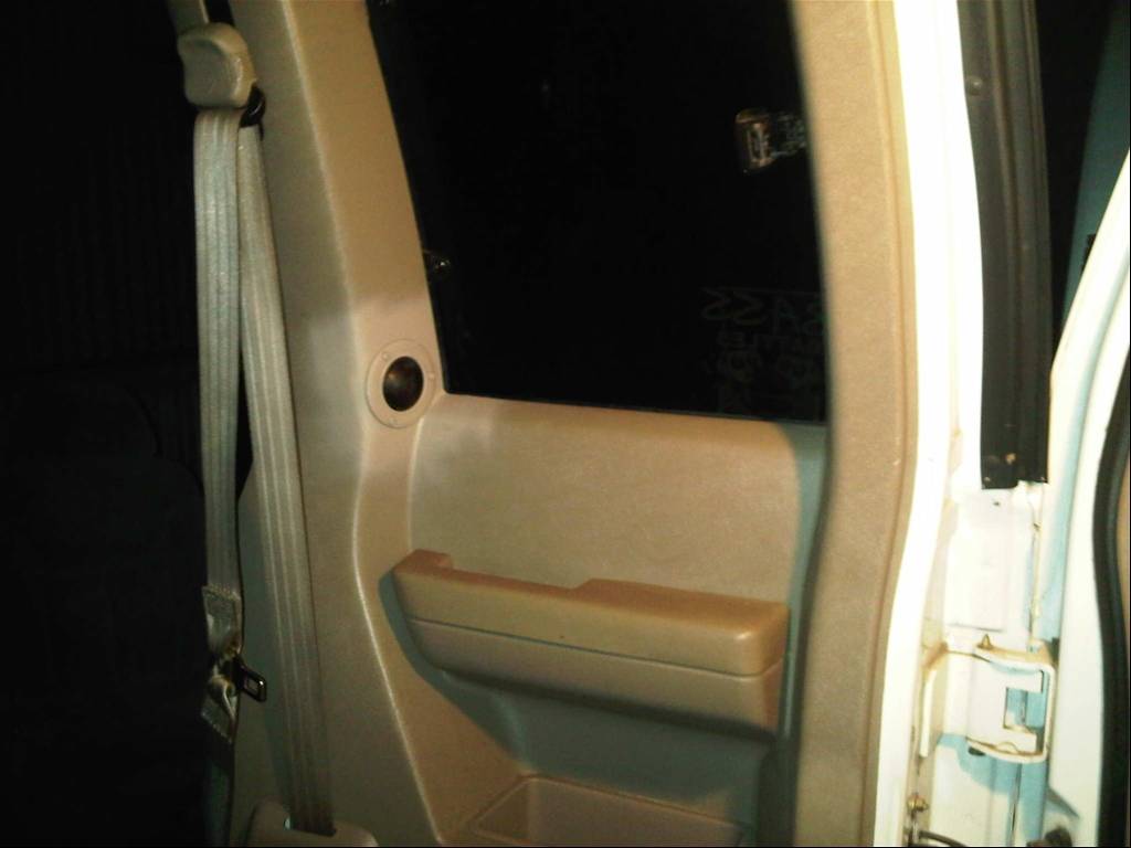

How are your rear tweeters aimed?
He was asking about rear tweeters. //content.invisioncic.com/y282845/emoticons/smile.gif.1ebc41e1811405b213edfc4622c41e27.gif but maybe he doesn't want to show his imaging secret.
since this truck has a cut up kick from the previous Blues woofer, but now you are using the door - does this allow you to compete outside of MOD-EX? even though you cut metal, if you aren't using it, do you still have to compete in that category?
Oh ... Sorry about that guys ...
They are behind the driver and passenger / in front of the rear seat listeners on the b-pillars ...
