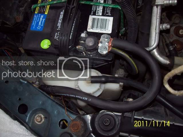

1/0 from Battery to Chassis

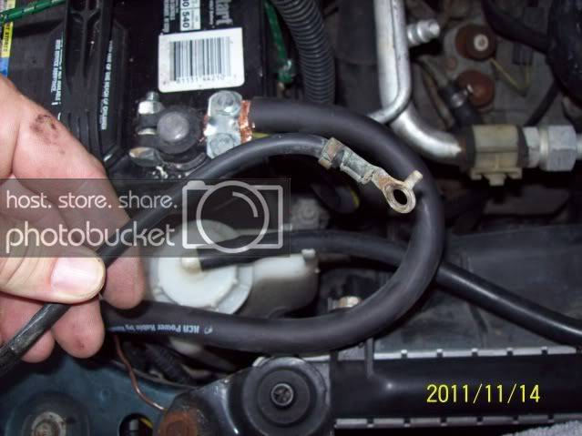

here is what the factory ground looked like

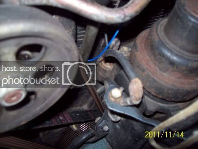

replaced the motor to chassis with 1/0 as well
sanding down the mounting spot
didnt take a pic of where I mounted it to the motor but it was a good spot
I left the factory 8 gauge motor to chassis wire

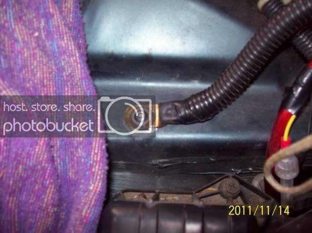

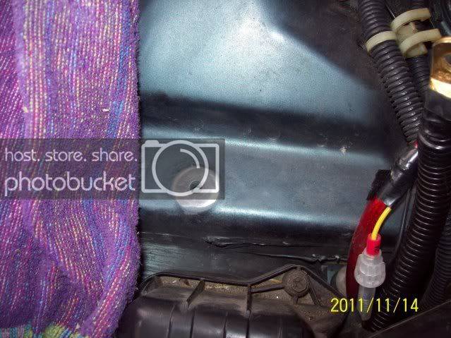

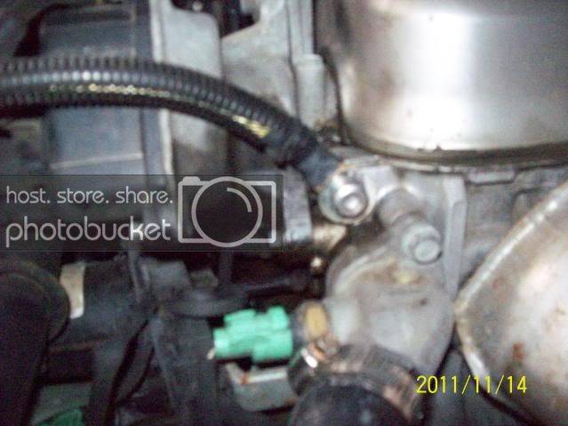

Here is the 1/0 wire connecting the motor
here is the other side of that wire connecting the motor to the frame

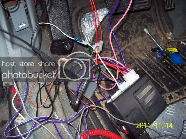

Anyway I successfully installed the Auto Start System. It took 2.5 hours from start to finish. It works very well. The range is really good and is super easy to use. My girlfriend works at 7 am a few days a week and has to leave at 6 am to get there. So normally in the winter I get up and go out and start the car for her, this will be much easier.

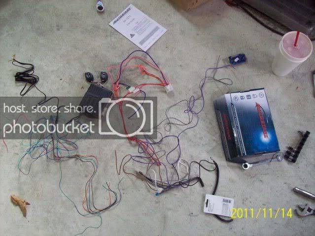

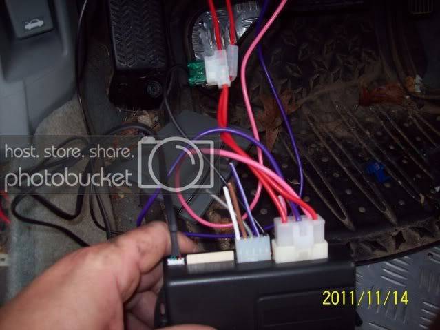

Here is what I started with
here is it mostly installed
after I cleaned up everything that I did not need (since I have an aftermarket alarm already a lot of the security features were not needed) there really were not that many wires I had to connect.

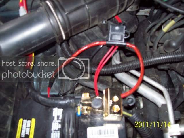

I am not sure why but the Autostart system had 2 power wires that needed power and each one had a 30 amp fuse in it. Instead of connecting it to the factory wires under the dash (which I think would have been fine) I ran 2 - 16 gauge wires through the firewall to the battery, there I used an 8 gauge fuse (thingy) and connected it to the positive terminal.

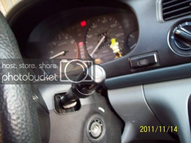

finally here you can see that the keys are out of the ignation but the car is running (tach is at 1,000 rpms)
