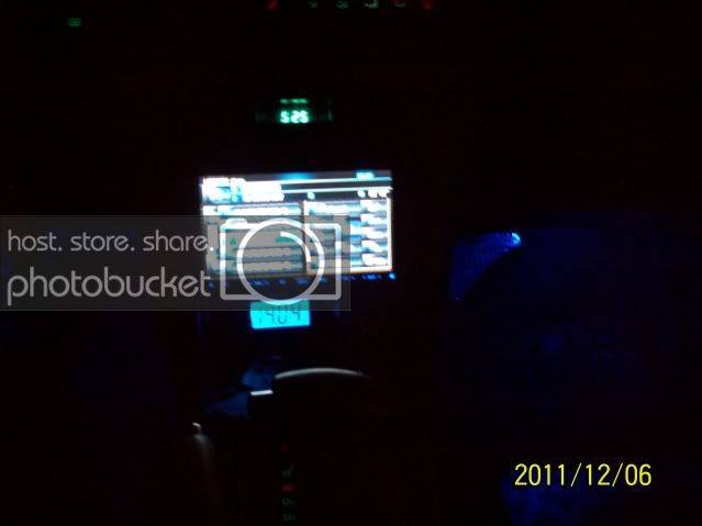

I got my cheap ebay voltmeter hooked up
I am very happy with it. I grounded it under the dash and ran a wire to the relay I have in the back that gets its power right from the Dist block supplying the amps. I did some trimming and mounted it nice and flush.
The Voltmeter matches the color of the LEDs I have in the footwells pretty well.
yes I am at 14.0 volts that is with the stock alt. I tried to install the HO alt that I have but I didn't know that the pulley was going to be smaller than the stock alt so the stock belt is too long. I will get a shorter belt this week and get the new Alt installed.
