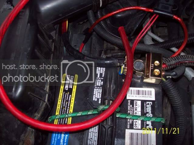

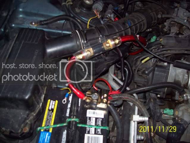

I finished up the 'Big 3' by running a 4 gauge from the Alt to the battery Positive. It looks close to the exhaust shield in this pic but it is actually a few inches above it. I zipped it to the A/C line so it will not move or touch anything.
I used some old split loom I had laying in the yard (literally) where the wire ran next to the metal line. I am going to order some TechFlex soon and do it the right way.

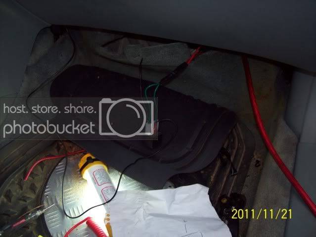

I ran another 4 gauge to the rear (making a total of 2 runs)

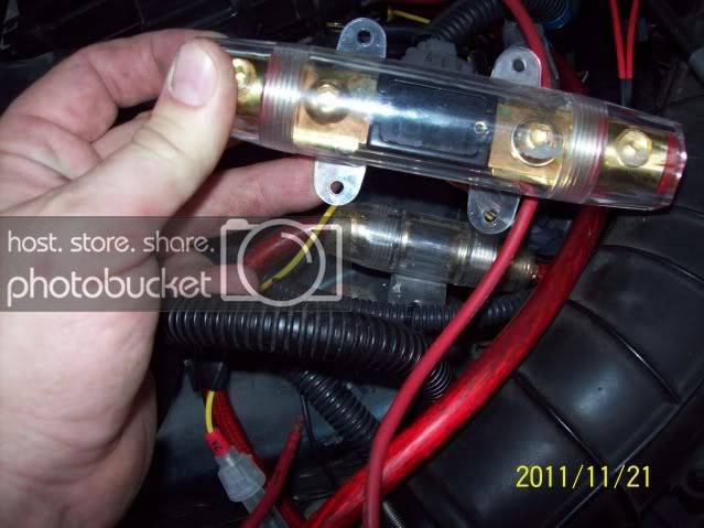

While digging around today I found this new never used 1/0 fuse holder that also has some reducer rings. Instead of using 2 - 4 gauge fuse holders I am going to just used this one. It has a 200 Amp fuse in it.
I ran this relay also it is triggered from the remote start. It has an 8 gauge wire ran to the battery for power. It works perfectly. Now when the car is remote started the car starts and the heater fan blows but the radio and running lights and everything else stays off, exactly how I wanted it.

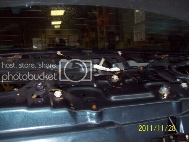

I took out the rear seat and rear deck. Not one clip came out with the rear deck.

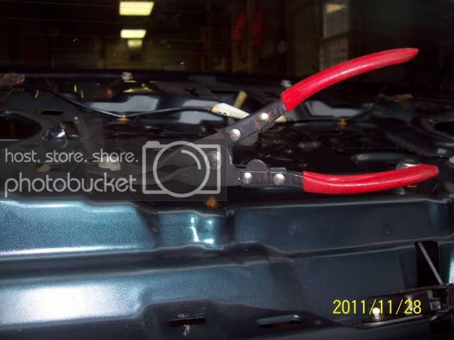

If you do not have one of these Clip pullers you should get one.
It pops out the clips super easy and fast. Works much better than the flat head / plyers method
Tomorrow I am going to put Fat Mat on the top of the rear deck.
I am going to use my heat gun to warm things up to help with it sticking in this colder weather.

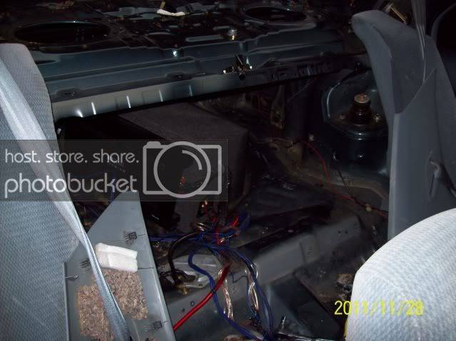

here what the support on the left side looked like
and with them removed - look at all that room!!!

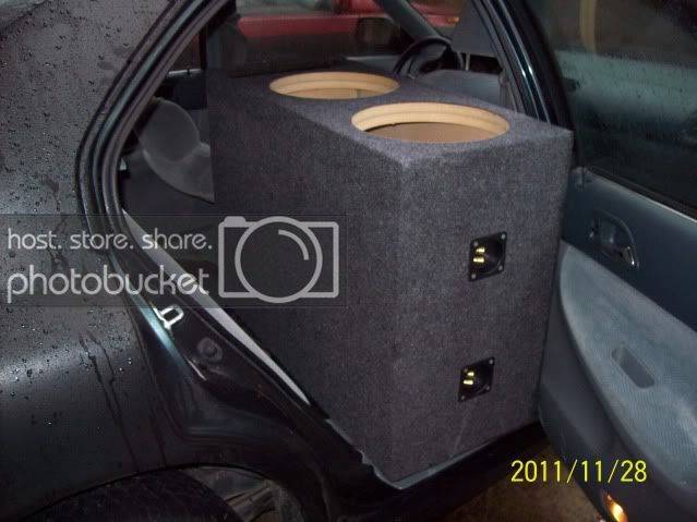

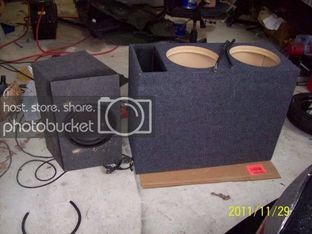

now with that big space open I can slide this little tiny box into the trunk
looks a little wet out that way haha.
We get some flooding here.

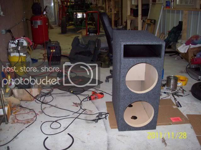

Old vs new
Test fitting

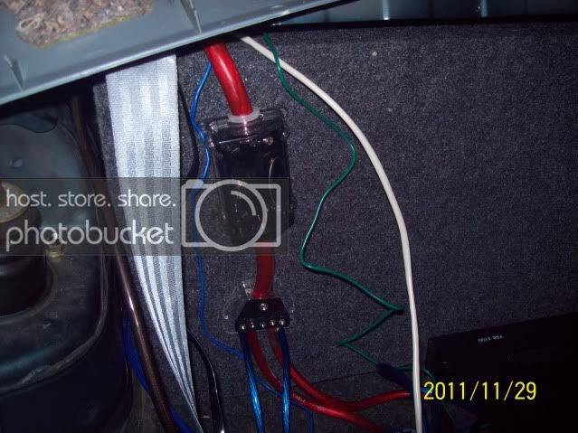

Ran both 4 gauge wires into a 1/0 gauge fuse Holder
Also FYI - I bought some cadence 4 gauge from someone on this board - it is the size of some 8 gauge that I have, def not real 4 gauge at all.

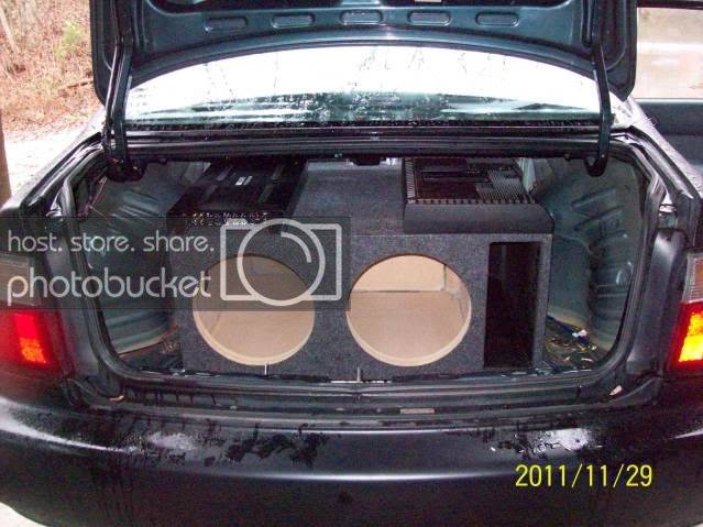

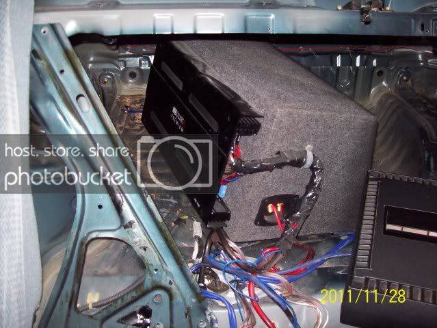

Here is how it sits now.

Impressions - wow!

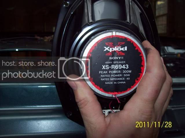

I bridged the Mb Quart amp so I am running much more power to the front stage.
Also I think I had some polarity issuse with the rear speakers that I had (but are now removed)
I never understood why my front stage (German made Q series MB Quart components in fully deadened doors)
It never sounded that good, kinda muddy.
I think 1 or more of the rear drivers were out of phase because now the front is so clear and warm.
It sounds like I remember the speakers sounding. So much better than before.
Also those speakers love some power and now they are getting it.
As far as the bass - wow, really really good. Very low. Drops much lower than my last few systems.
