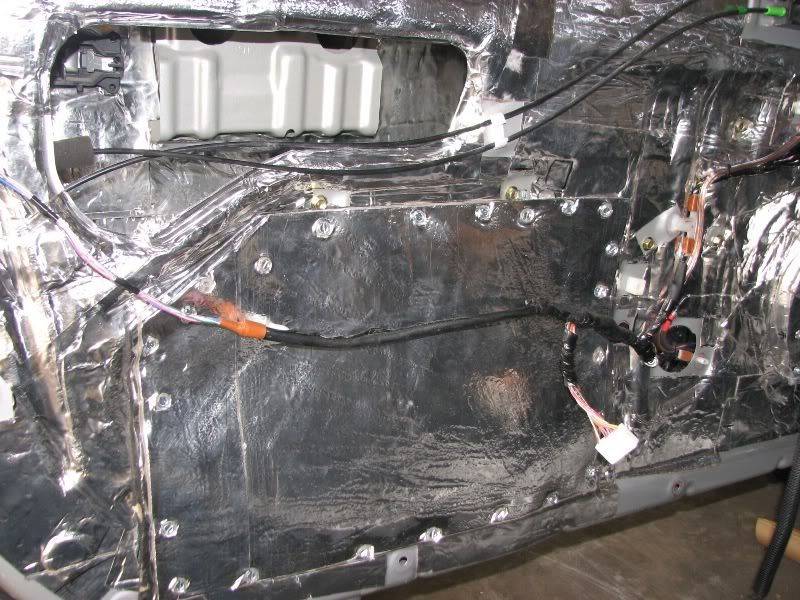

to the subject of why you need to cut out the back of the XTC foam baffles - the last thing we want is a flimsy, tiny membrane behind a speaker. consider the airspace and the resulting Q of the enclosure, then consider how flimsy the enclosure is, moving in reaction to the pressure and causing cancellation. I don't waste my time with those baffles. what we need is water control around the speaker opening, i achieve that with CCF weatherstripping and deadener to create a watershed pathway around the opening:
to the subject of the thread - making doors behave like speaker enclosures. we look for a few items that don't exist in the car already - rigidity, sound absorption, rear wave control, and rear wave isolation. I have successfully implemented these concepts.

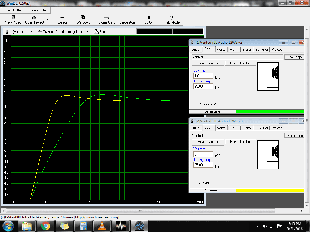

This just shows you are an ignorant noob with zero experience in audio trying to talk sh*t. Anyone with any kind of basic setup either home theatre or car audio has tried a big driver in a small box and found that there's zero bass reproduction while inside a bigger box, there is much more bass reproduction.
You can also see from a simple enclosure modeling software that based on a driver's T/S Parameters, that low end reproduction is much higher in a bigger airspace vs a smaller airspace.
For Ex: This 12 inch sub in a 1 cubic feet box vs a 3 cubic feet box, same port tuning but drastically different frequency response. Its the same thing as shoving a 6x9 in whats basically a 0.1 cubic feet sealed enclosure vs the whole door cavity which is about a cubic feet or more of airspace. Makes the difference from your speaker sounding like the tin man vs a full bodied driver capable of playing every drum kick that you can feel in your chest.

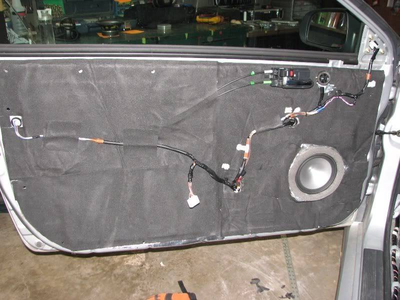

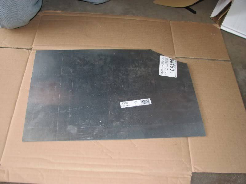

I'm gonna foam tape sheets of formable aluminum sheets over the holes on the door making the whole inner door more like a speaker cabinet. I think this should work better than not doing it. And of course B-Quiet all over the place!
