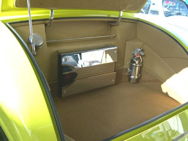

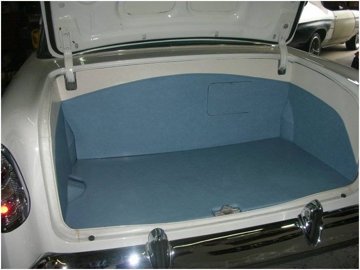

My goal is to hide the equipment in the trunk for a clean look. here are a few examples of similar ideas
The Model A trunks look a lot easier to work with because they are boxy
