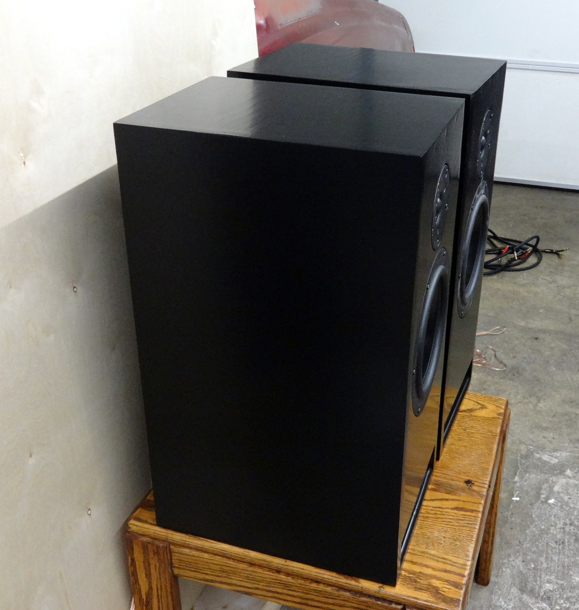

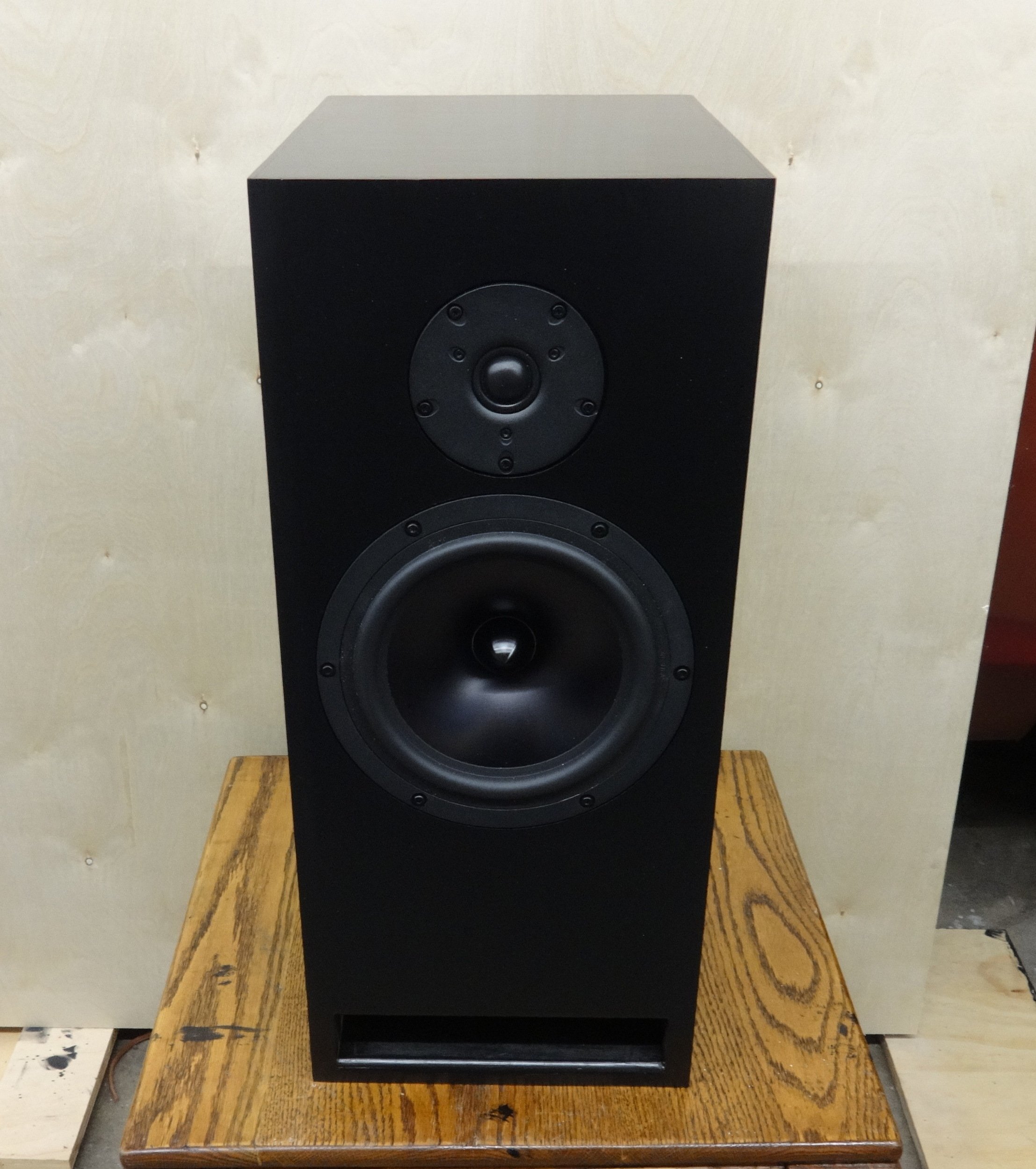

I got the paper RS225's with some peerless tweets that can play down 1400hz with ease in some 2 way active garage speakers i built and I'm pretty impressed.
When I built them I had the aluminum cones but those are in my doors now figured they might hold up better in a car.
Here's the garage speaks (my chitty phone doesn't do good pics)
