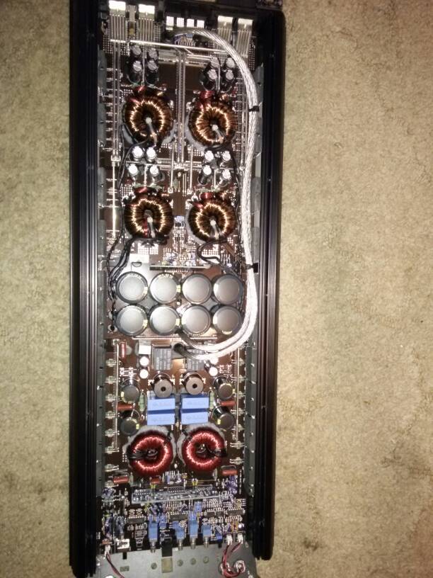

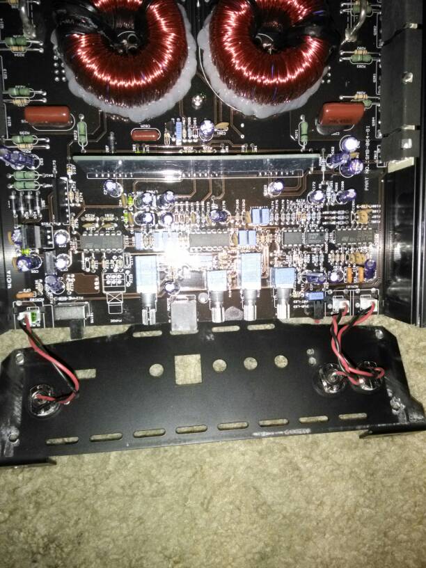

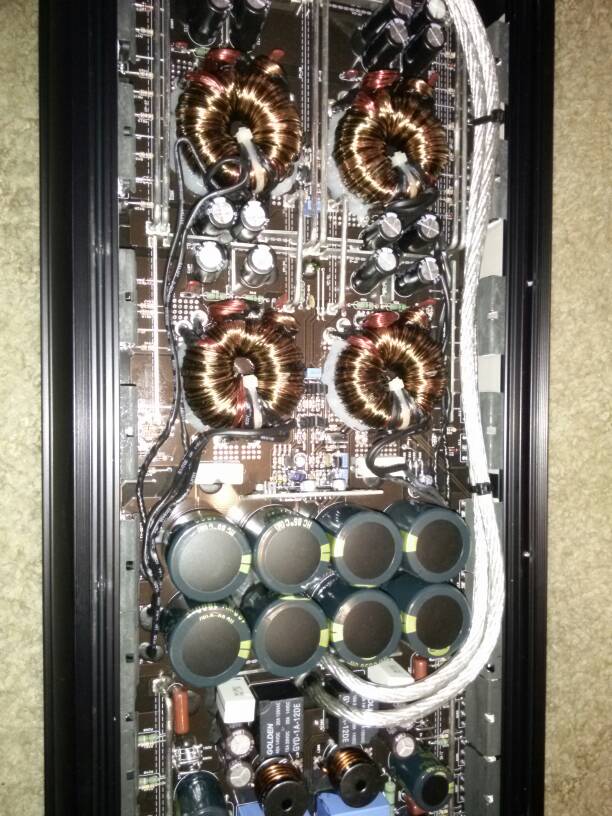

Solder joint on the gain knob went bad.. [emoji22]
All else still is good. Spoke to zack and ima send it for rma.
I may just sell it after its fixed.

Amp has shipped out, fedex will be picking it up at 5pm latest so they should have a total cost or idea of whats gonna happen by saturday or monday.

Believe it or not the ppi 4 channel has been mounted right next to it this whole time and it has had no issue not even screws backing out...
I can imagine sub amps are more prone to issues due to the weight they come in, but this thing has done it since day 2 when i didnt even have the gain up much.

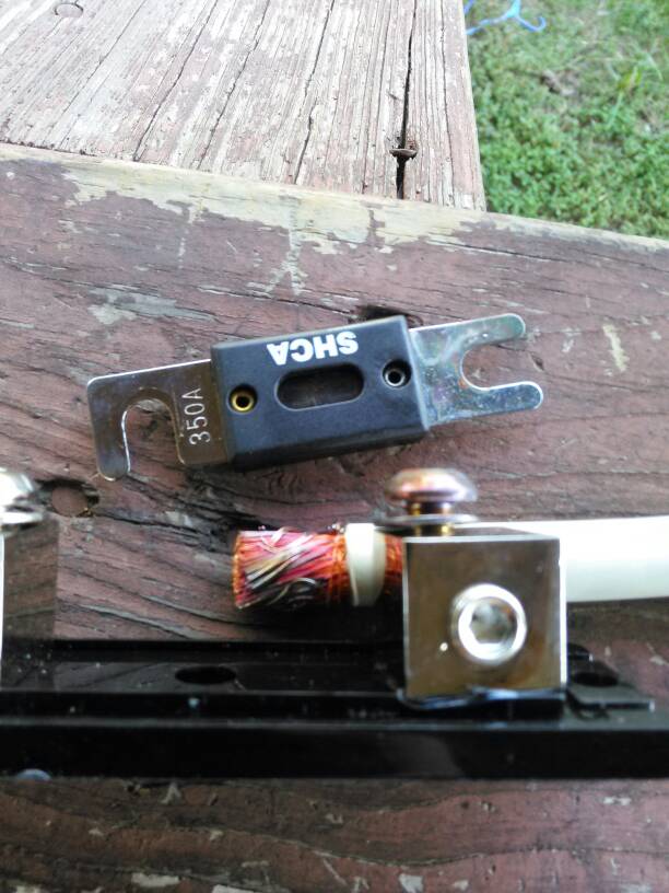

thats nothing... you've never seen a fuse block actually melted lol
still thats bad for your wire you should use a smaller fuse and larger block considering it got hot enough before blowing to melt the plastic

I have 4 more sky high 350 amp fuses and holders which costed near dammm 70-80$ total and its the first time ive had a fuse burn and holder melt.
I need to add more runs.

I had that same thing happen with those fuse holders thats why I switched and have never had another problem.
The wire is rated 350 amp/600v below 12ft and less.
So the wire could handle the heat, but the metal in the holder got hot enough to mark the copper.
The plastic.... Well its plastic.
The fuse was still working, but my voltage was jumping from 12.5-14.2 at times.

smaller fuse and larger fuse block
the fuse obviously didn't blow in time.

True on the plastic! You need nylon bases melting point is alot higher, I think its over 300 degrees vs around 200 or less on plastic.
