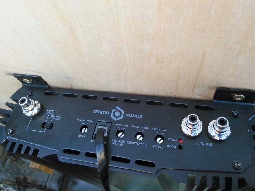

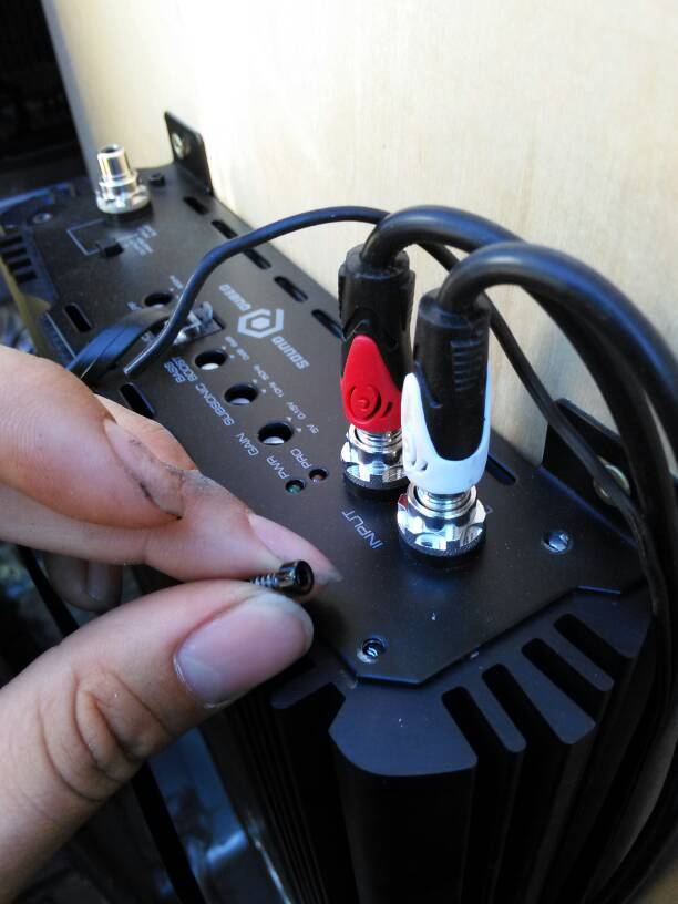

Anyone had an issue like this //content.invisioncic.com/y282845/emoticons/frown.gif.a3531fa0534503350665a1e957861287.gif f4ckin little bolts came out of amp during the time of me banging
Sent from my draconis using Tapatalk
Yup I take out every screw and put glue on the threads and screw them back in one at a time.
Another guy made a thread alittle bit ago cuz his amp did same thing.
http://www.caraudioclassifieds.org/forum/general-car-audio-discussion-questions/192890-anyone-ever-had-screws-back-out-end-plate-amp.html
My amp cut out and i know it wasnt because of low voltage or clipping as my clip light has never turned on.
Thats how i even thought of looking at the amp and noticing the screws. //content.invisioncic.com/y282845/emoticons/frown.gif.a3531fa0534503350665a1e957861287.gif amps dont like slo mo..

Sooo........ In my luck.....
Back screws backed out and caused the amp to do something. Next song came up and all the subs flexed like they trying to swoll out..
I stopped and i turned the gain knob and every turn i do makes the subs go thump.
Keeping the volume low the subs play fine, but when i go to higher volume it goes flex beast mode and the box ***** in deep and out hard [emoji23] ..
This amp is halfway dead thanks to soundqubed's screw job.
Other side of amp has had no issues with screws.
Time to see if warranty is available.
Also notice the power led is gone....
I had found the screws on the floor and put them back in.
That's your own fault though. Should have glued the screws in so they wouldn't back out the first time it happened. This is the second time so it's on you. That svcks though. U need to make your box stiffer as there is to much vibration Forsure
Nope its not my fault till i actually throw it on the ground..
Screws on the other side never came out so why would this side come out?
From mounting on a single layer 4 18" wall.. Vibration caused it
Nope double baffle on amp side plus another wood same size as amp making 3rd baffle..
The side had little to no vibration.
