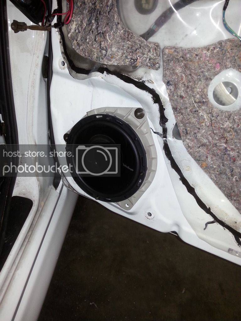

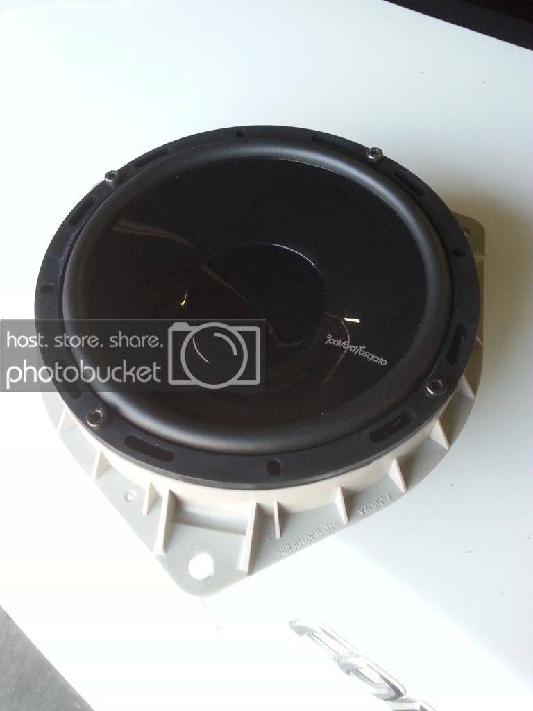

I started off with a set of these Fosgates that I had previously purchased, but never ended up installing in my old truck.
"][/url]
Used the factory mounting brackets to make life a little easier on me.

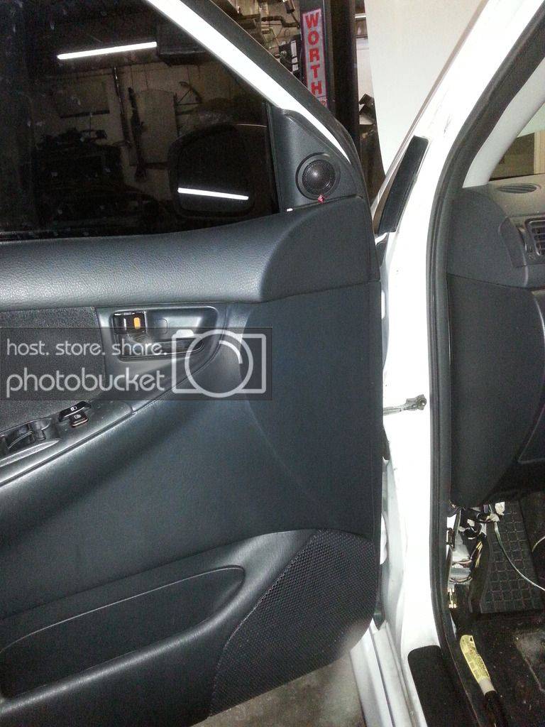

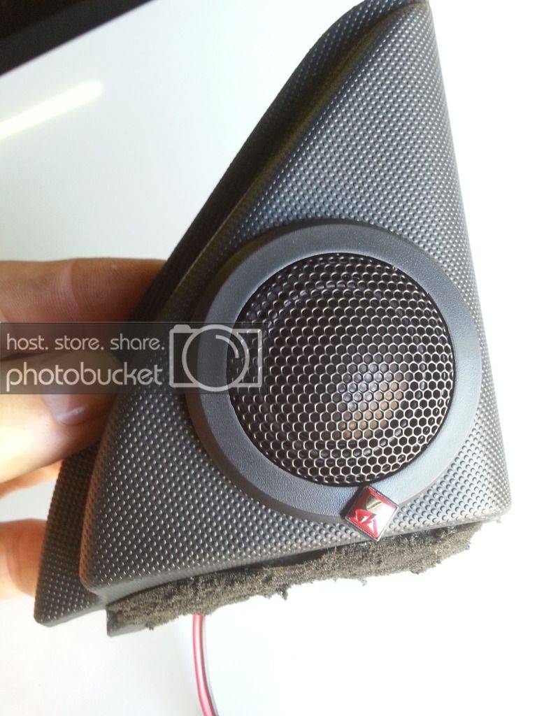

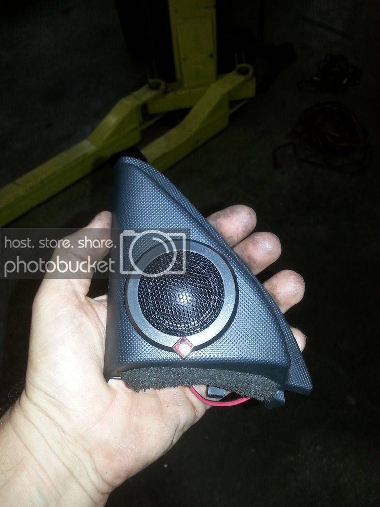

Figured this would be a decent place to mount the tweeters.
"][/url]
"][/url]

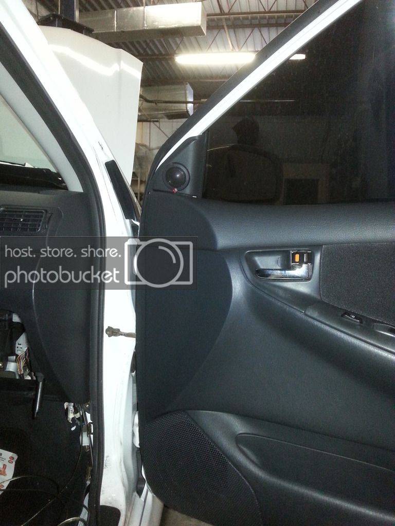

Passenger side completed as well.
"][/url]
"][/url]

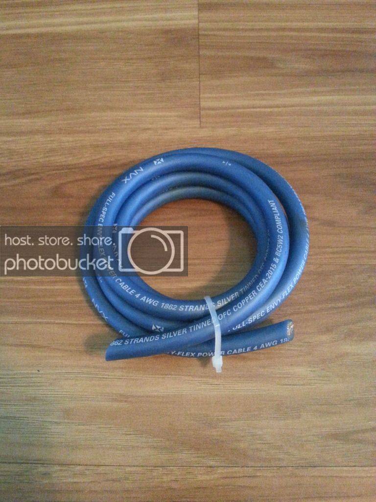

5 feet of 4 gauge power and ground cable for the sub amp.
"][/url]
"][/url]

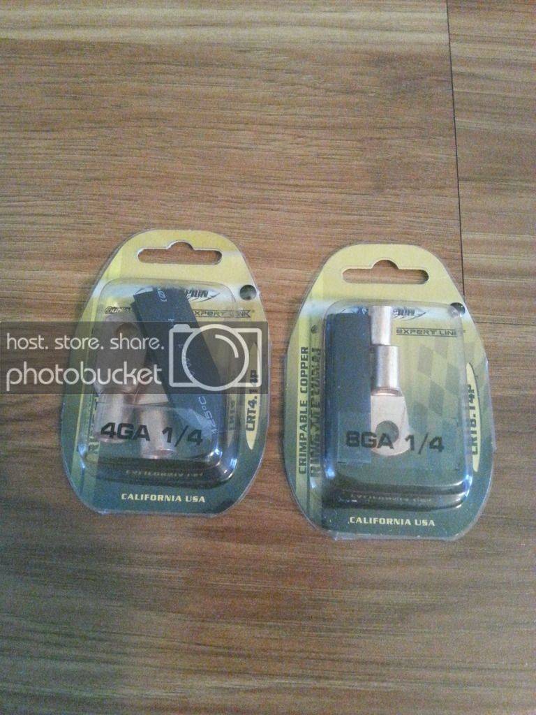

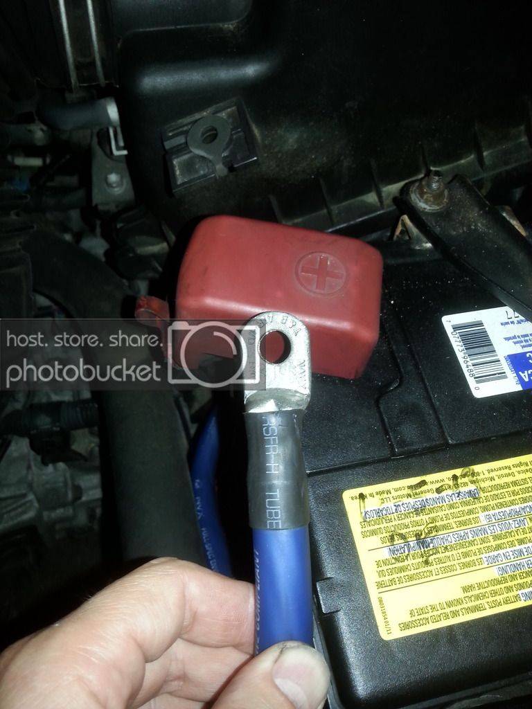

Battery end crimped and heat shrink installed.

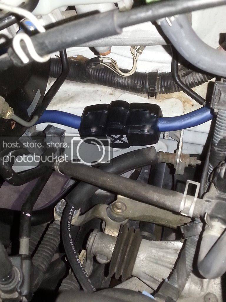

Fuse holder installed in the engine compartment near the battery.

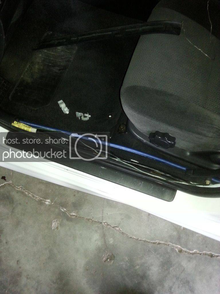

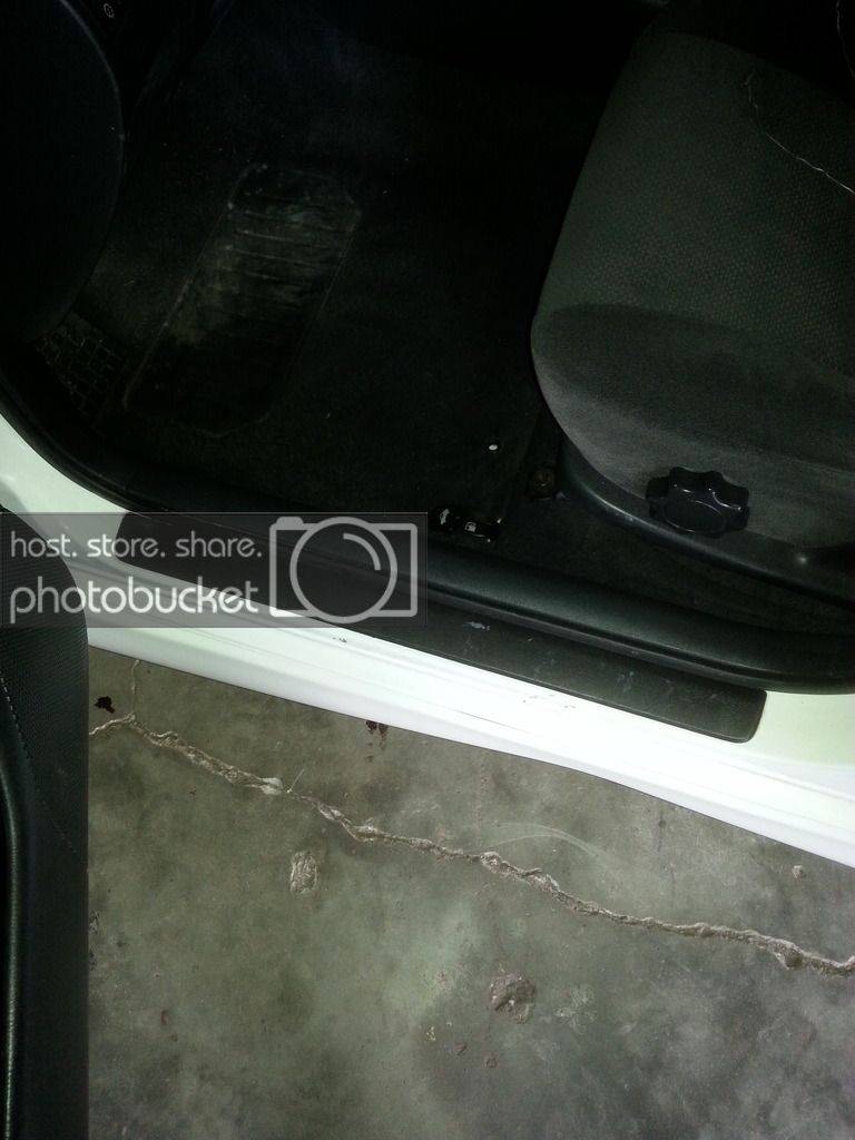

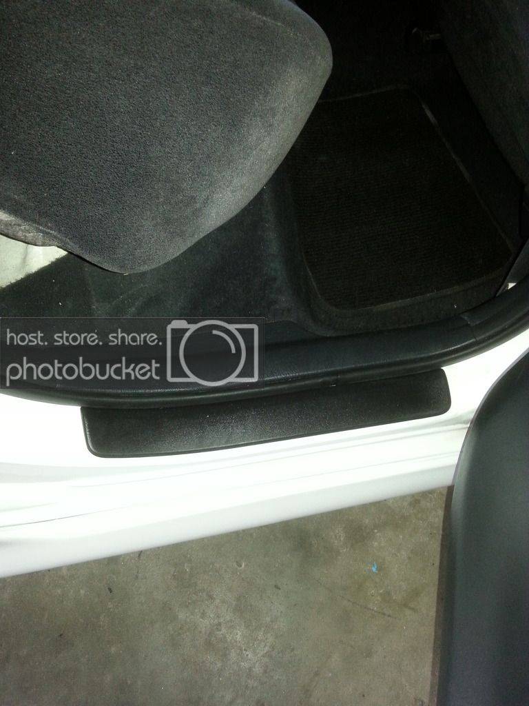

Power cable run down the rocker panel.
"][/url]
It was a tight squeeze, but I got the trim panel back on.
"][/url]

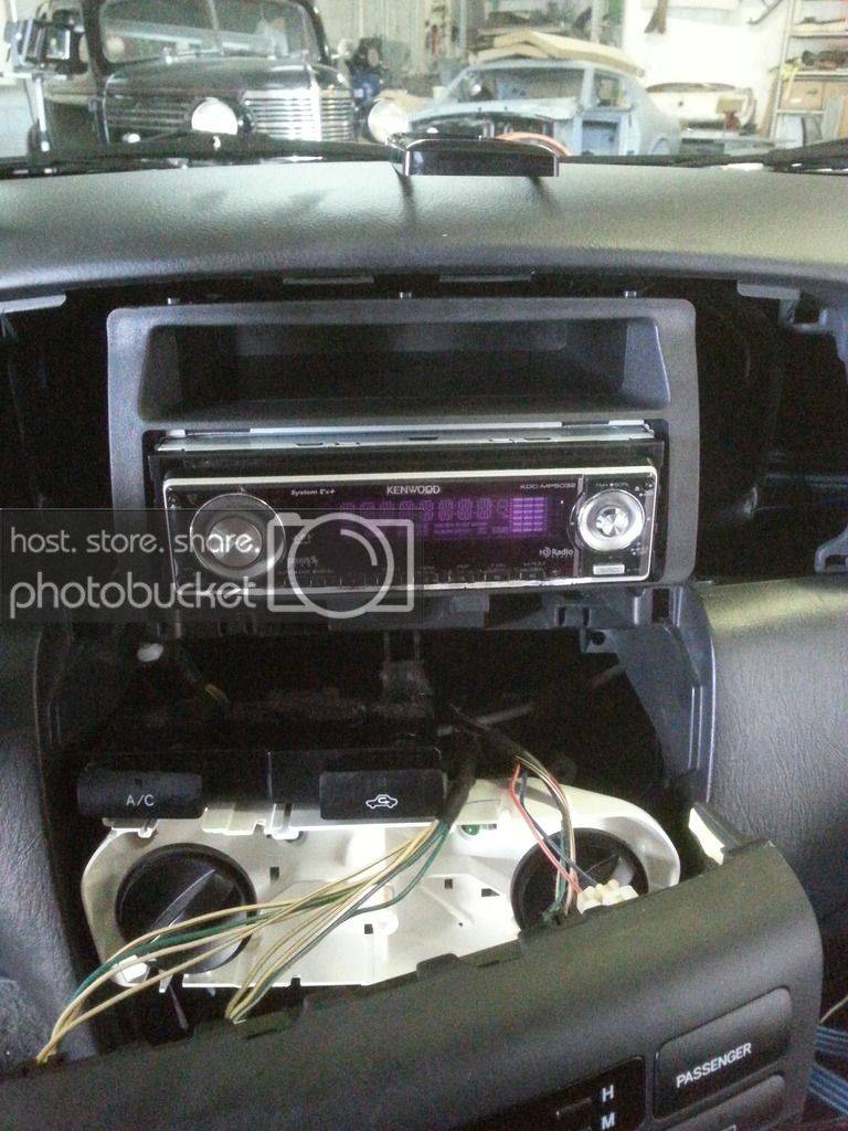

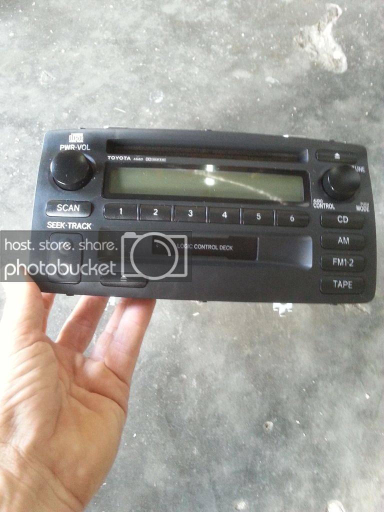

Had some time on Sunday so I put a few hours in.
Out with the old.....
"][/url]
.....in with the "newer". LOL.
"][/url]

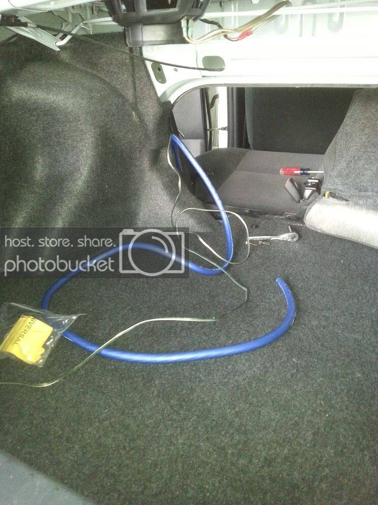

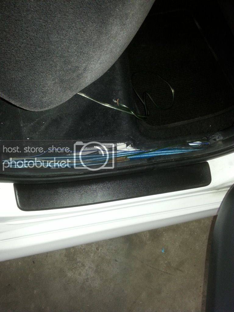

Ran the remote wire, RCA's and speaker wire under the passenger side rocker panel since the Power cable from the battery was run on the drivers side.
"][/url]
"][/url]

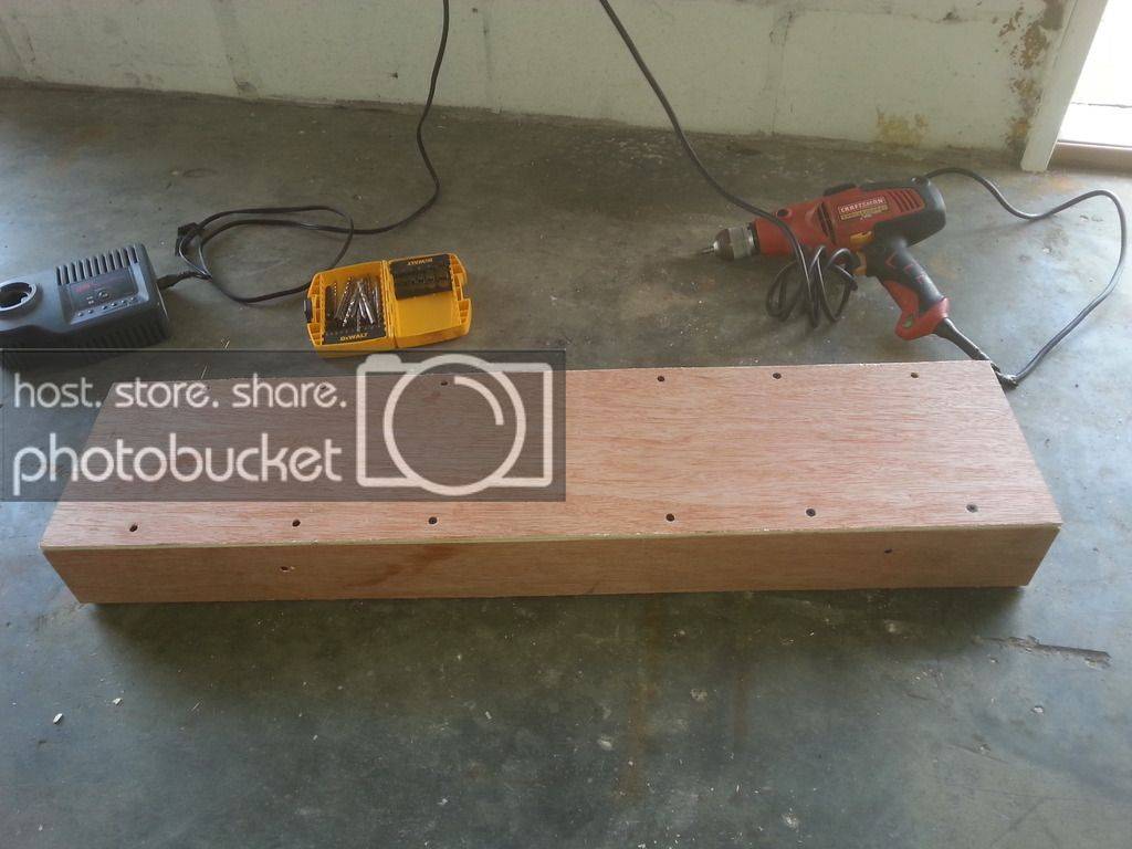

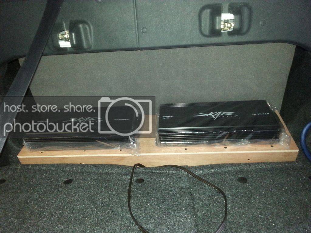

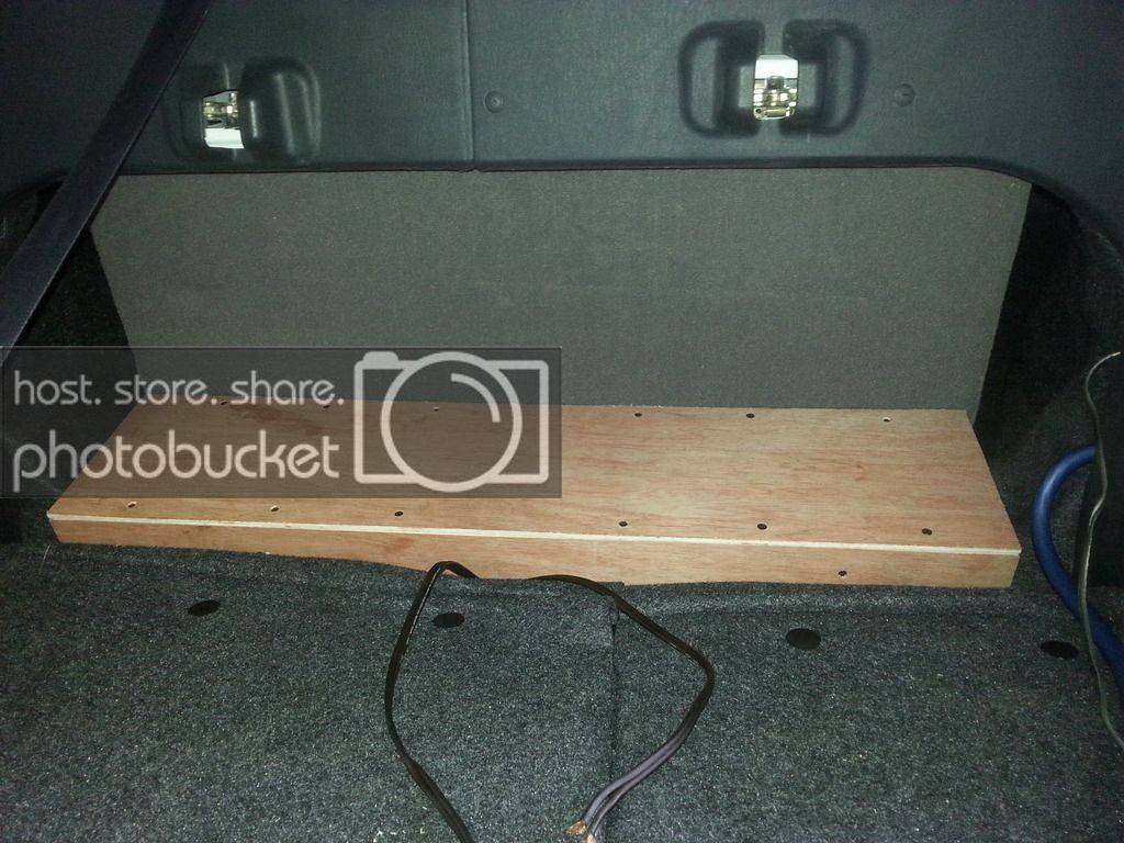

Built a temporary amp rack to use till I figure out how/where I want to permanently mount my amps when I build my new sub box.

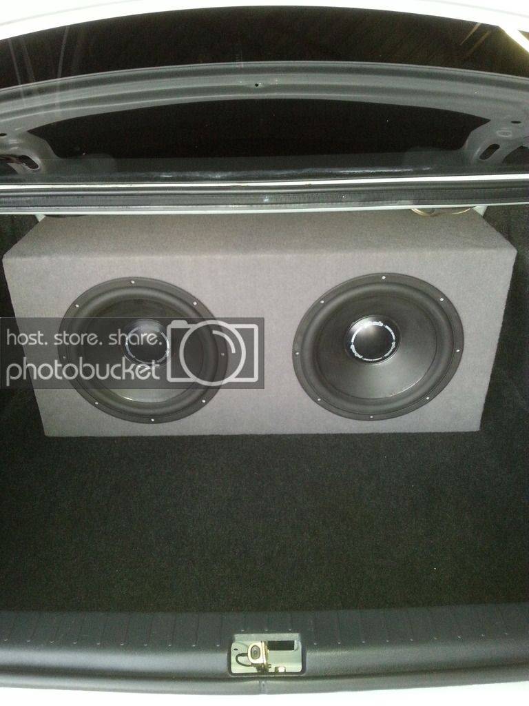

Pulled this out of my Saturn when I sold it and threw it in so at least I can have some sound until I built a different/better fitting box.
"][/url]
