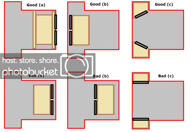

Yours fall into bad C territory. Should have had the subs as close to the lid as possible and face inwards. The way you have it, the bass waves are conflicting with each other and canceling each other out. This is called cancellation.

flip the polarity of one sub and see if you gain an output boost. You are most likely having a lot of cancellation due to sub orientation.

Try flipping the polarity on ONE sub, not both. Do you have the wire in parallel?

Yes they are wired in parallel, with the polarity swapped on ONE sub. they are 4ohm DVC wired to 4ohm at the amp.
