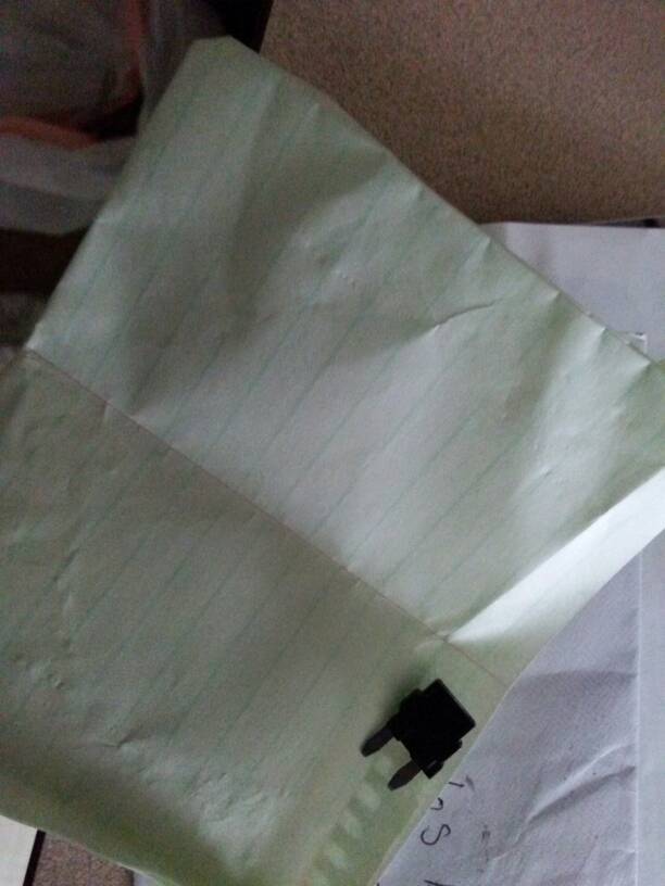

Thats cool I can see myself going that way one day when I get a new truck. I sent you that diode yesterday too.
Yeah, im not a big fan of tearing up new things.
And i appreciate it! Hopefully usps doesnt decide to shiit on me like always mixing up my address.
Ill be sure to let you know when i get it. Did you just put it inline of the excite wire?
Sent from my draconis using Tapatalk
I put it one of these https://www.superbrightleds.com/moreinfo/installation-supplies/waterproof-mini-automotive-fuse-holder/768/1741/?utm_source=googlebase&utm_medium=base&utm_content=WMFH&utm_campaign=GoogleBaseChild&gclid=CM206eq3r8gCFYc8aQodkk4EIg on the sense line on each of my two stereo alts I didn't do my stock alt for the truck.
Oh and I had to trim it down to get cover to snap down. you will see that electronics is below where you need to clip off so it dont hurt it any but you may want to mark direction on legs first but you can always check with dmm
I think i have one of those on my older amp kits laying around.. Thats a smart idea, that way its not taped to helll.
Ya I edited last post too
View attachment 26553649 How I did mine.
looks like this

My idea behind this type is because when it gets too cold out it may charge too high because I am charging around 15.2 in the mornings now that its cooling off but in the middle of winter it will be higher yet and its best not to charge over 15v so we can just pop out the diode and stick in a fuse and its back to charging at the lower rate.
Hey, thanks for the little diode!
I plan to get it in tomorrow.
