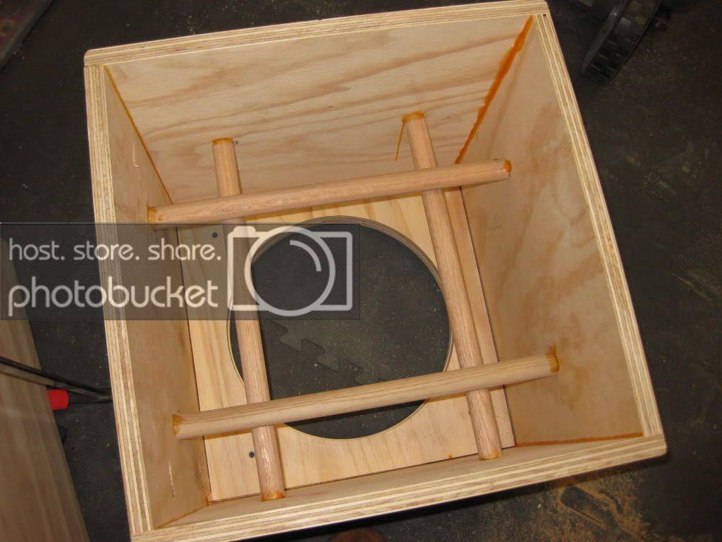

Here it is, 12.5 cubes net volume, tuned to 33hz, 160in^2 port. Use 1.25" wooden dowels or 5/8" threaded rod from side/side, top/bottom, and front/back for bracing.
Cuts:
Top/bottom: 41"x36"
Front/back: 41"x19.5"
Sides: 34.5"x19.5"
Port top piece: 20"x21.5"
Port side pieces: 20"x8"
ah sweet man thanks but what do you mean by Use 1.25" wooden dowels or 5/8" threaded rod from side/side, top/bottom, and front/back for bracing.
and this is with 3/4" mdf board right? all the displacements calculated in?
ok yeah those wooden dowels wont be moving much? should i wood glue them and screw em or just woodglue? and i heard something about seperating the chambers so the two subwoofers dont interfere with eachother while playing? should i seperate the chambers?
