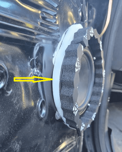

It's really important to get the same up front as you have in the back. You might find that all you need is a 12mm to 18mm riser made from HDPE.
Very easy to cut with a jigsaw on slow to medium speed, screw it into the door pane, screw the speaker into the HDPE.
Here is an example of just that scenario. I had 5"x7" openings and needed to fit my 6.75" midbass in the oem holes, no cutting in the door.
Use these too, between the door card and the face of the speaker, to eliminate sound bouncing around behind any panels and directs the sound into the cabin.
