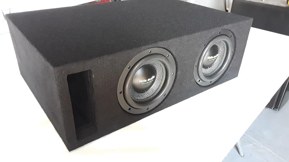

With those size limits I think you will get way better bass out of 2 8's in a ported box than that shallow mount will ever give you.
Of course you will either have to have the box built for you or buy the plans and build it yourself
If you're so inclined you can contact Buck, he does box designs and his prices are really reasonable

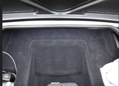

I re-measured the trunk space once again with the custom box removed and its dimensions come out as 19 tall | 22 accross. The box itself could sit in this area if it needed to. Now what sub box do you recommend I put in this space thats 19 tall x 22 wide. Remember I listen to rap mostly so I want some nice hard hitting bass that will use the 2 ohms of my amp.

fView attachment 29741
You'd be surprised at what a good pair of 8's on good power can do.
