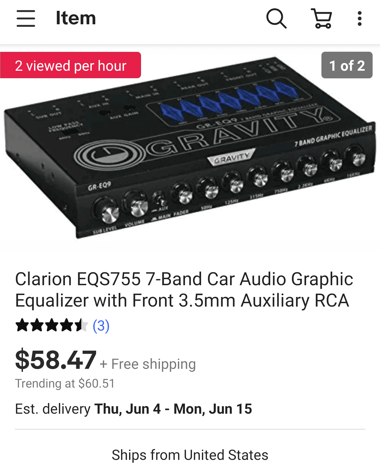

You could use an active equalizer. Some have a rotary master volume. Mine is a $60 Clarion
