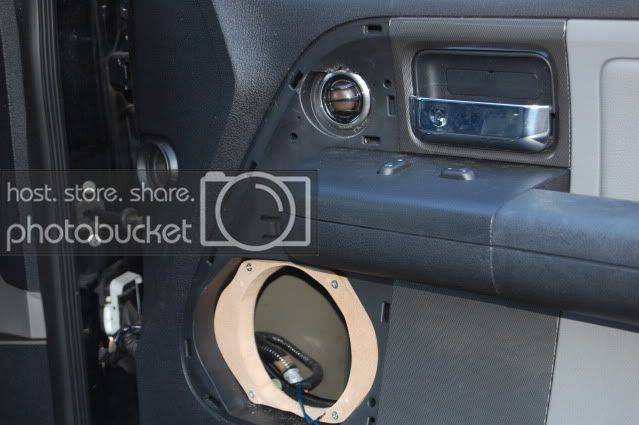

This will give you an idea. I have since made a new adapter out of 1/2 mdf that fits in the hole better. This pictured is 3/4' mdf and pushes the speaker out too far. my current set up looks much better.

well does the adapter that comes with crutch field come in any size bigger than 5 1/4?
the link you posted is for the focals. the focal mid is 5 1/4. you could go with bigger mids. the adapter is focal made and should already be in the component box. They are pretty much like a 5x7 but with a cut out for a 5 1/4" mid. I'm not really sure what you're asking

ok well say we dont go with the focals and went with pioneer premeirs with a 5 1/4" mid, it would come with the door adapter for 6x8 to 5 1/4".. if i got a 6.5" comp set with a 6.5" mid it wont come with an adapter for it because the mid is too big and CF doesnt have a 6x8 to 6.5" adapter
crutchfield also wont give me the option of installing in the front doors unless its a 5 1/4" speaker i have chosen either, it gives me the option of kick panel only.

The 6.5 set is called 6 3/4" but the mid itself is actually 6.5. The adapters are in the box for the 6 3/4(6.5's). you dont have to buy anything extra.
i'm not sure. I pretty much ended my research on components when I found these things. Just keep looking until you find something you like, and just be sure you know what comes with it. I dont think a whole lot of manufactuerers include the 6x8(5x7) adapters, if not, then you can simply make your own, or have someone on here make them.

thing about the adapter, its a 6x8 adapter and id like to mount the tweeter in the adapter so i dont have to cut a hole in his car somewhere
The phase plug comes out of the mid and the tweet will go in its place becoming a coax of sorts.
No holes needed to cut.
