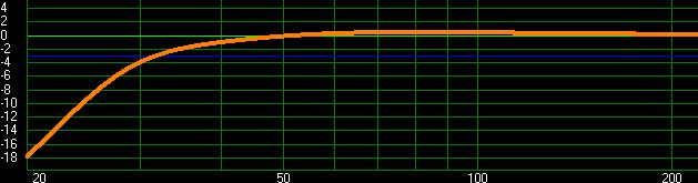

My brother eventually upgraded and gave me back my sub and I reinstalled everything with a new head unit and rca’s. The sub sounds great with rap and metal in the spec box this time around It didn’t before I must have some electrical issue here is the graph.

Thanks 2RZ-FE I read through all your box building adventures a few times when I was researching the sub. I mostly listen to 2000-05 ish rap and 80’s-90’s hard rock and metal. Do you feel like you’re losing anything on the low end? I know a specific song hits at 28 and I’d like for that to rumble like it does now but I’m wondering if tuning a little higher would make it more punchy on kick drums.
Try 33 to 35. I am powering mine with a JBL GTR 1001 sounds good even though it’s not properly tuned I need to go somewhere and crank up the sub control and adjust my gain I’m only at +3 on the sub control and less than 1/4 gain probably leaving quite a bit on the table even after box rise I don’t have a subsonic filter either
