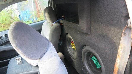

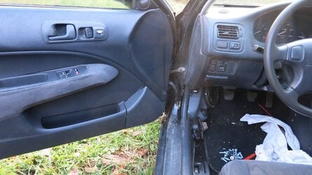

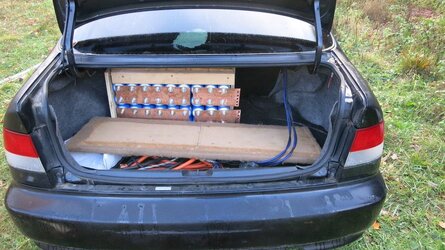

Got the bank almost mounted in my brother's Civic yesterday.    Need to go out and buy some bolts to get it grounded to the frame then a few hours to get the front battery gone and mount and connect the amp.
here are some pics from when i went over to hispls house to help him get that battery box and bank installed two weekends ago.

here are some pics
Thanks, man.  I always try to stop and take pics when I'm working but usually I get too focused on whatever project I'm into and don't take enough (or any).
