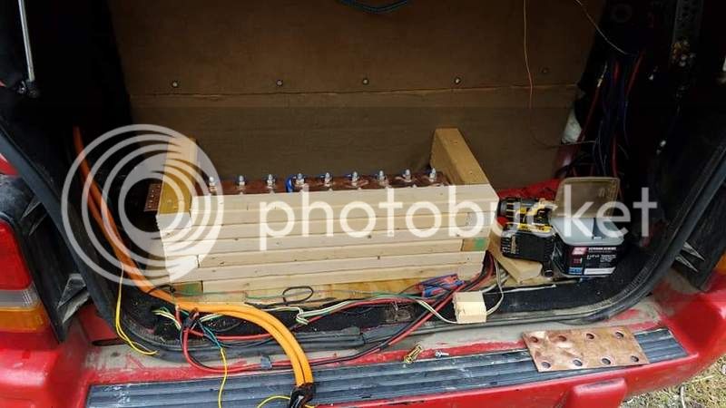

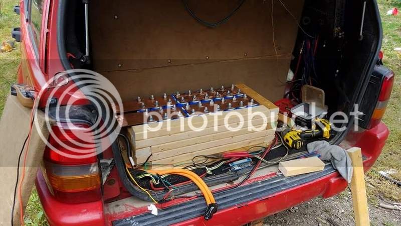

Lithium Titanate (LTO) battery bank build.
Saweet this will work great. So I  have a 12v powermax 55 amp power supply. So make the power bank first. So for my application 6s3p and hook up to power supply check voltage with ddm while charging and then install. After about the first wk or a day of heavy playing check each cells voltage, is that right?
I mistakenly said put them in series first after a few drinks last night. I meant to say put them all in parallel. So the whole bank of whatever it is, lithium or caps, goes in parallel for a final voltage of the single cell voltage. Then when they all equalize put them in series and charge them.
And yes check the cells individually until you're confident that they're working well in series. Kinda hard to do if you do parallel/series like some of the batt's hispls has in his pic
okay that makes sense. It wouldn't  be to hard to check hispls if ya just lay bank on side u can leave everything hooked up and just  check each cell that way, correct? I will definitely be purchasing some cells soon. Hoping to find a group buy to drive down the cost of cells. I'm  thinking these ones.
You leave it hooked up as a monitor all the time. Only balance cells when needed. No, these technically are not a BMS. As they don't control input or output of the bank. Just monitor/balance, and charge cell packs as needed. Your alternator will keep the battery, as a whole, charged.

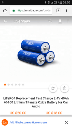

Yes, these run on 12-30v DC power. I'll be using a 24v 20a power supply to charge/balance mine when needed while sitting at home.
You just missed a big group buy on the LTO cells hispls is using. FB man ..... its helpful at times ...
Alright. Well I'm ready to build this bank now. That's  a big amp. You running 1ohm on that?
.7 ohm
This power bank will start the car and charge everything and run lights, a/c / heater.  All the lil electronics it wil need to and not take away a bunch capacity from the audio side?
Mine is doing just fine on this amp + everything else.  I'm sure half that would do fine with a 5K amp + the car's needs.  Not like the car needs much and really the point is your alternator feeds the car then what's left over charges into your battery.
Starting the vehicle in cold weather won't  affect this bank u think?
Performance suffers in the cold, but these are supposed to be far more cold tolerant than LiFePO4 and of course even lead acid batteries suffer in sub-freezing temperatures.

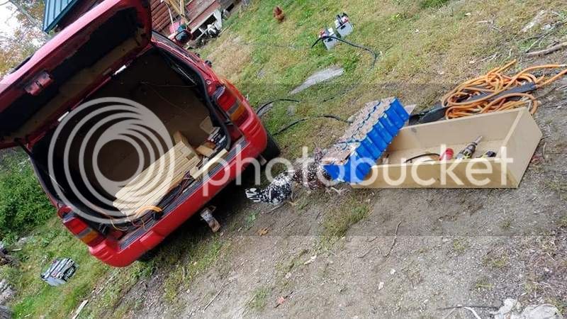

Not sure how thwy are running their cells. But they aren't running bms's on them. I have no idea how they get their ah ratings of 15ah for a 3k system. They must be running the cells hard for those ratings, As u stated. And yep they'll  die or worse.
You would need to break it all up the way I have these bussed since the 6 packs are P you would measure only the entire bank.

The initial bank I was planning was those cells, I'm glad I jumped ship into the LTO.

If you're in Texas you definitely won't have to worry about loss of performance from being too cold.  By all accounts LTO holds up very well down to freezing and even a good bit beyond that.   Even the guys in know in Massachusetts who ran LiFePO4 last winter had no complaints and LiFePO4 is known to be quite weak at and below freezing.
Definitely do NOT put these under the hood.  They've got pretty good tolerance on the hot side, but keep an eye on that if you run them hard and live where it's 110 degrees most of the year.... perhaps an open side bank or some fans?   Though if you're going 4p6s You'll barely be pushing 1C in or out 90% of the time.
