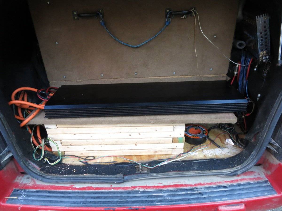

Big amp is """rated""" 4000W @ 1 ohm.  Might be a little over-rated.  (see picture).  Not going to speculate too much just in case I ever try to get into a rated power limited class.  My fronts amp is 150X6, honestly rated.  I did not try burp yet, but I went very hard on it with music for a while.  Use that would drop me over 2V before is dropping only .2V.  Anyway, what I was doing was far more strenuous than 3 second burp.  That will get a bit worse when it starts getting sub-freezing up here but as the cells warm up from use and just running the heater they should perform as normal with some use.

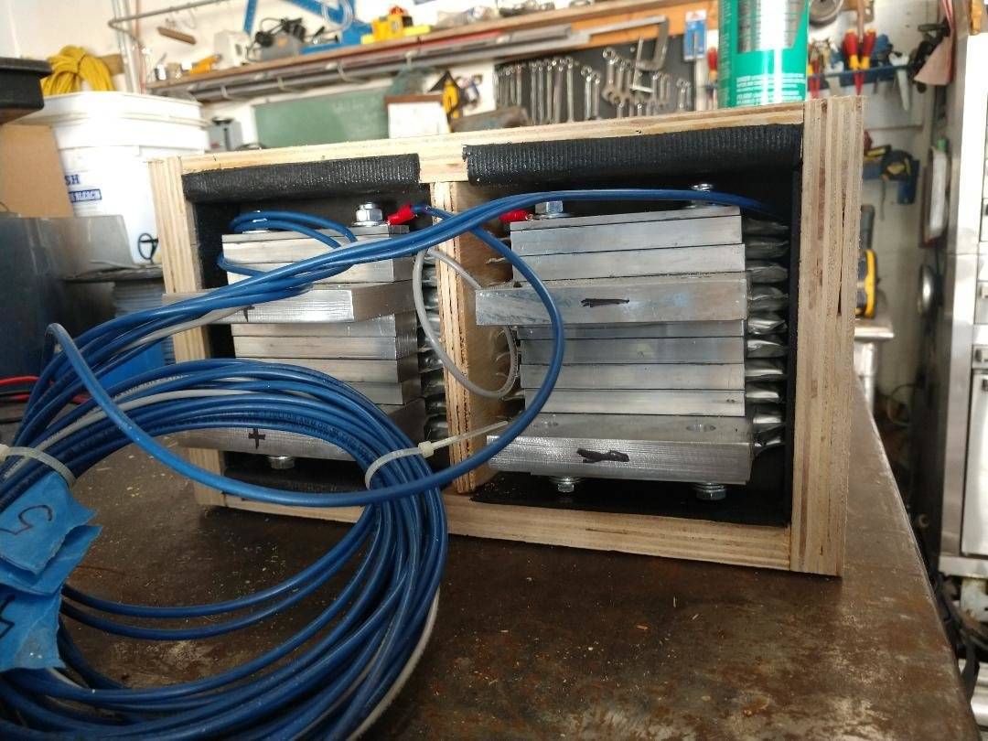

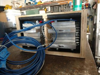

That is what the six blue and one gray wire are for coming out of my battery. One + off each pack of cells( so six for 6p), and one - . those connect to a charger/monitor/balancer unit.
I will be using Icharger X6 units.

You leave it hooked up as a monitor all the time. Only balance cells when needed. No, these technically are not a BMS. As they don't control input or output of the bank. Just monitor/balance, and charge cell packs as needed. Your alternator will keep the battery, as a whole, charged.
