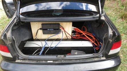

So I got the Civic playing music today.   Sadly my original amp board and plan to mount the big amp vertically is dead because it doesn't fit between the hinges.  That would have hid the terminals and wire on the right and the 4 channel was meant to go into the left hand corner (where RCA and speaker wires go).
I also need to pull the front seats to figure out where the wire went that I left for voltage display up front.  Hopefully I'll get a chance to do some proper testing done this month but for now everything is secure and it's playing music.
