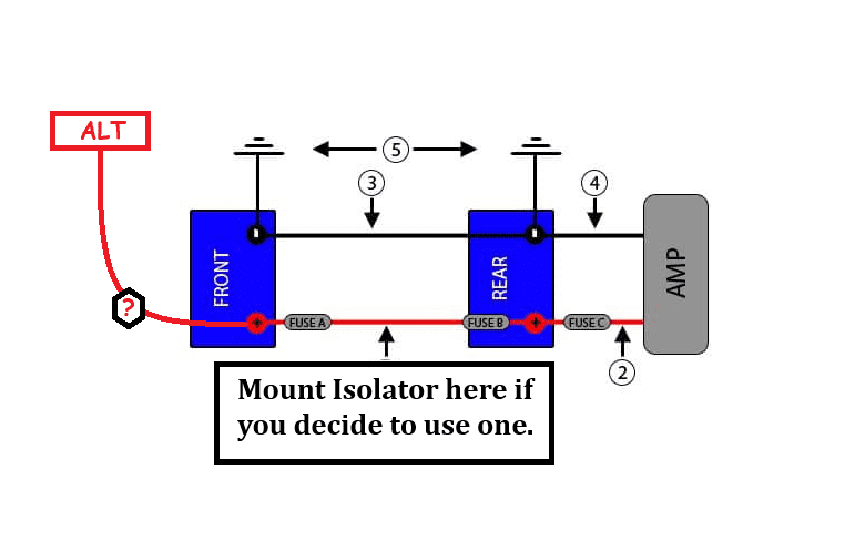

I run a BOSCH AGM under the hood and a GlowweVoltage in the rear of my hatch, 500A smart isolater, in between, because I had already purchased one and could not return it!
That said, both the GloweVoltage and the XMAX45 are LiFePO4 batteries with almost identical charging specs, which is the criterion for when you want to isolate the Lithium.
I recommend the following when connecting the two in parallel (including a parallel ground):

They play well together without a lot of extra's at all.

Thank you very much. I can run a lithium and Agm battery in parallel together with no isolator or dc to dc charger?
You can run any set of batteries without anything in between if the charging voltage specs are identical or very close to being the same.
The charging voltage is the consideration, not the chemistry - so one is 13.8V, the other is 14.4V, that's not an issue.
If one is 16V and the other is 13.8V, that's an issue.
Granted, different Lithium solutions, where the charging voltage is significantly different from that of the other battery, require that you use an isolator or other device that separates the two.
In your case, the LifePO4 is virtually the same charging voltage as the AGM under the hood, so you don't have to use an isolator.
