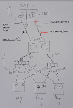

I recommend running dual battery's with parallel connections and parallel grounds. Something like this but suited to the build.
