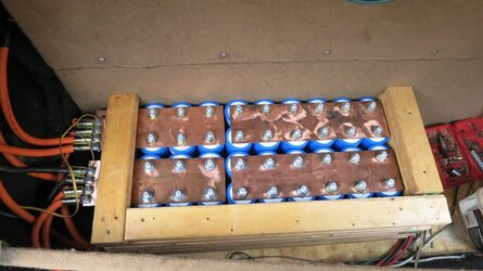

So 1/8X4" copper bar was like 210-220 per 12 foot section after shipping.  Barely even considered aluminum.  By the time you get thick enough to get around the inferior ampacity you're almost the same price as copper anyway and why cheap out?  I called up Storm, they seem to do mostly custom bus bars, talked to their tech, decided on copper... no regrets.   Nuts and washers were just whatever from Fastenal but still 75 pieces per bank plus some 1/4 20s to bold ring terminals, used 2 hardened drill bits 1/2" plus the 1/4" one, took some life off my step bit, bought a big tube of dielectric grease and some cutting oil, sawzall blade, and one of those sanding flap discs for my angle grinder.   All in probably 600$ in consumables and hardware to do these two banks.   The point being whatever you do, you'll need to either buy bussing solution (there's a couple existing ones that were less cost effective) and you'll need to buy other odds and ends before all said and done.

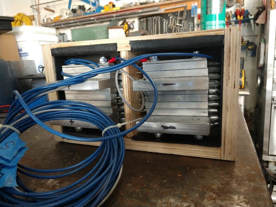

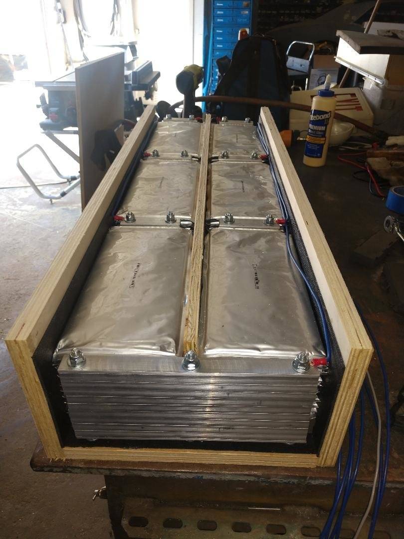

For one, we definitely need something non conductive, and we want these to be snug in the box and the box very securely fastened to the vehicle.... also need to figure out a way to easily connect wire in and out.    I wound up using 2x3s since I have a pile of them I got for free.

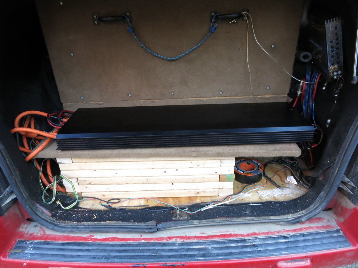

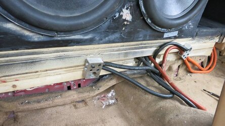

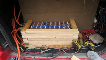

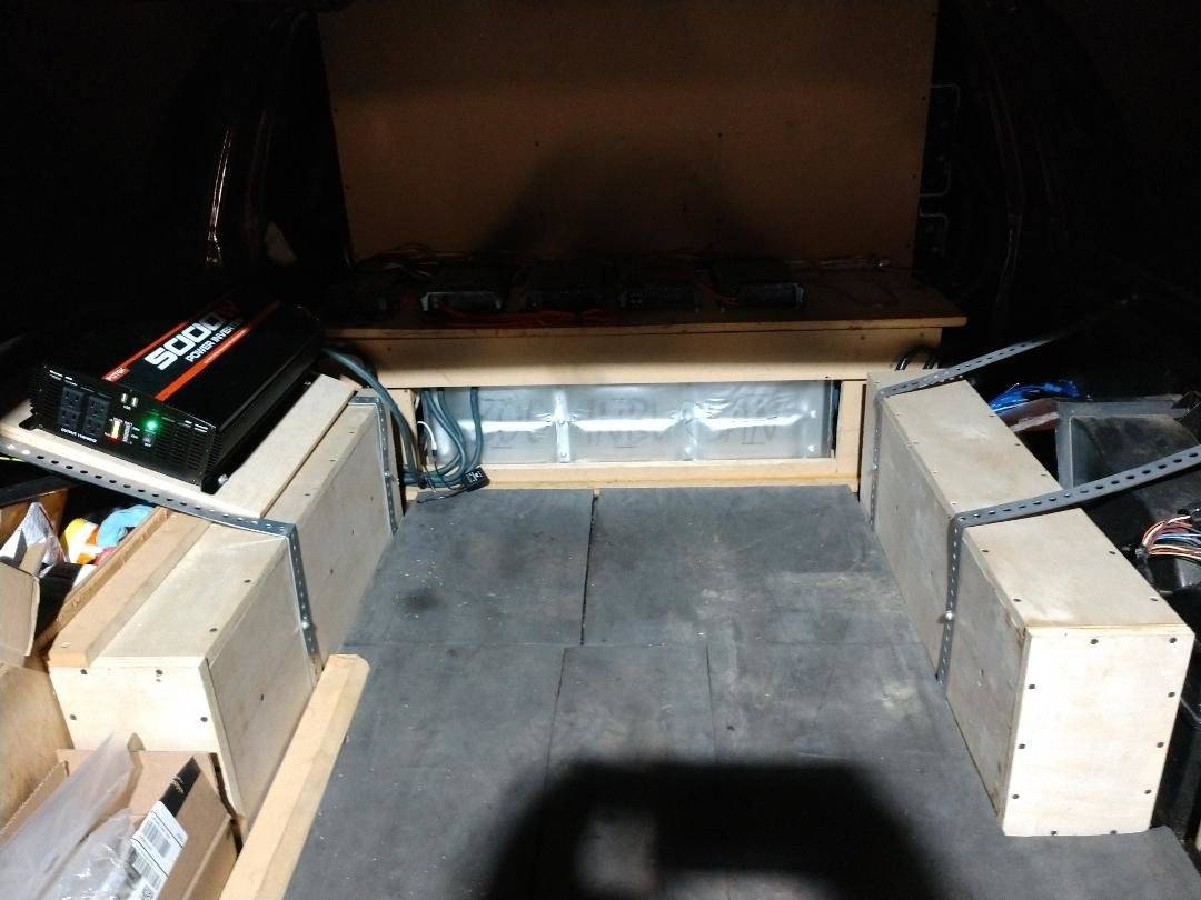

So, with a little help from another forum member I got these in this afternoon.  Use the 2X3s to box them in for now since I've got a pile of them and it worked out pretty easy.  I'll probably try to do something a bit more streamlined later once I try to mount the second amp but for now my existing amp board just screws on top of this covering up the terminal ends nicely.

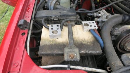

Under the hood battery had to go.  LTO bank will rest as high as I can charge them and I don't need a 12.8V battery ******* the life out of them.  Good riddance.  Used a scrap of a house log plus a bit of ply to hold these terminals together under the hood to cover alt, system power etc.  Also I never had wire running all the way back in this Jeep since originally I was just running AGM behind the front seats in front of the wall.  Those batteries are gone (need to clean up the baffle now... that part used to be covered).   Used a couple more of my leftover distro blocks there to take power to the back... this also leaves me +12 and ground up front for an inverter or anything else I want to mess with.  I'll probably cover those up with something to avoid chance of shorts.
So the moment of truth.   It was slow going getting the voltage up at idle.  Banks were resting 13.4 when I assembled them.   After I hit 14.0 I put the spurs to 'em and couldn't get voltage to dip below 13.8.   Charged up to 14.4 and took a little ride to really get on things.   Played to the point of stinky subs some pretty hard songs and couldn't get more than .2V drop.   I must say I'm incredibly impressed with these cells so far.   I'll continue to update when I get the bank in my brother's car (with stock alternator) and when I get my second amp in.   I could drop my voltage down very quickly before down to 12.0 in about 2 hard songs down to 12.8 on burps, previous bank was 3X 110AH an 5X 55ah AGMs.
