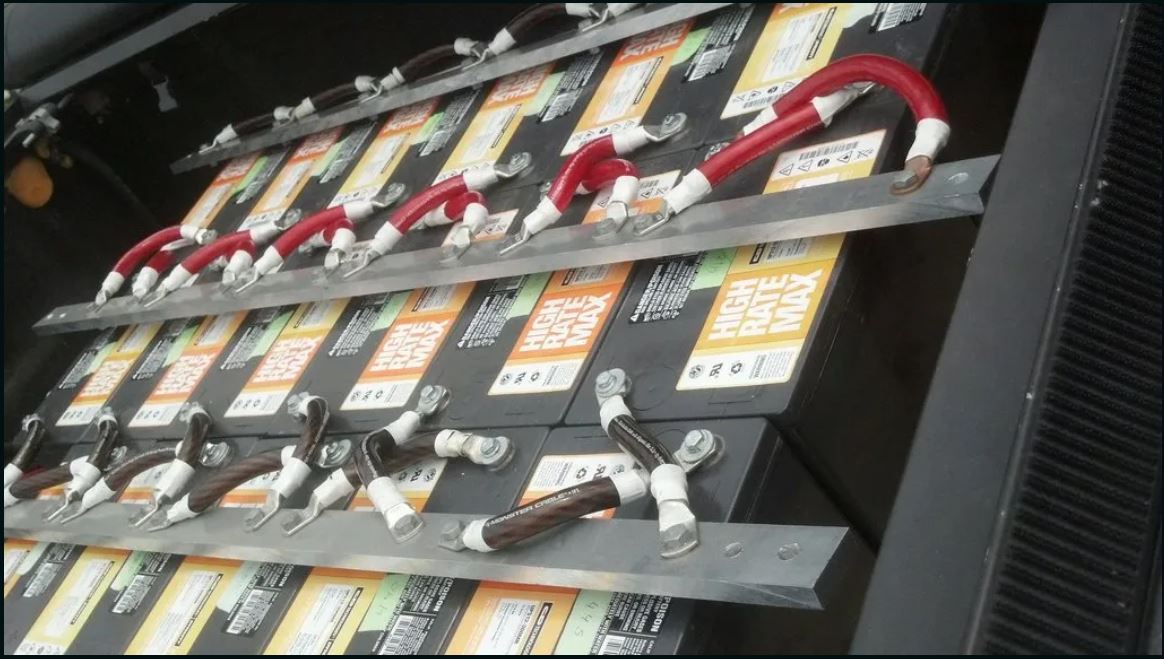

Since they're individual cells hooked together just by bus bars, wouldn't you have to worry about balancing? I still have the 3 foot aluminum bus bars from the last build I did, which I could cut up and drill for these lithium banks.

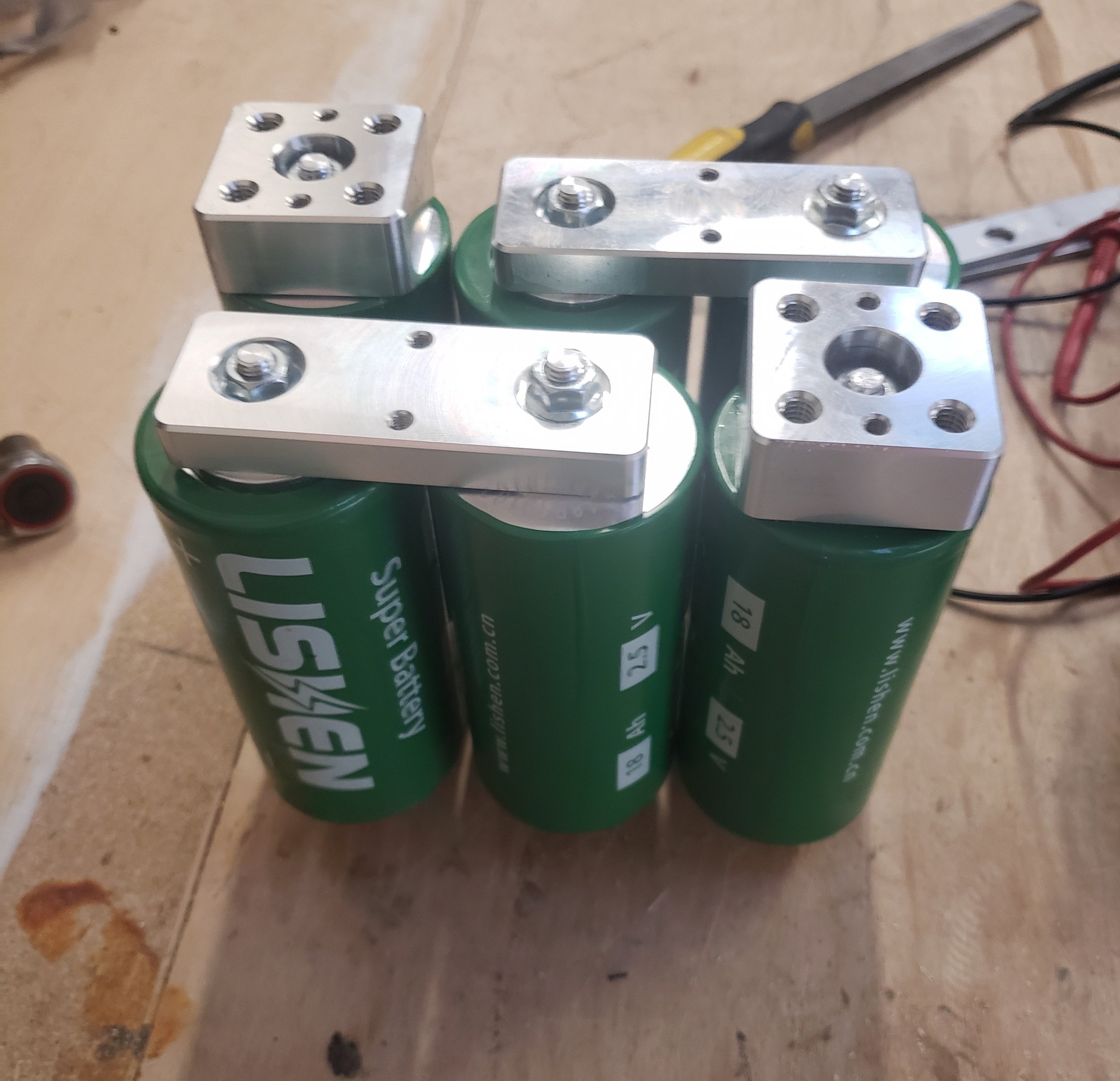

Your existing aluminum bars may or may not fit well with terminals depending which LTO cells you try to use. I've been using copper for mine but that shit is getting expensive these days.

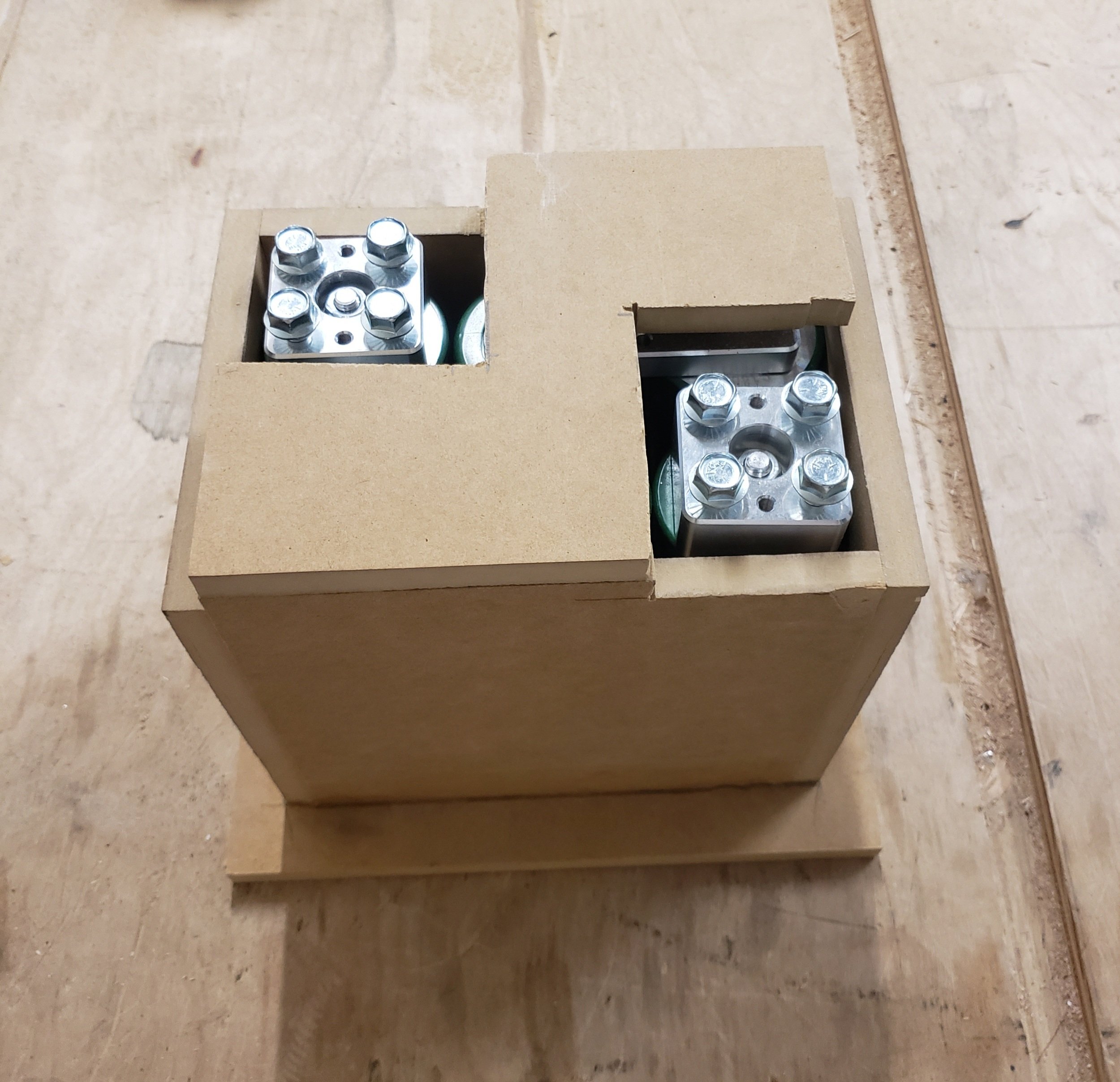

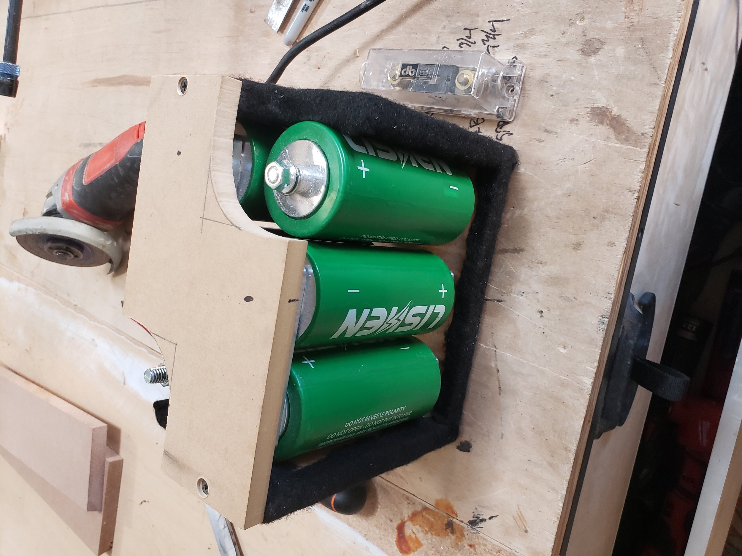

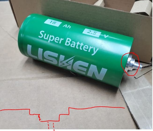

I have some metalworking tools, so I was thinking about counterboring the bus bars to fit around the base of the studs:

Anyway, counter-sinking the bars is an option but an awful lot of work if you don't have access to a real metal shop.

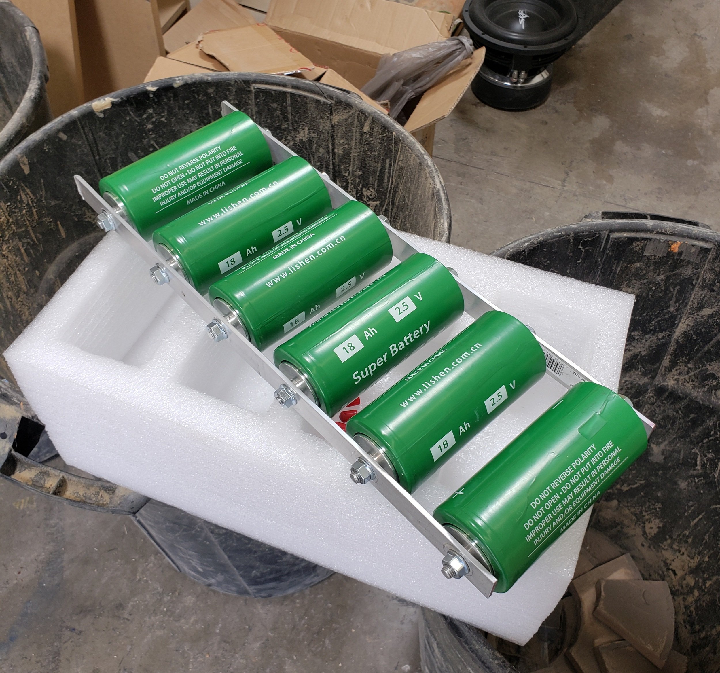

The Lishen cells are rated at 15C/50C. 15C being the maximum recommended continuous pull (270A), and 50C being the absolute maximum rated draw (900A). The Wilson Audio Labs test showed the smart 3 drawing 277A at 1 ohm, 288A at 1.3 ohms, and 334A at 2 ohms. After watching the video, I definitely learned a lot about the smart 3, assuming their information is accurate. If I'm wired to 1 ohm nominal, my minimal box rise *may* be somewhere around 1.3 ohms. I know there are a TON of factors with this, and it is theoretically possible my minimum box rise could be around 2 ohms. The amp establishes a maximum voltage output based on the load, and isn't "constantly correcting" (making a constant power over a range of impedance) like I had incorrectly assumed it would do.
That being said, if we assume the amp draws 300A for extended durations of time, it's a bit out of the comfort range of one bank. If I add a second bank, it should be well within the usable daily range, even factoring in the 4 channel amp and vehicle's draw. My stock alt is something like 75A. I'm thinking about trying 2 banks on the stock alt first, and then deciding between the 240A and 300A alt based on voltage drop severity. Likely, I'll end up going with the 300A, because I don't like to skimp.
I'd like to test my skills with the bus bars. I have some mill bits for my drill press at home. Otherwise, I have access to the metal fabrication shop on campus. As long as I'm bringing in my own aluminum stock, I can work on personal projects. Worst case, they turn out bad and I have the local metal shop (which I know the owner of) make some bus bars with the remaining aluminum bars I haven't messed up, haha. Otherwise, I saw some for sale online.

Thanks, any pictures of the bank setup for reference? Is it the "4S-6S" model for 6 cell banks?
