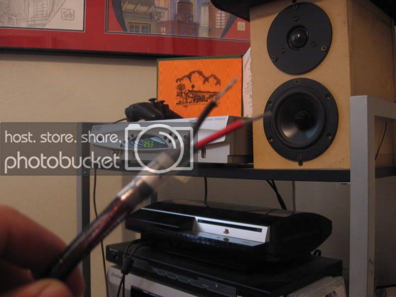

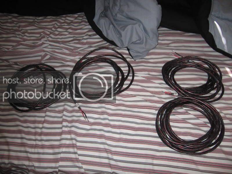

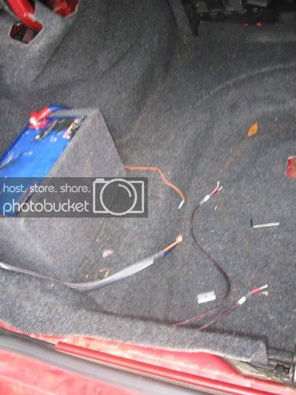

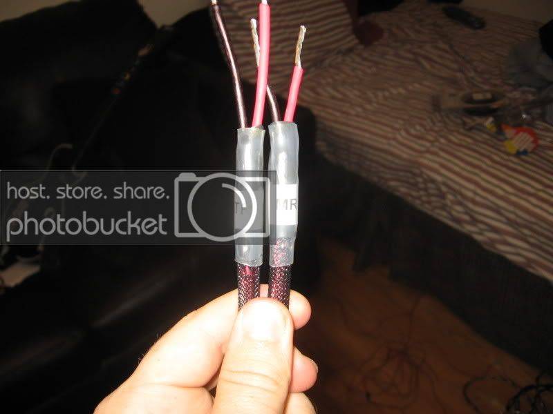

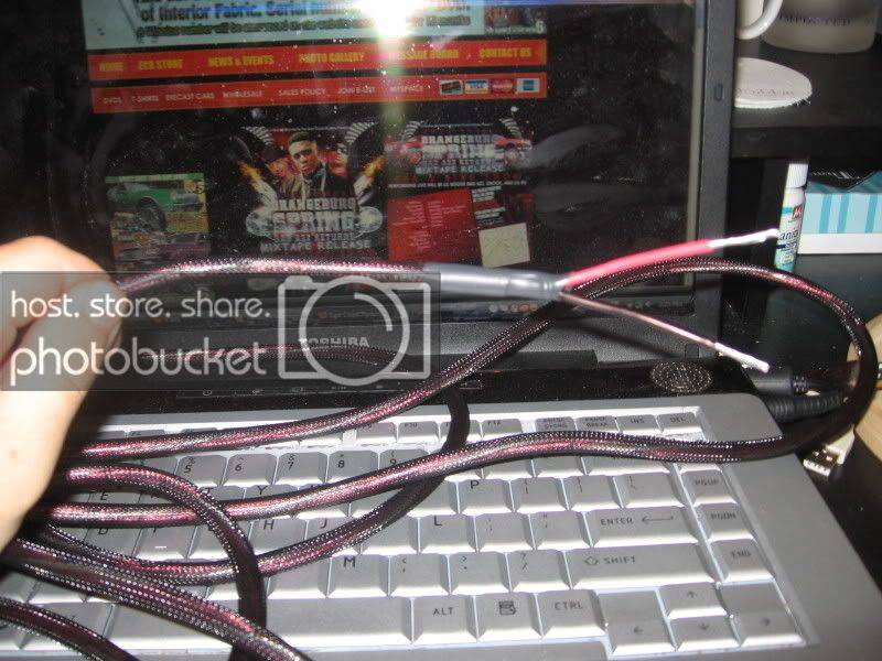

Anyways, part of the wiring done... Like I said this build is attention to detail! Speaker wires wrapped in techflex, each wire heatshrink and color coded, then labeled.
Gotta pick up some more tech flex.
All speaker wire ready to go

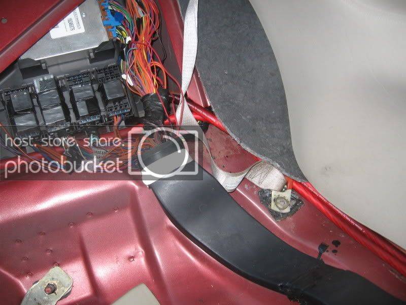

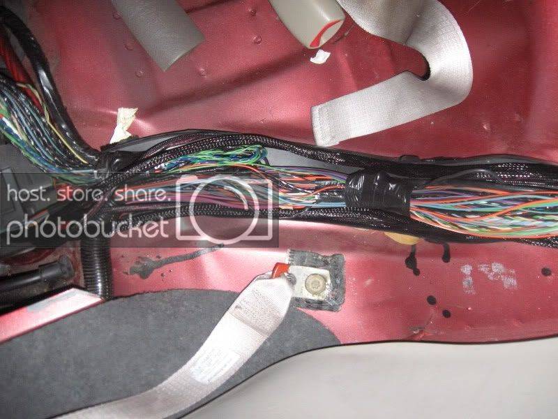

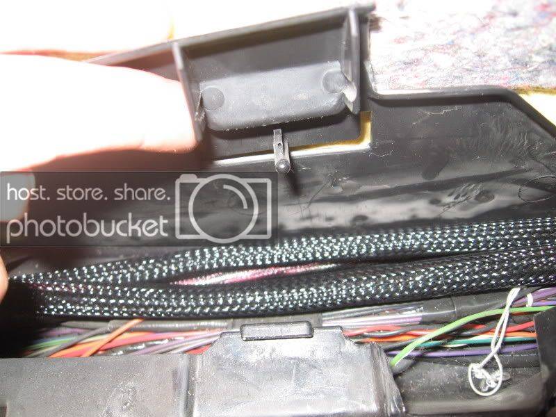

Got the drivers side all wired up... fit 2 runs of speaker wire, 2 runs of 0 gauge, and 4 more wires for the alarm all in the stock wiring harness.

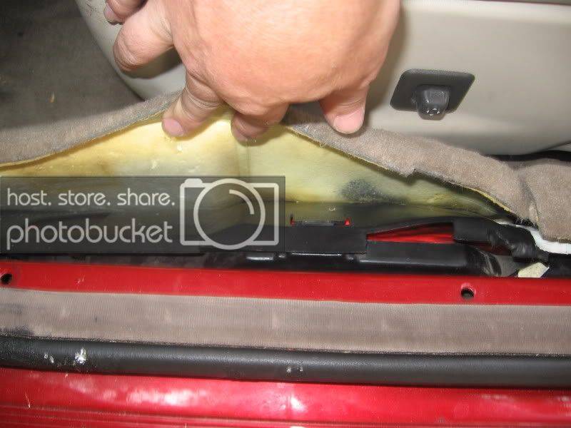

Also made it so you can not see and of the wire runs, except where they will need to be connected (0 gauge & fuse ran behind carpet, and same with speaker wires).
Other side wired up... everything hidden in factory wiring compartment...

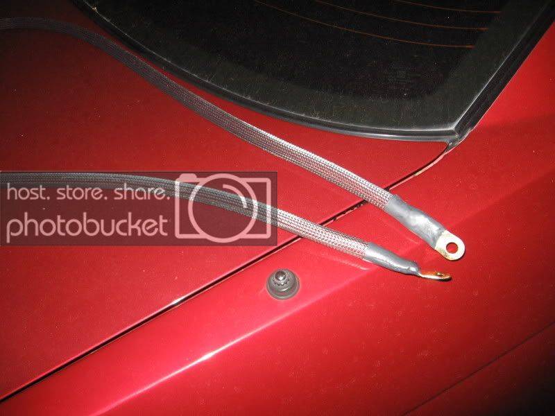

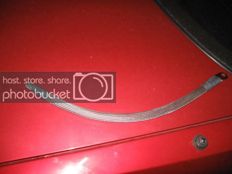

Some wires flexed and heat shrunk..

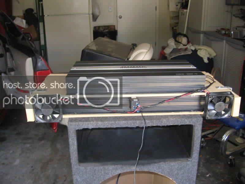

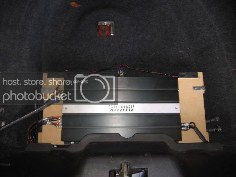

Amp Rack done... front..
Back... 2 fans blowing directly on the heatsink for the saz3000, relay in center for remote turn on and fans

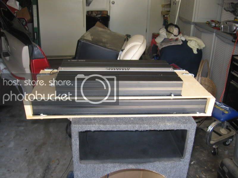

Amp Rack in..

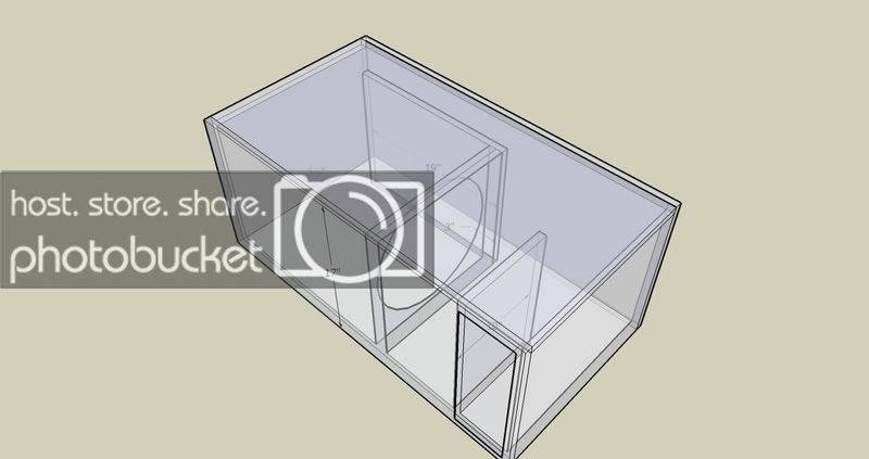

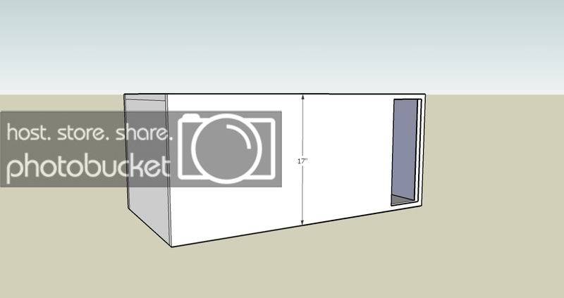

New box for the Nightshade... a 6th order =D... thx to 80inches for the design!!
Thinking about doing a light coat of black and then putting grill cloth over so it just looks like a wall.
box design is sick, get started on the build //content.invisioncic.com/y282845/emoticons/biggrin.gif.d71a5d36fcbab170f2364c9f2e3946cb.gif
and where can i get some of that techflex, i want some //content.invisioncic.com/y282845/emoticons/frown.gif.a3531fa0534503350665a1e957861287.gif and the **** site has so many, which is the best to buy?
