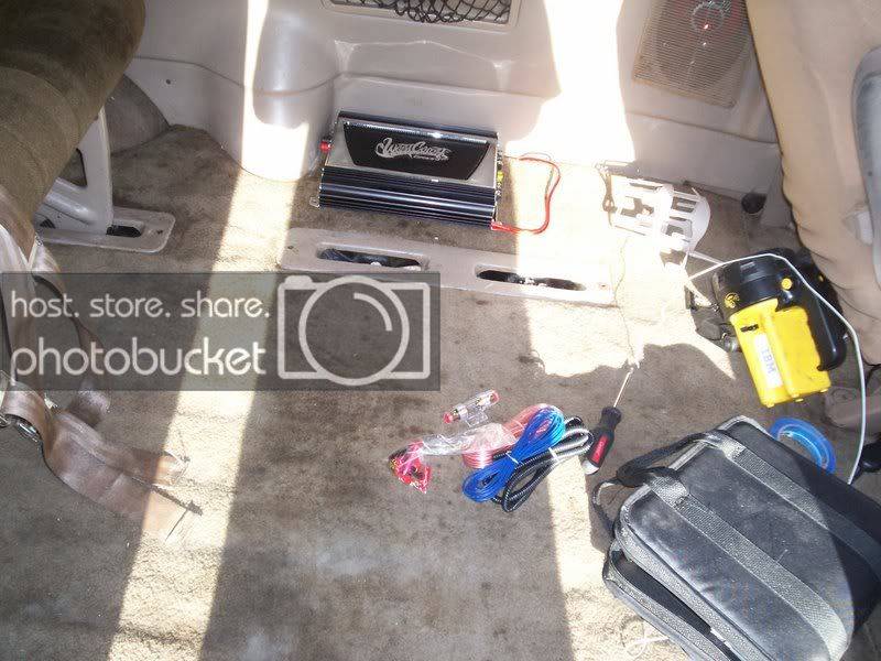

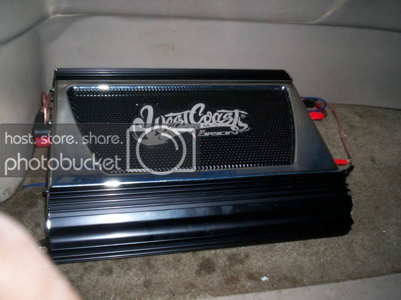

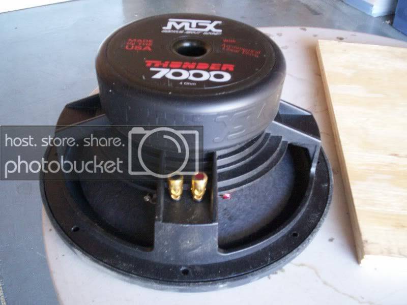

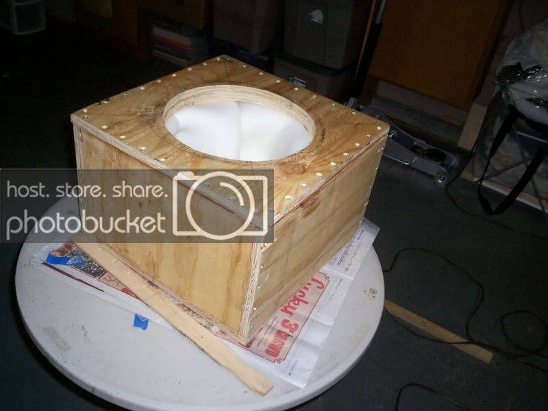

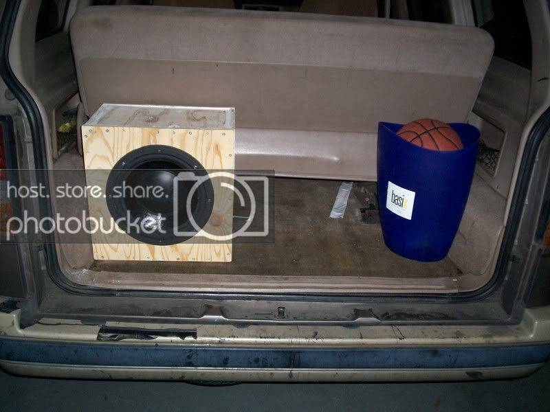

yuup so i dont post alot on here and i dont know alot about car audio but i know some basics. i shouldve done more research before trying this out but who cares i got the sub for free from my friend, she had it sittin in her garage collected dust n all that good stuff, so i took it off her hands for her and i decided to try and build my first box. and i got a wcc-5001 for $50 off my potna, and i hookd everything up today and it slaps pretty cool. The sub is an MTX Thunder 7000.
after a couple minutes of slappin my battery didnt wanna take it anymore but its coo cuz i needin a new one anyway this one was 100 watts below plus it was worth it off top.
And i would like too say im sorry in advanced if my pics are too big or if i didnt read some forum rule.... but enjoy bruh

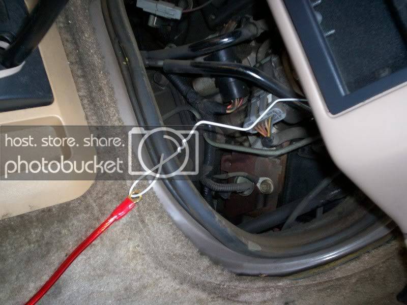

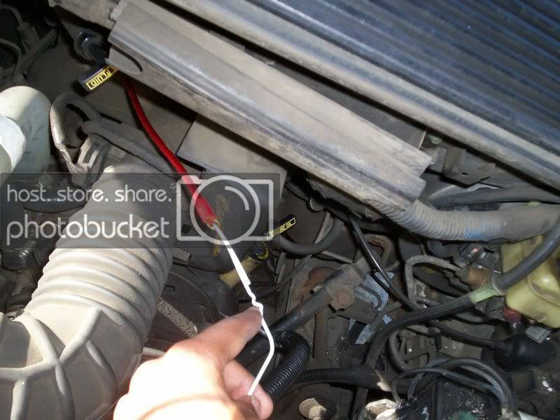

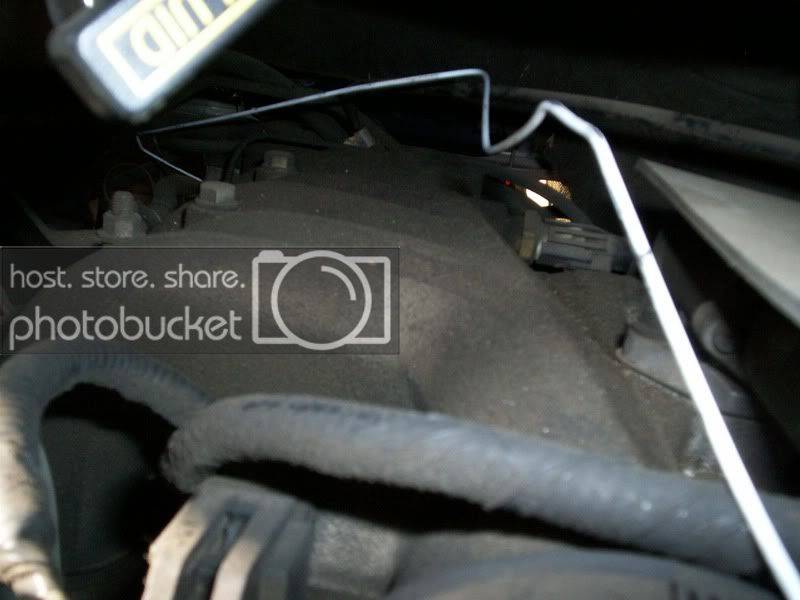

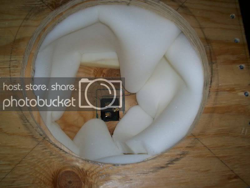

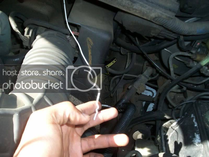

can you say electrical fire and fried sub? I see foam packed into that box that will end up suffocating the sub, and a freaking coat hanger?
dummy he used the coat hanger as a snake but yes watch out for your power wire. it gets hot right there. u can slide it behind the insulation on the firewall on the drivers side of the motor. just have to peal a little back. will keep it away from the heat. just my suggestion.
nice little set up. sure is nice to get some sound in your ride huh?
with a fan that size i think this will be just the begining of a future monster. this hobby has a way of pulling you in until you have gutted your car. lol

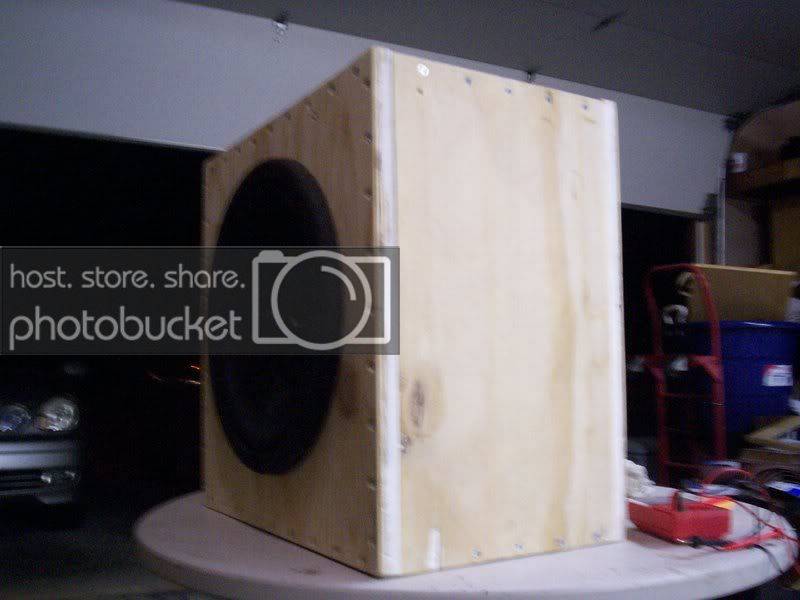

also i have said this before but **** bro your building a speaker box not a tank. that is some serious screw use. //content.invisioncic.com/y282845/emoticons/laugh.gif.48439b2acf2cfca21620f01e7f77d1e4.gif
yuup good lookin on all the posts i told you i dont know any thing about this ya ima take the foam out faaast i didnt know bout that..
edit: does any one know if its cool if i just line the foam on the interior walls is that still not gunna let the sub breath?
