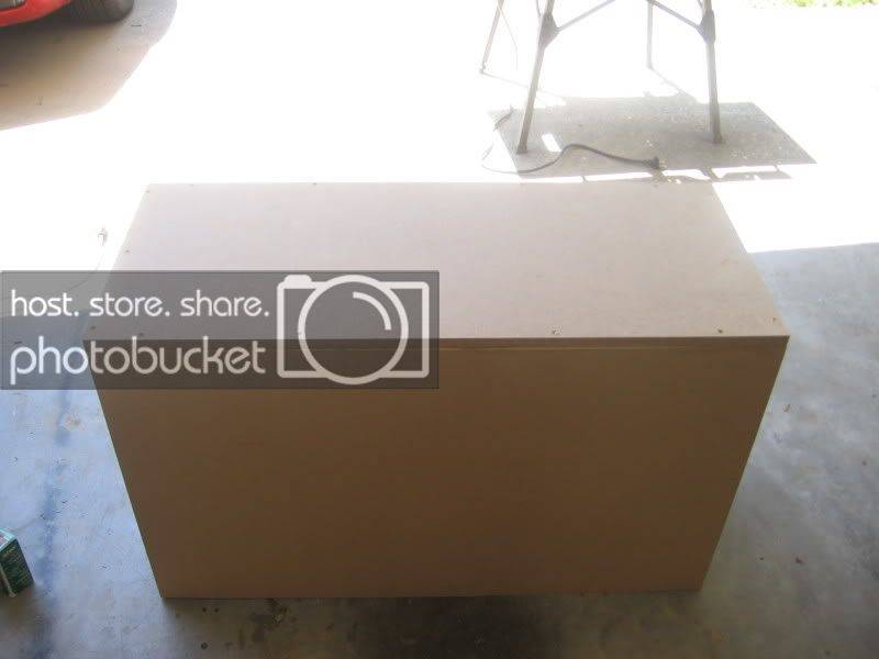

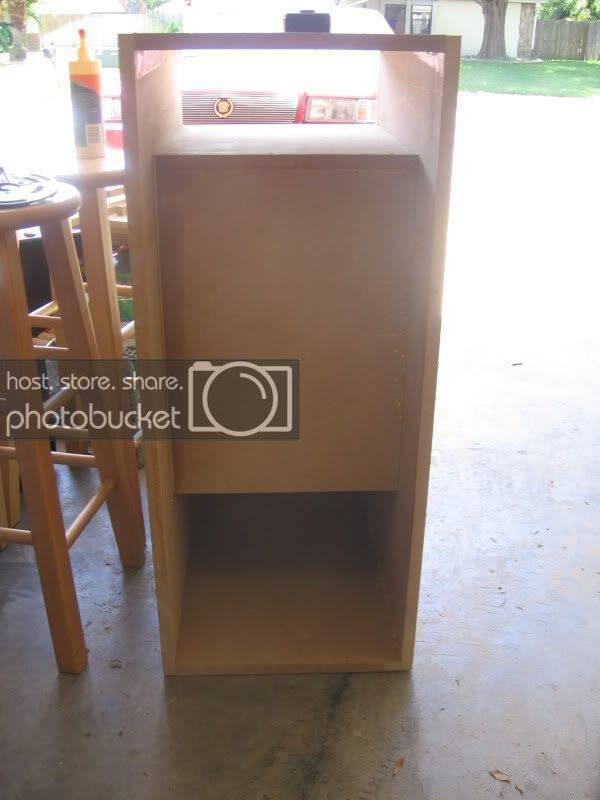

Sold the BLs, so doing one 15" BTL for now. Original plans were 5 cubes @ 29hz, but thanks to me trusting home depot, it will end up 4.5cubes @ 31hz. This box is just something to have, no carpet or paint.

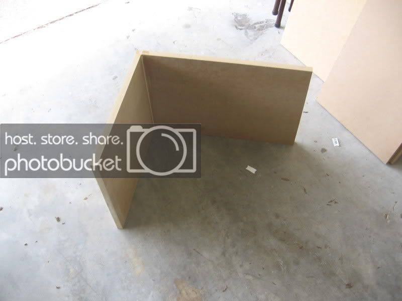

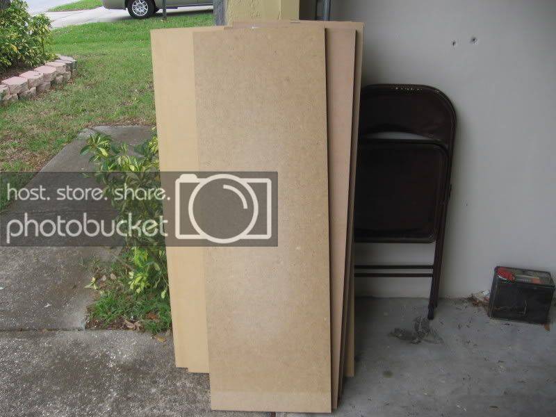

The home depot wood, that should all be 48" wide, but they like to make them different cuts //content.invisioncic.com/y282845/emoticons/verymad.gif.3f39c5c2fd57527b671fad3efdfac756.gif
All the wood cut..

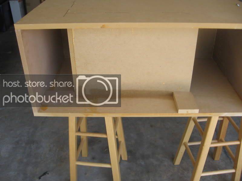

Port Wall together...

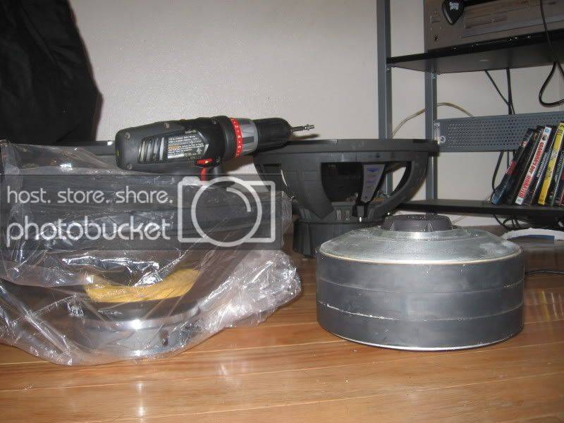

Still waiting on a recone and basket if anyone at Fi every emails me back...but the BTL motor compared to a Sundown SD-1

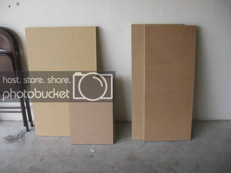

Actually I bought the 24x48 and 16x48 pieces of wood from there, hoping they were cut to length.

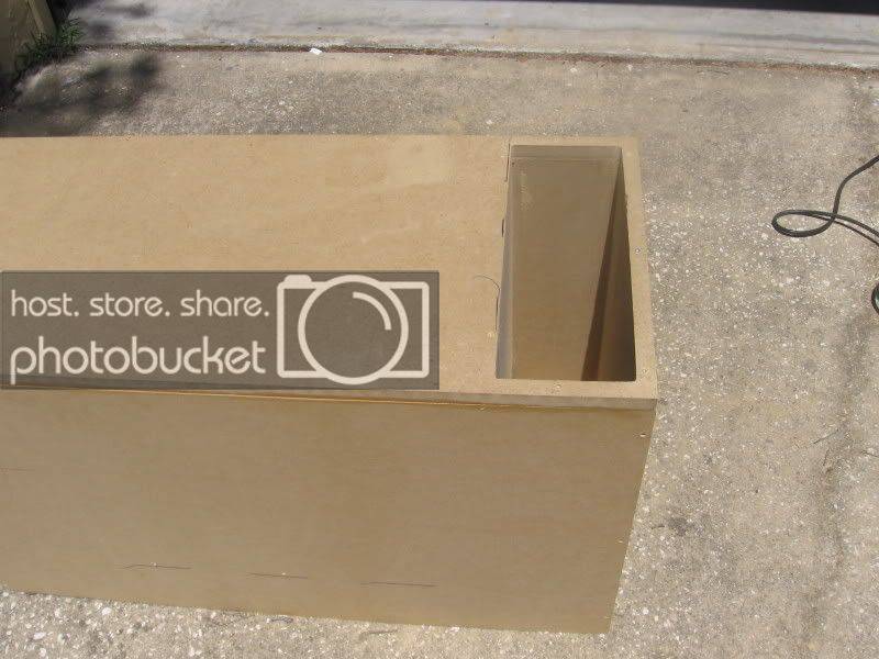

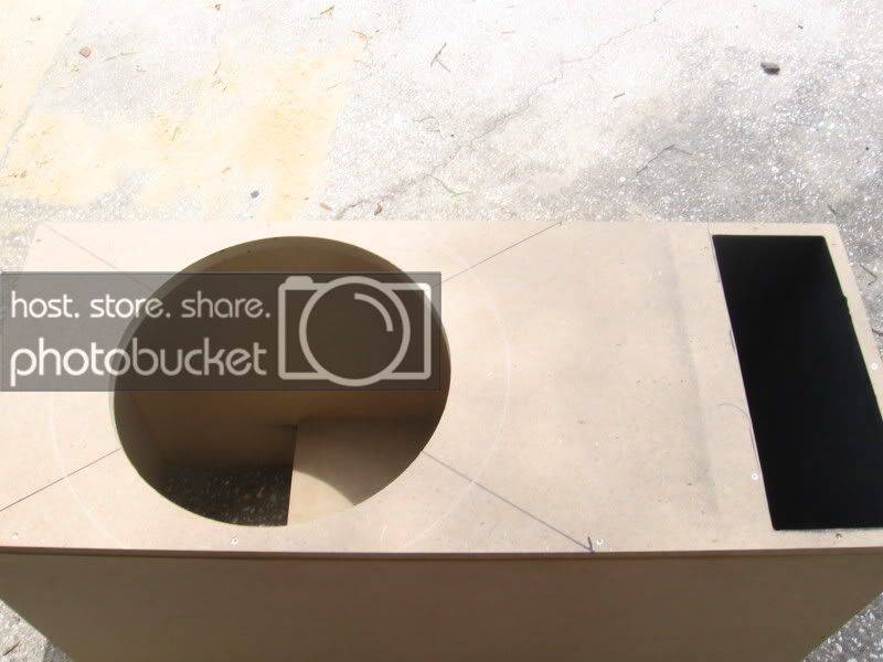

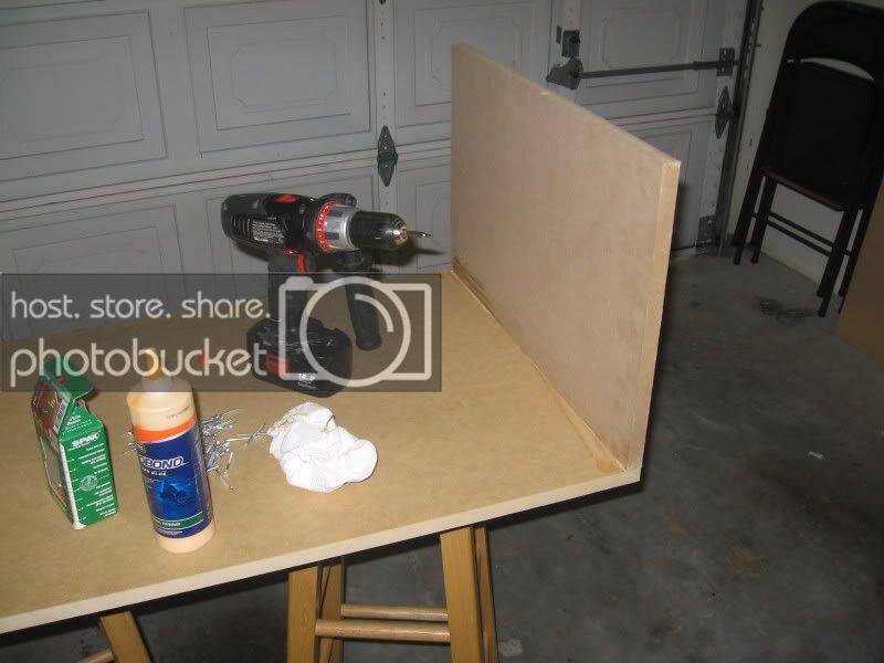

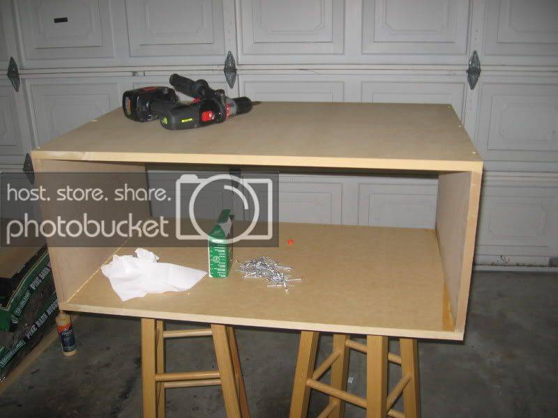

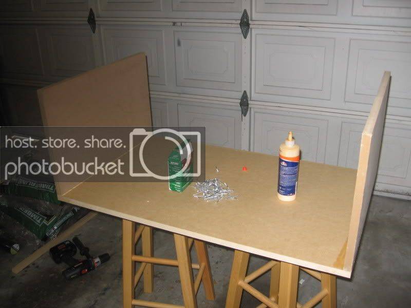

Pics of it being built... BTW anyone that doesn't have clamps or access to a nail gun, I HIGHLY reccomend these screws, they countersink and predrill by them selves, can't ask for much for in a screw.
Not sure how you guys space your ports perfectly, but I just cut some small pieces the exact width of the port and place them in and screw the port.

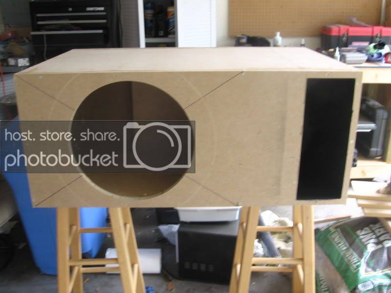

Flush trim bits FTW...
Also another trick I use... I put on the back last so when I router everything out, all the saw dust falls right out, instead of having to vaccum it all out behind the port n ish.
