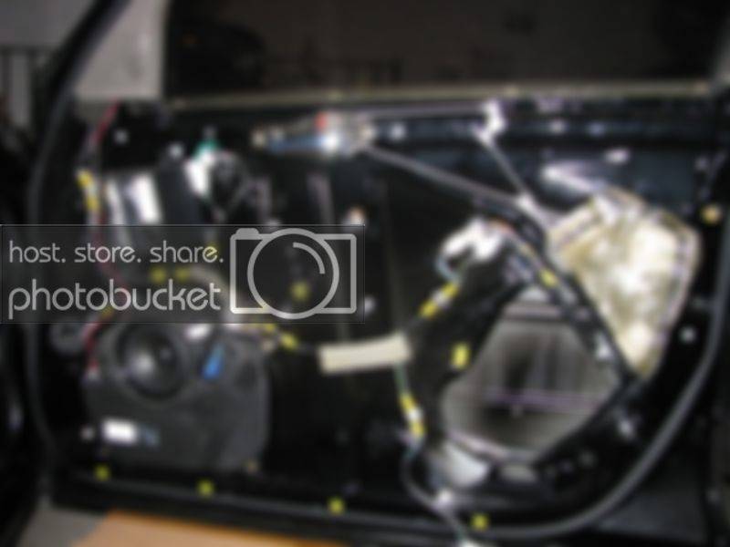

This is what I started with:

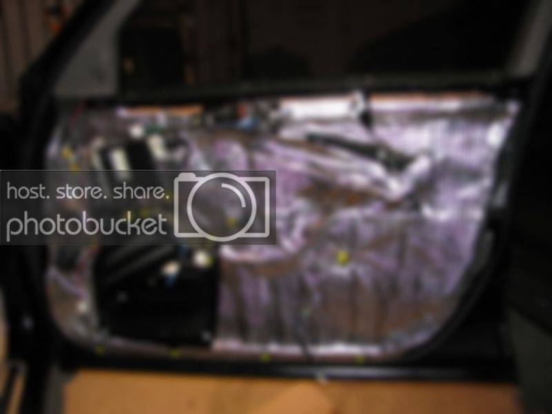

This is what I have now:

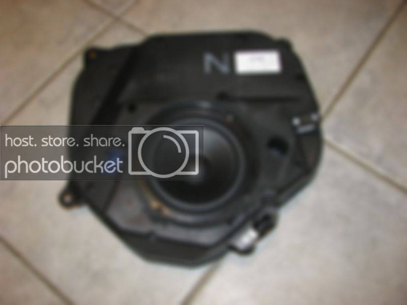

This is the OEM Midrange enclosure. It's fully sealed on the backside. it has a small port on the front just to the right of the speaker in this picture.
I'm replacing the OEM mid/tweet with some Hybrid Clarus'. Do you guys suggest I replace that plastic enclosure completely with an MDF baffle over the entire hole in the door? My concern is the exposure to the elements. Could I paint/stain it with something to make it weatherrproof?
Is another option a plastic baffle?
I have no experience or the time to learn how to make a fiberglass baffle.
Do you suggest a foam shield (baffle) on the rear to protect the 6.5" midrange from water?
I have 2" of room between the face of the speaker and where it mounts to the door.
Thanks for the info. I guess I should have mentioned I own an LS400. The hole is waaay bigger than the one in the IS but the idea is the same. I'll make a template and then cut it out to replace the entire enclosure.
No need for fiberglassing to do that baffle. If it's flat, then you can just use treated MDF, or you can use HDPE (thick hardcutting board).
