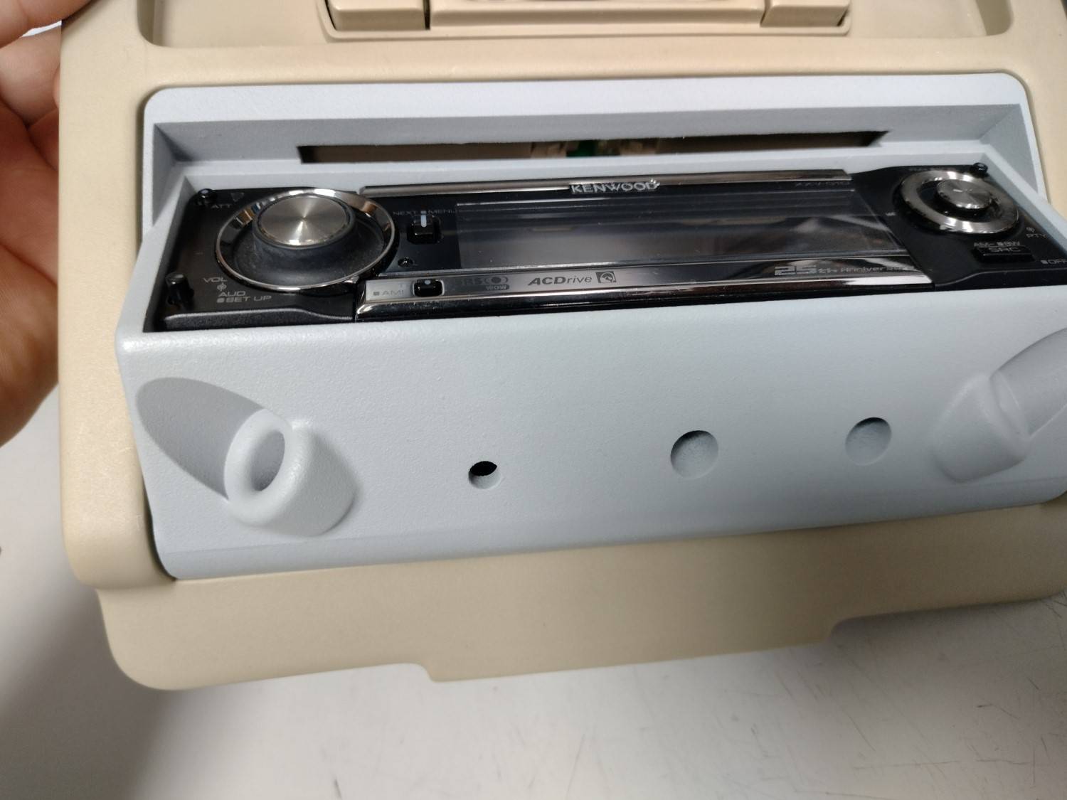

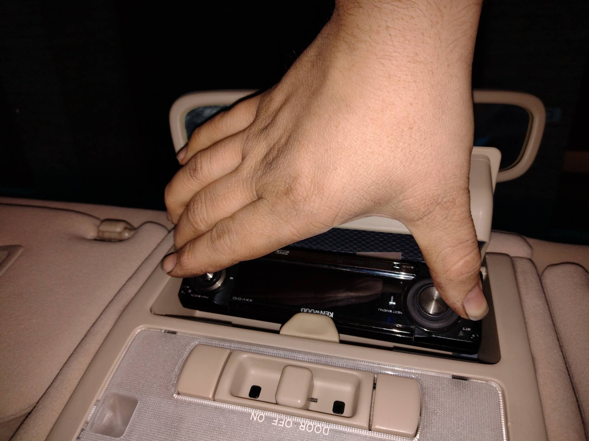

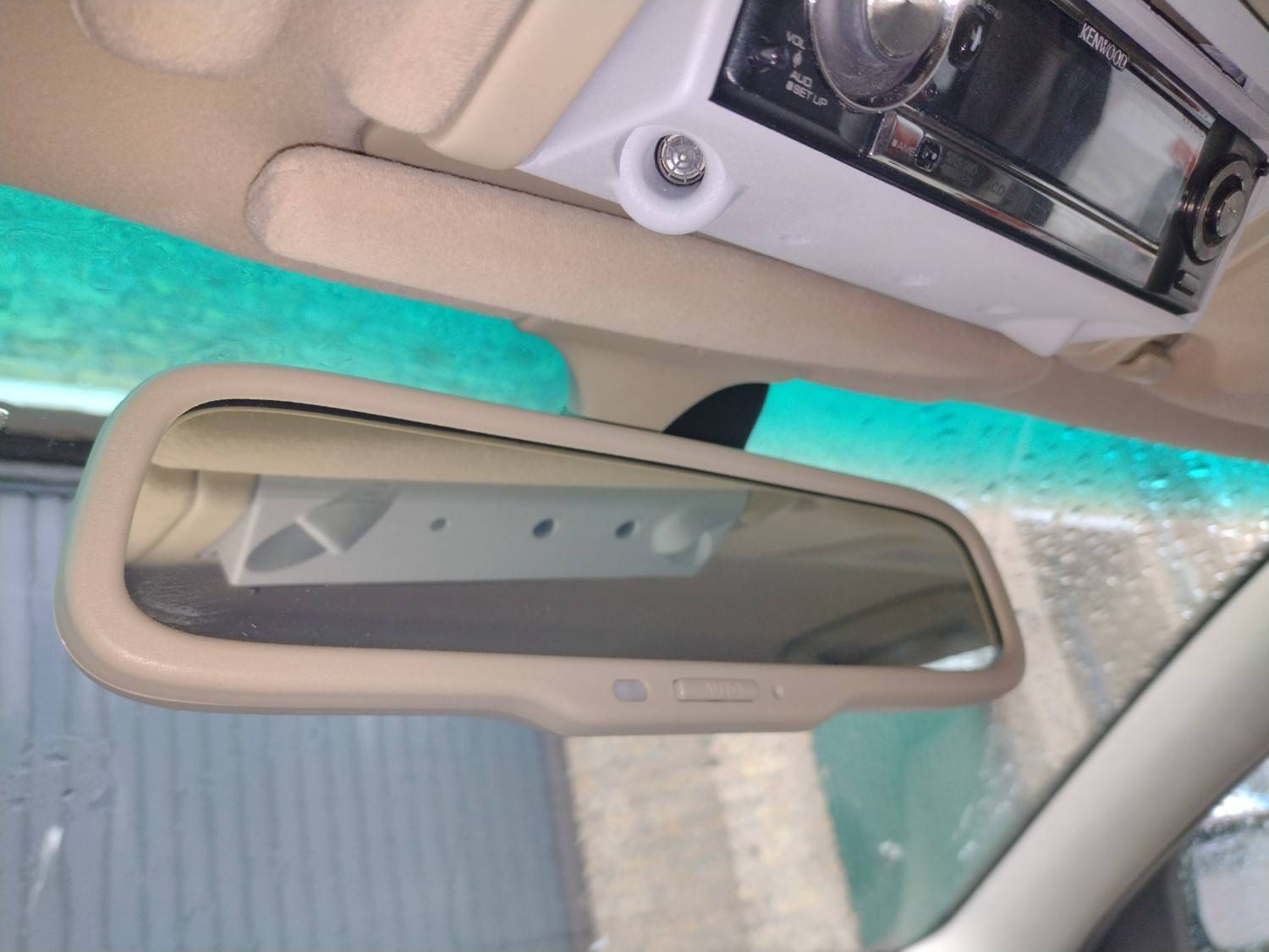

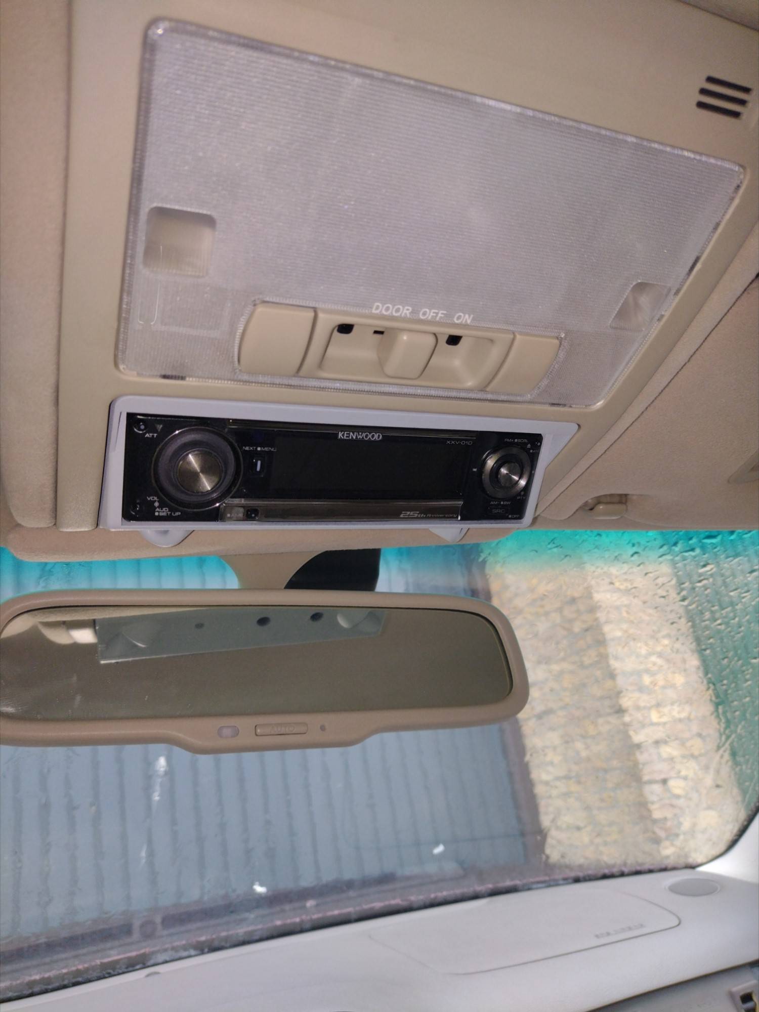

At the location where you normally store the sunglasses i will install the front panel of the Kenwood 1 DIN headunit.

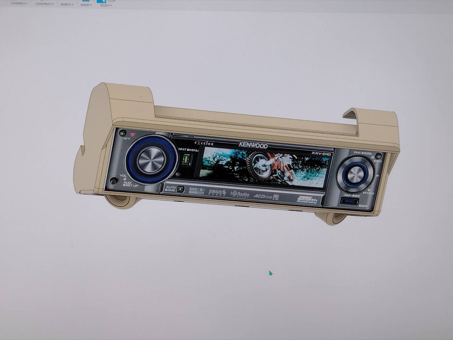

drawn a new housing in Fusion 360
painted the texture on the housing the same as the original plastic

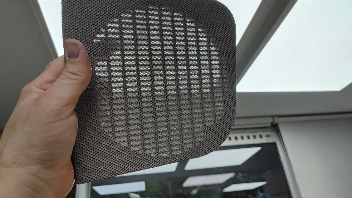

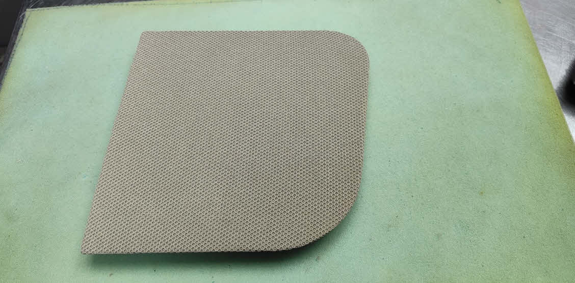

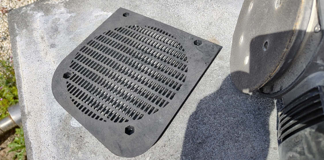

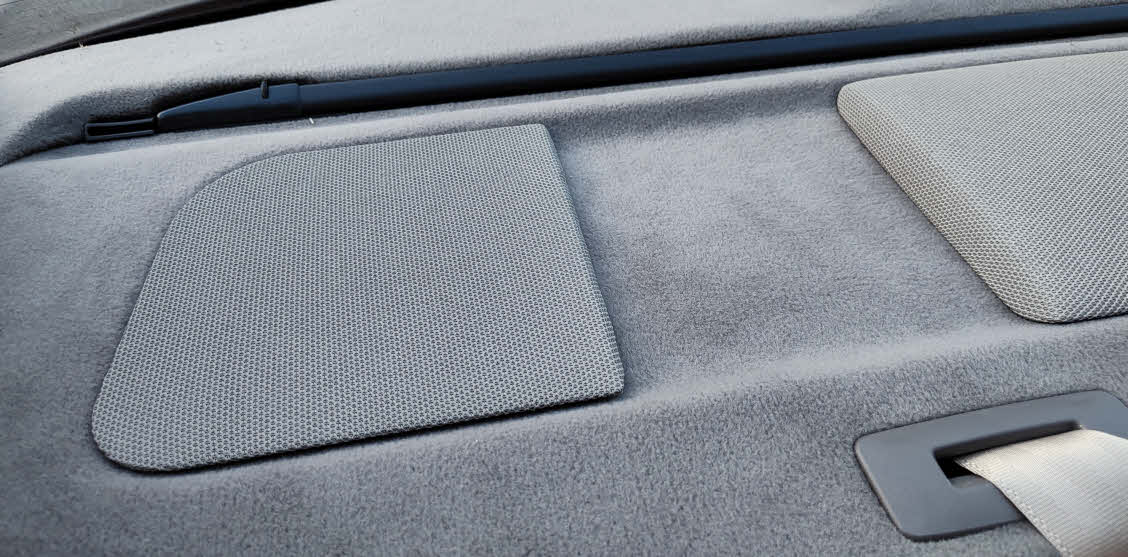

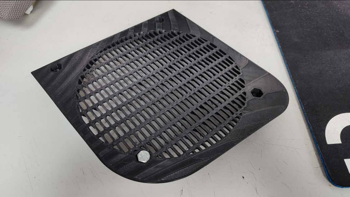

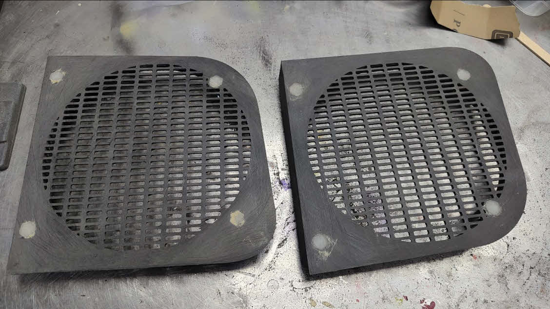

Since i will not be using the rear doors for the rear fill, i will fit the Steg MSS3 under custom made grills in the rear deck. I am making the grills to look like OEM. Picture 2 shows the original Subwoofer grill. I am making the new grill in the exact same way, and they will be upholstered with the OEM fabric for full integration.

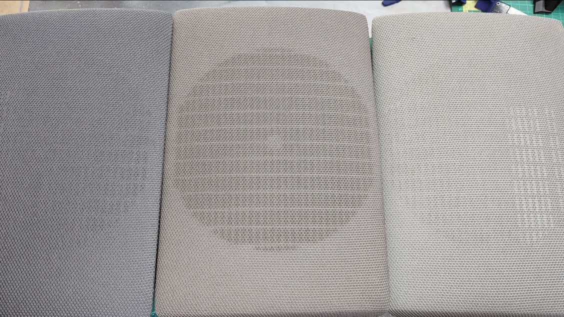

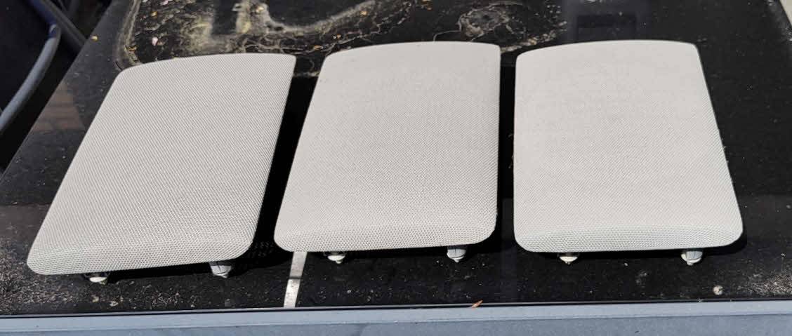

Bought two extra subwoofer grills for the fabric
painted the fabric the same colour
upholstered the new grill

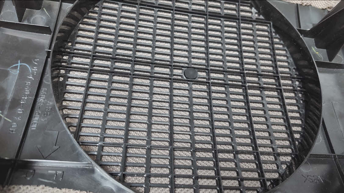

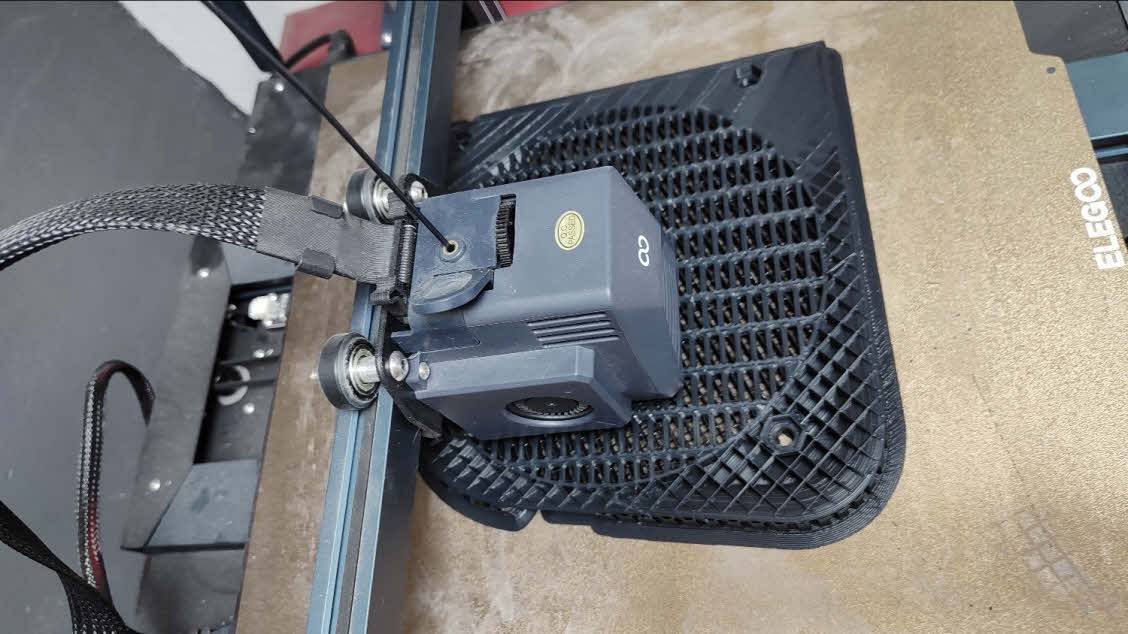

grill got the same pattern in the plastic as the OEM subwoofer grill

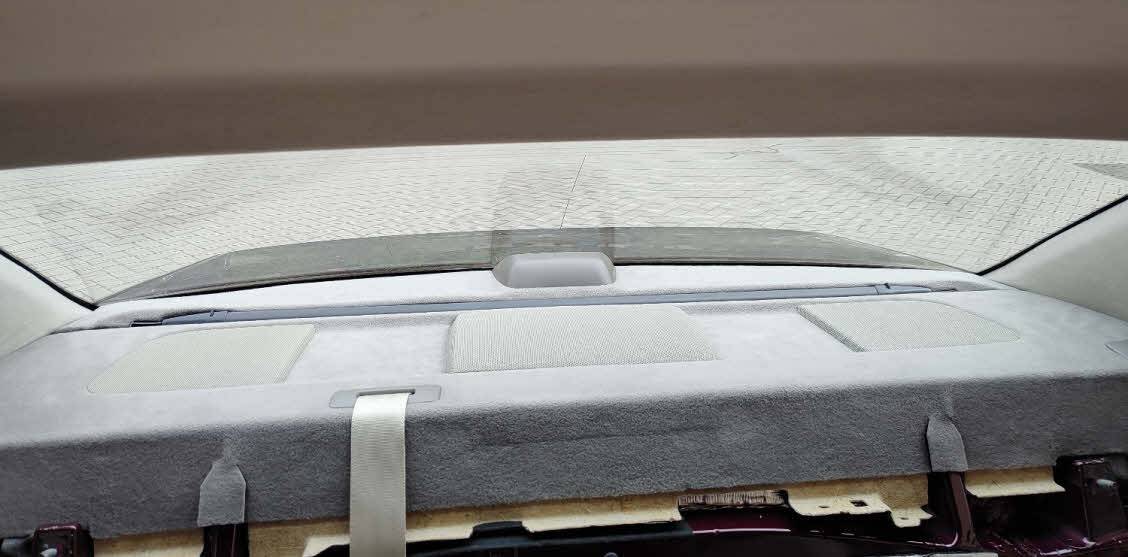

test fitting, the shape is perfect
bolted down to the rear deck. Now looks OEM

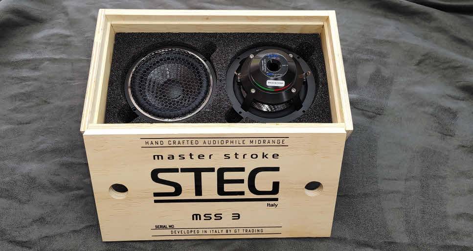

Front mid range speakers, which will be installed in the corners of the dashboard. These are Steg MSS3 10 cm.

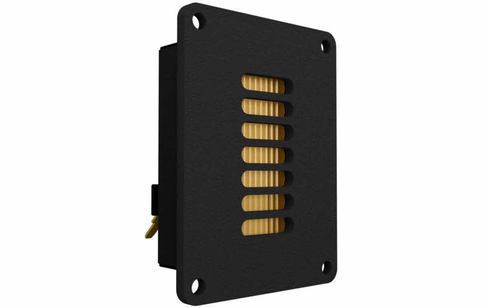

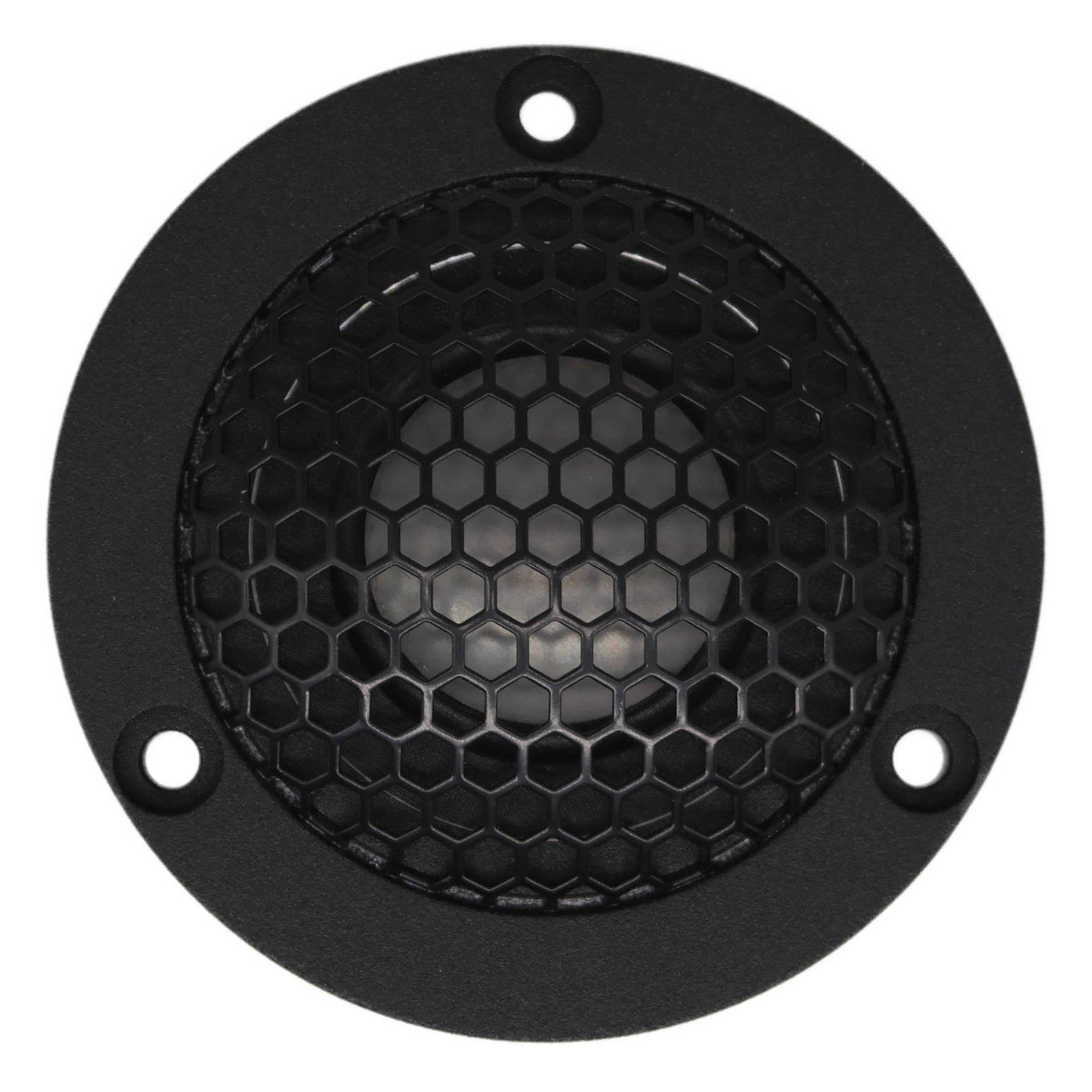

In the A Pillars i will install Mundorf AMTU60W1.1 Air Motion Tweeters.

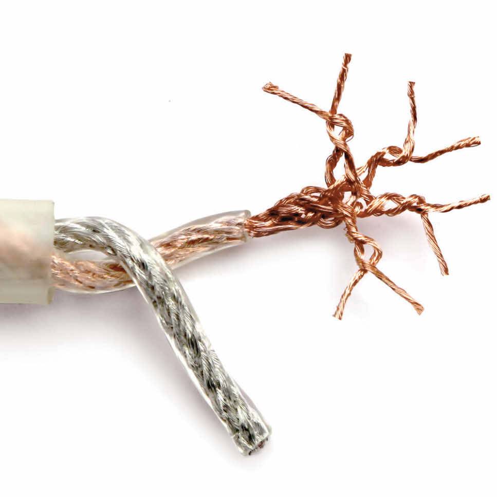

Speaker cables for the mids and highs will be Audison Sonus Reference.

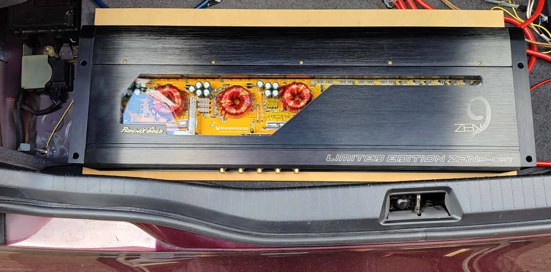

The amplifier which i will use is the Phoenix Gold Zen 9, it has 9 channels of amplification. I am one channel short for the front subwoofer, i will need to add a one channel amp for the front sub.

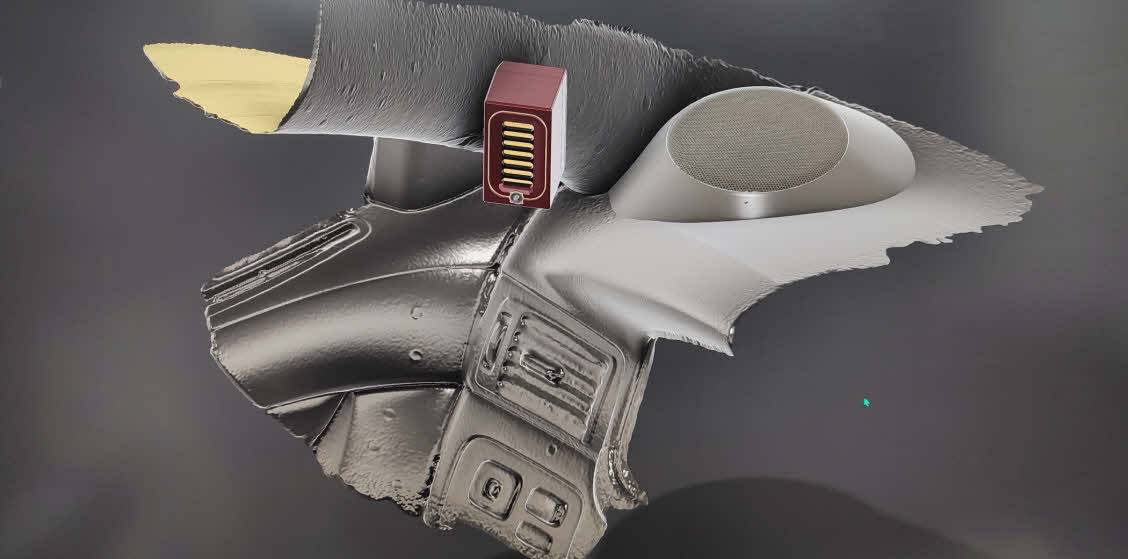

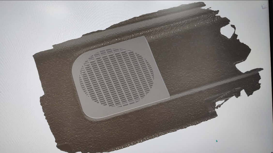

Interior was 3d scanned, the AMT will be installed in the A pillar, housing will be painted in the same colour as the car. The Steg will be venting in to the dashboard.
Careful with the Mundorfs.
AMTs have a great wide dispersion, but their vertical dispersion suffers greatly.
They need to be aligned almost perfectly at ear height, vertically, or you will encounter the "on/off" effect when moving your head around.
It's one of the main knocks on AMT/Ribbons, and why, even though they exhibit exceptional tonality. micro-dynamics, transparency, and almost non-existent listening fatigue, they are used much less frequently.
I have them in my home theater towers, and absolutely love them, but not sure I want to do what it takes to get them to perform optimally in a car/auto environment - especially at their nearly $800-$1100.00 a pair price/cost.
Considering you're in Europe, consider a good berylium, like the BlieSMa T25B-6, Scan-Speak, or the SB acoustics beryliums as they are in the same league as the Mundorfs, sound amazing (close to or as good in my opinion, as the Mundorfs).
These are worthy options:
No thanks, because mine will be installed the correct way! I also am a Mundorf dealer myself.
