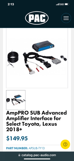

I’d personally get something like this module (pac interface) direct plug and play and you take the flat signal before the amplifier then all of your amps will have the same signal then just adjust the lpf/hpf on each. Also won’t have to butcher your stock wires. In my 2021 Malibu I used this because the signal from the doors is already amplified through the stock amp in the trunk and sounded distorted also heard people getting an amplified door chime as well and changing head units was not an option.
