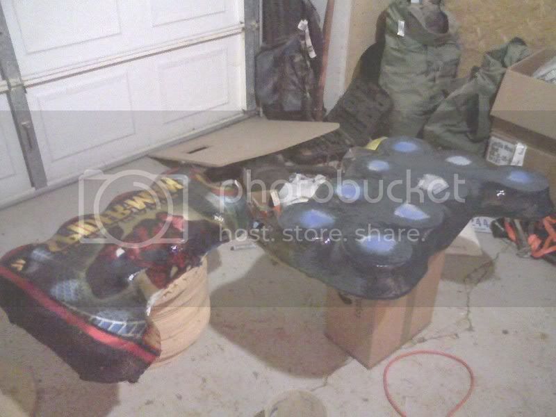

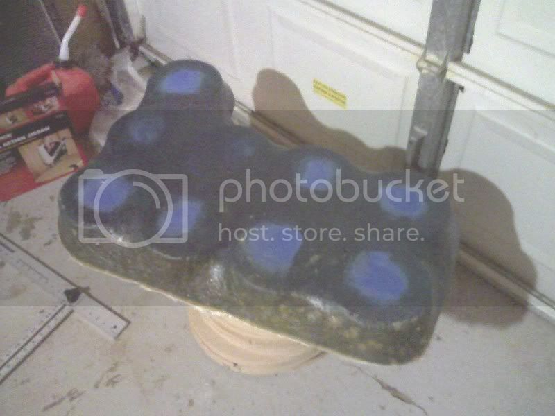

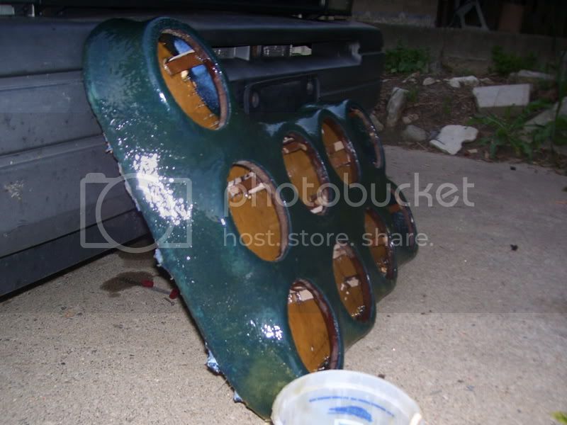

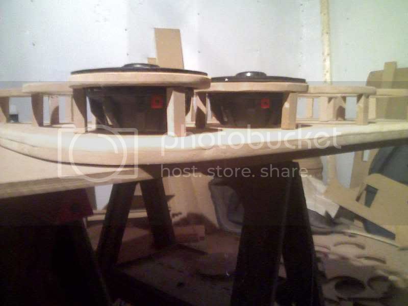

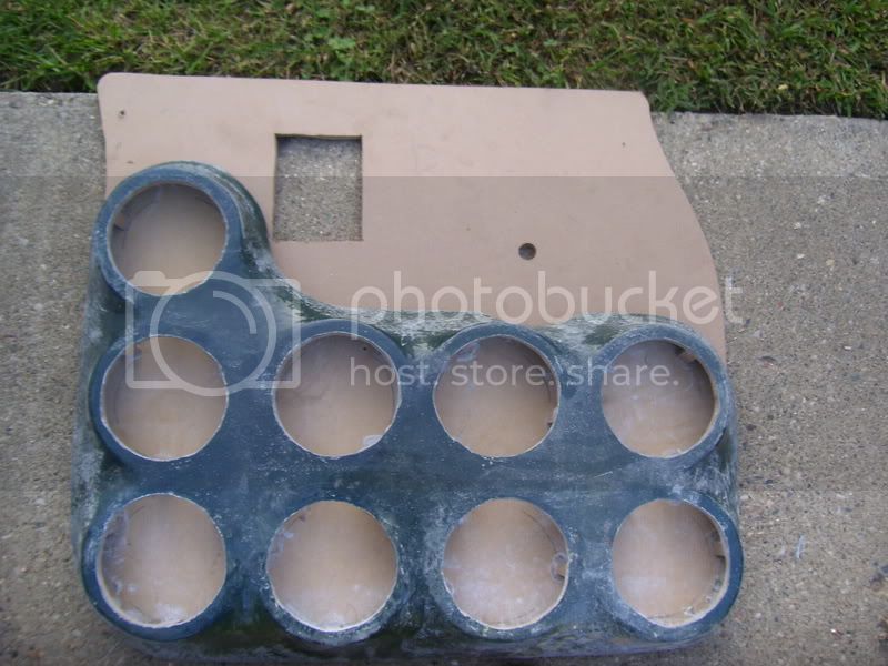

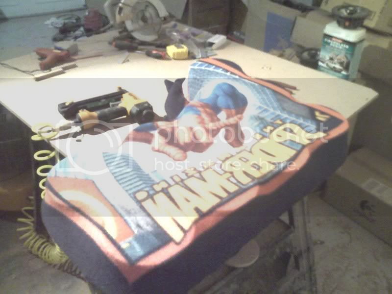

was cheaper fleece at the fabric store so i bought it. ordering my 7 other pair of 6.5's and a pair of 5.25's tomorrow and should get them on thursday. im gonna fiberglass a pair of 5.25's in my A pillar
