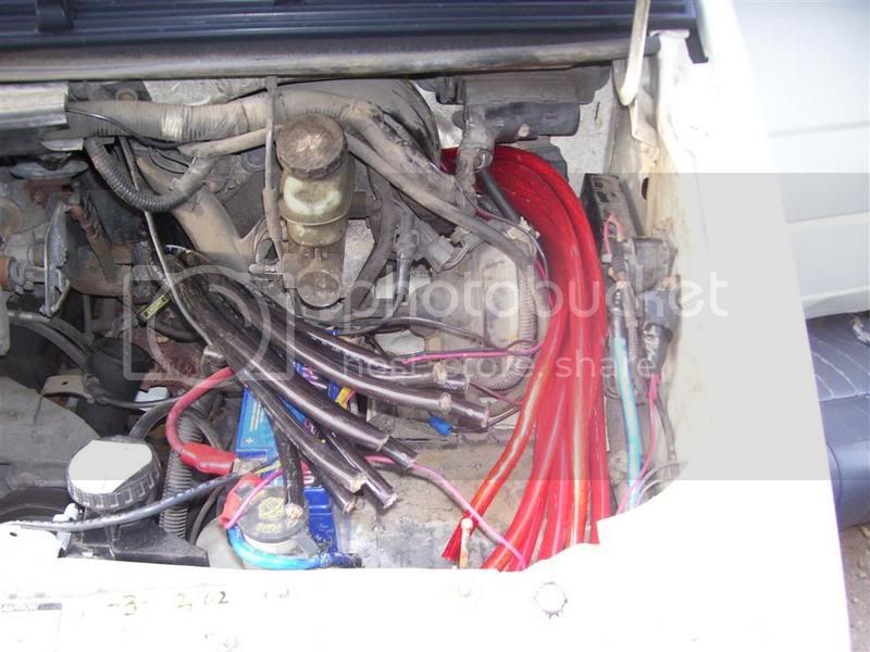

bank has never been charged and is sitting at 16.3v. buying a charger next week. and hopefully get all the grounds ran and get my last battery. took the one under the hood out to finish the back bank now waiting on my last battery so i can finish the busbars and crimp and run everything from front to back. then install the stepdown module.
just a quick update.

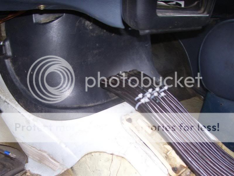

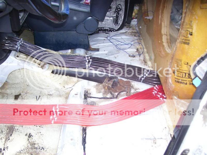

finished running all my wires for the final time. finally got them how i wanted.

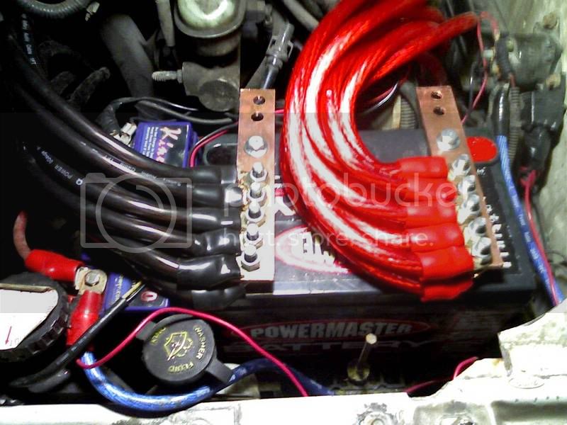

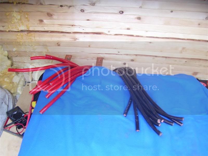

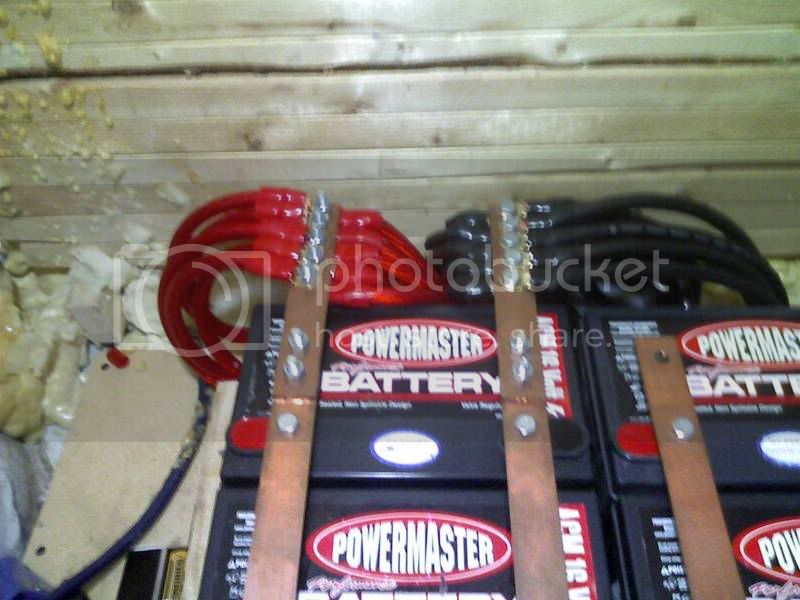

now for the ghey part..... crimping....
yah i started..... did 3 then quit haha. actually i have to drill out all the crimps cuz the hole is too small. so i did that but did 3 then stopped.... need to get a real crimper...
You should put the positive on one end of the batts and the neg on the other end of the bank. Or spread it out evenly. Honestly I dont know why you used all that wire. It's not a street and streetmax setup. Looks good though.
