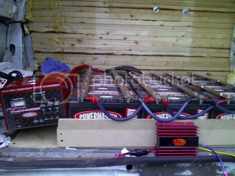

i would recomend doing more connections between the rows on the batteries. the way you have it now that 1st battery will always be charged and the last few will eventually not get any charge and die all the way, killing the rest of the bank.
since your not finished in the back yet maybe you have thought about that, but i figured i would bring it up.
i do take advice and i have just not got that far. so chill out. been workin on other things. i dont base my life around this van. i work on it from time to time. look at the busbars. why do u think i made the holes on the back side?????? so i could connect them as well.. im not a nub. just ran out of crimps.

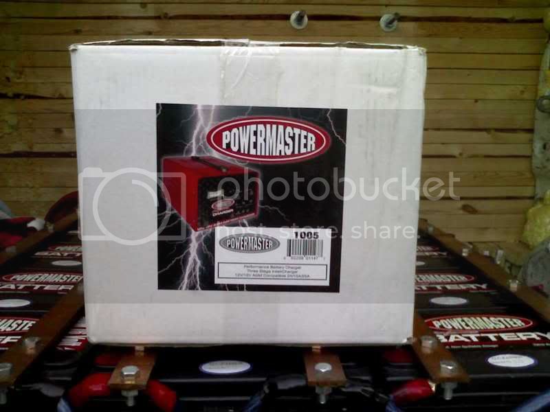

mmmmmmmm charging system almost complete. lookie what i got in the mail today......
got powermaster?

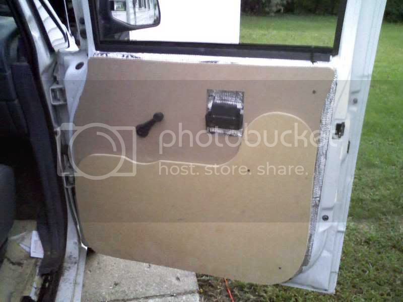

oh and door updated... passenger and driver are the same. just forgot to save the pic of the driverside. this is just so u can get an idea of what its going to look like. still have ALOT of work ahead of me on the panels...
