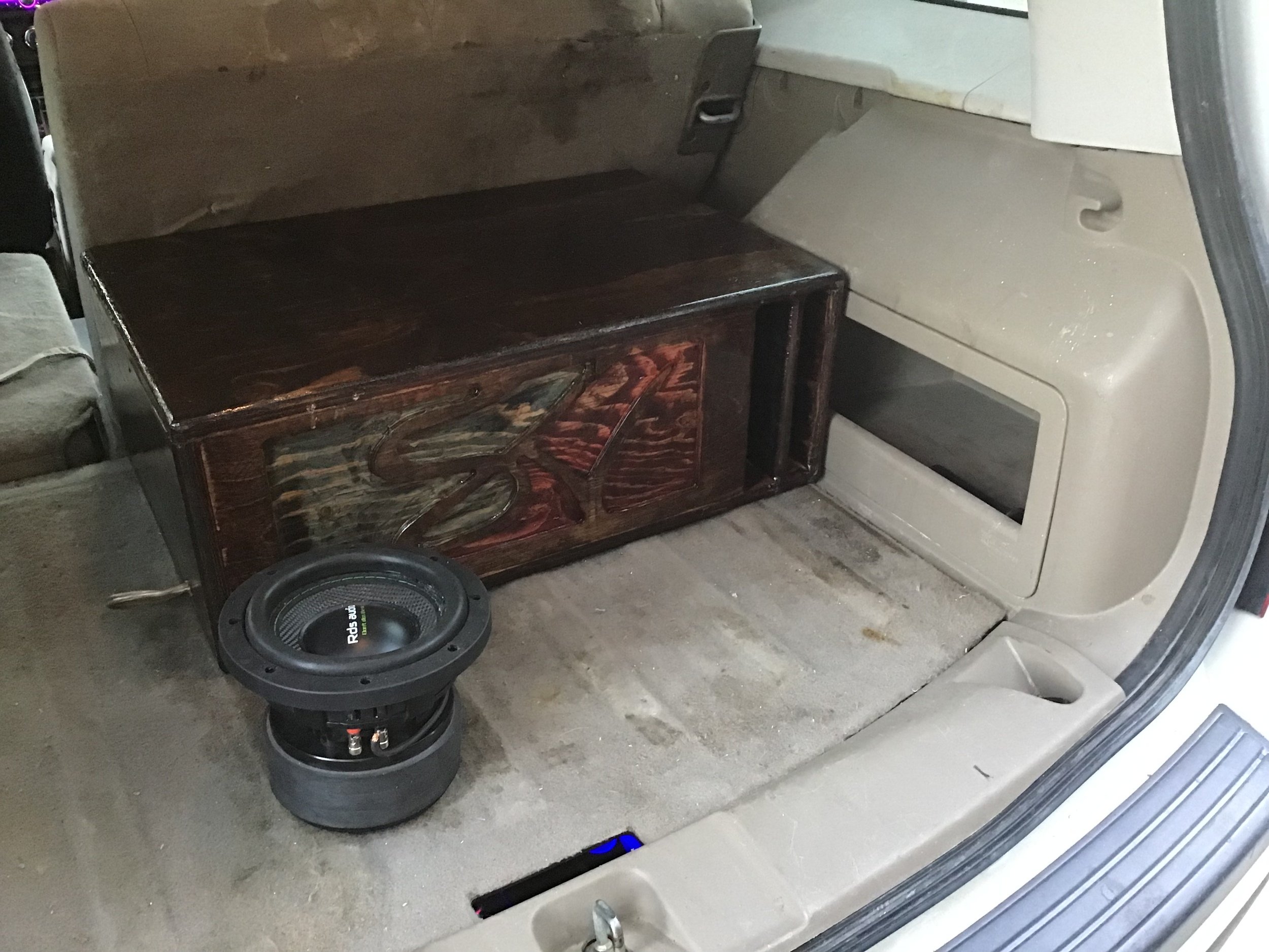

A 6th order won’t really be a small footprint no matter what sub is used. I like 6th orders and use them often, but they can’t beat a good sealed box with a proper sub in terms of footprint. This is one i did for a 6.5 inch sub. About the same as a single sealed 12 would be. .5 cubes 35 Hz and .3 @ 64 HZ if I remember correctly.

Great looking enclosure, do you have a write up on it?

I’d have to go through my rats nest stack of paper blueprints. I haven’t switched to digital prints yet. Ive thought about trying a shallow mount 6th order for a single cab truck, since the seat is pushed right against the sub with a normal box, but I haven’t tried it yet.
