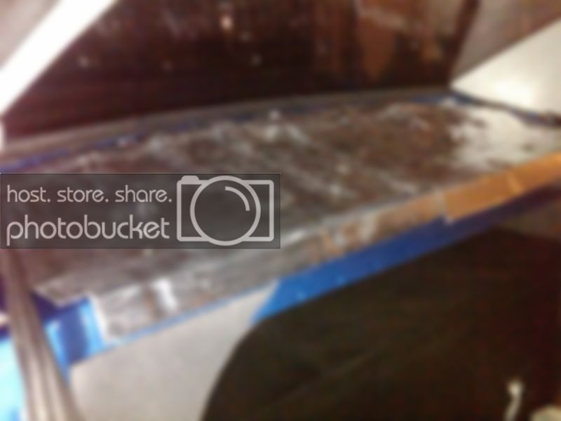

As I said above I had 8 cans of Cascade spray deadener so I used that for the rear doors and to fill some smaller voids in the trunk lid.

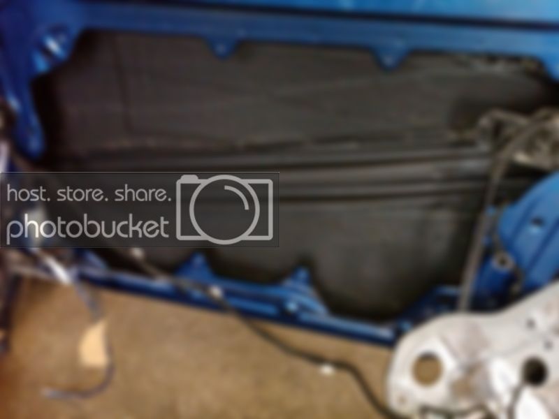

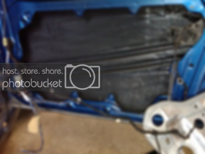

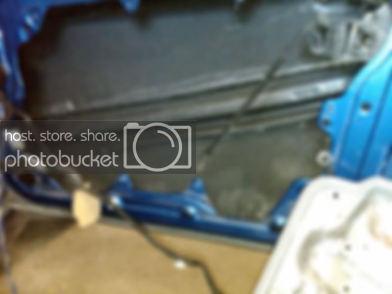

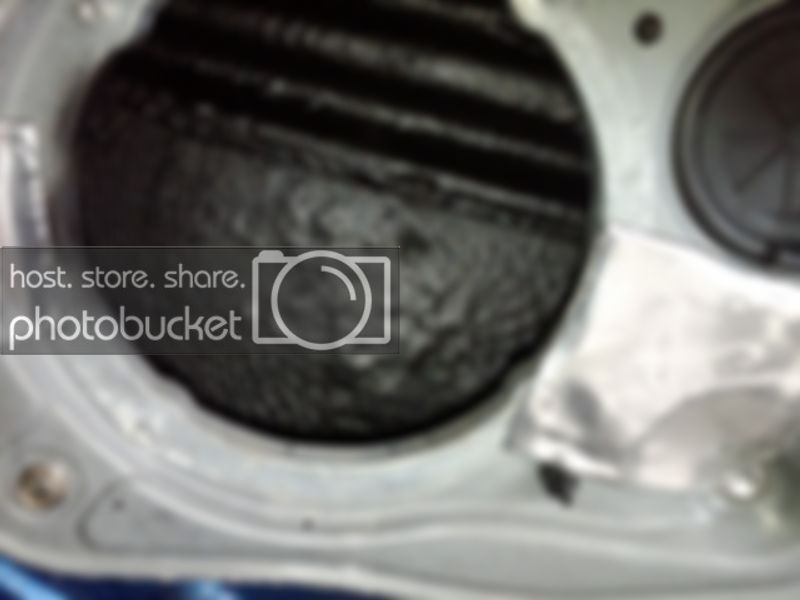

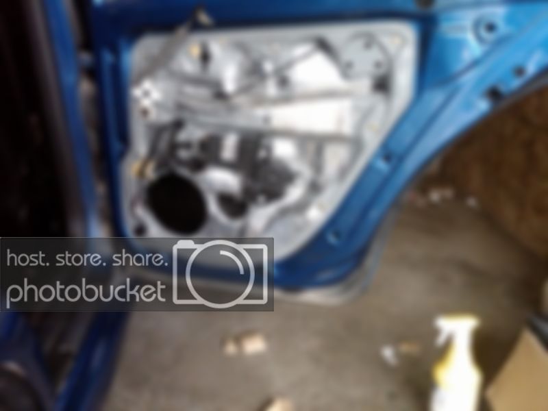

The entire inner door has 2 cans in each. I still will put OKP on top of that to stop unwanted outside noise. You can see what it looks like through the old comp hole.
I also used Damp pro on the inner door skin. Prob a waste since no speakers are there but it did quiet the window motor and stuff down for sure. The doors feel rock solid already.

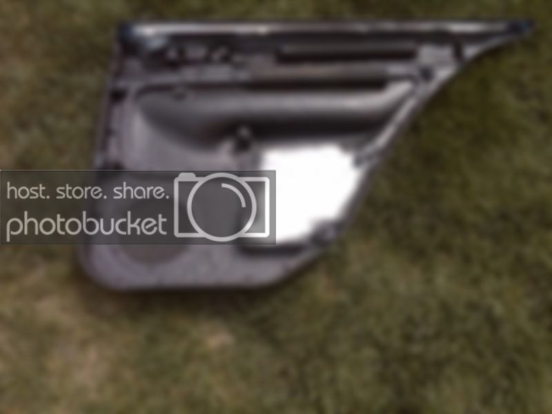

Since I had 4 cans left over I used 1.5 roughly on the door cards also.. I figures what the hell could it hurt.

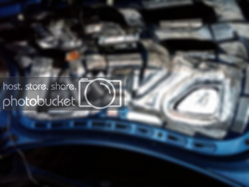

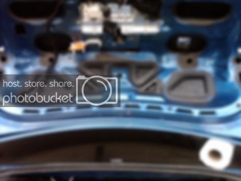

Here is a pic of the trunk lid. I screwed up and forgot to take a pic after doing it all in Damp pro. I still might put some OKP over the Damp pro between the factory deck lid cover.
Here is the rear deck lid. I did not take a pic from the trunk showing the underside all done in damp pro but it is.

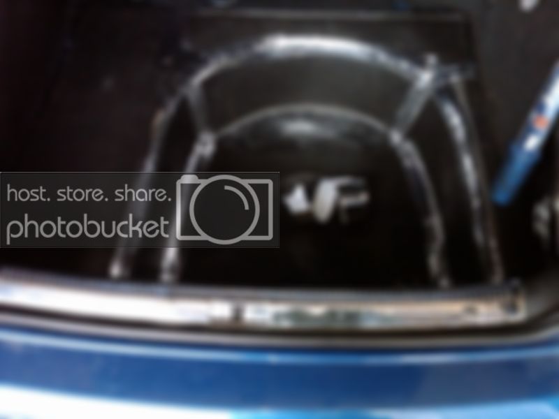

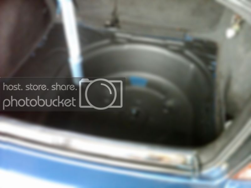

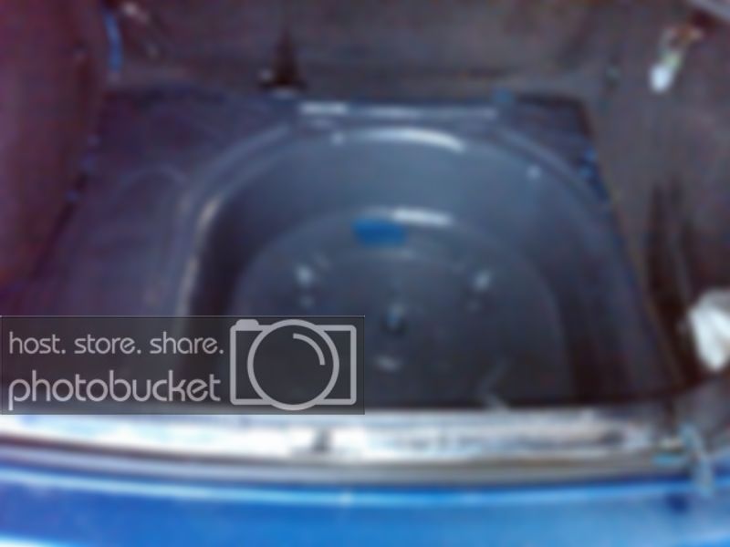

Here are some more pics from last night and this morning. I started putting spectrum in the trunk and also the front doors over the 3 layers of deadener in the fronts already there. Turned out I got asphalt based for the fronts even though they told me it was butyl so I thought I would enclose it in spectrum and also overlap where the deadener wasn't to make sure it does not fall down in my **** doors. Here is the first coat pics. I will be doing to sides of the trunk later this weekend or next. I also have LLP to put on the entire trunk floor and OKP going int he fronts and rears and a few other places. I will also spray the bottom with spectrum prob do 3 layers on that also. Then I will do a few layers on spectrum bruched in the wheel wells.
first layer
second layer cured overnight.
third layer this morning.
here is the first layer cured on the inner door.
Third coat on the inner door.
The spot that does not have any sepctrum is where I am going to ground everything. I will then cover it in spectrum.

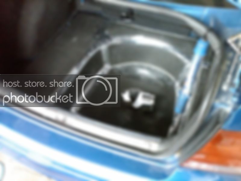

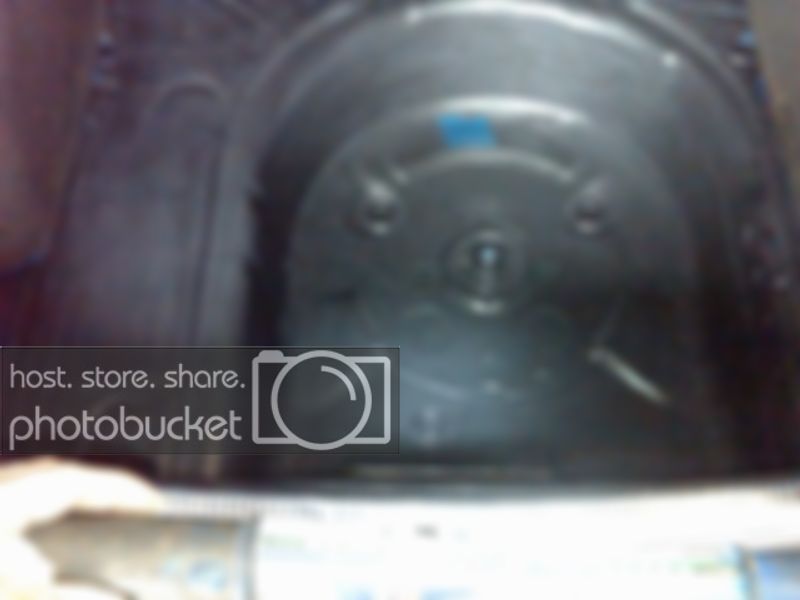

I agree and TY. Well I blew my load early and installed the LLP in the trunk over the spectrum and the OKP in all 4 doors. Looks like I was supposed to wait 30 days before doing this LOL. I waited 30 hrs opps. Here are some pic sof the trunk pan and the trnuk lid and front door with OKP.

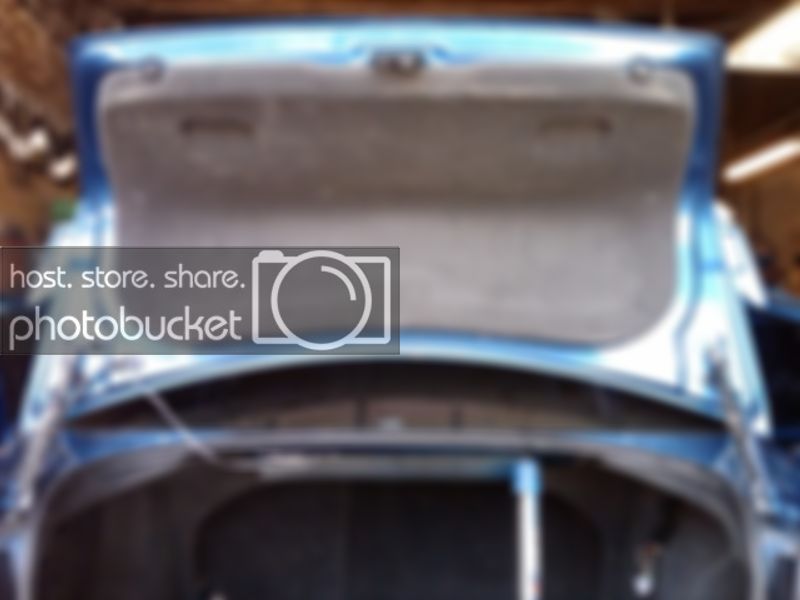

Here are some pics of the trunk deck lid. I added more damp pro to it and forgot to snap a new picture.

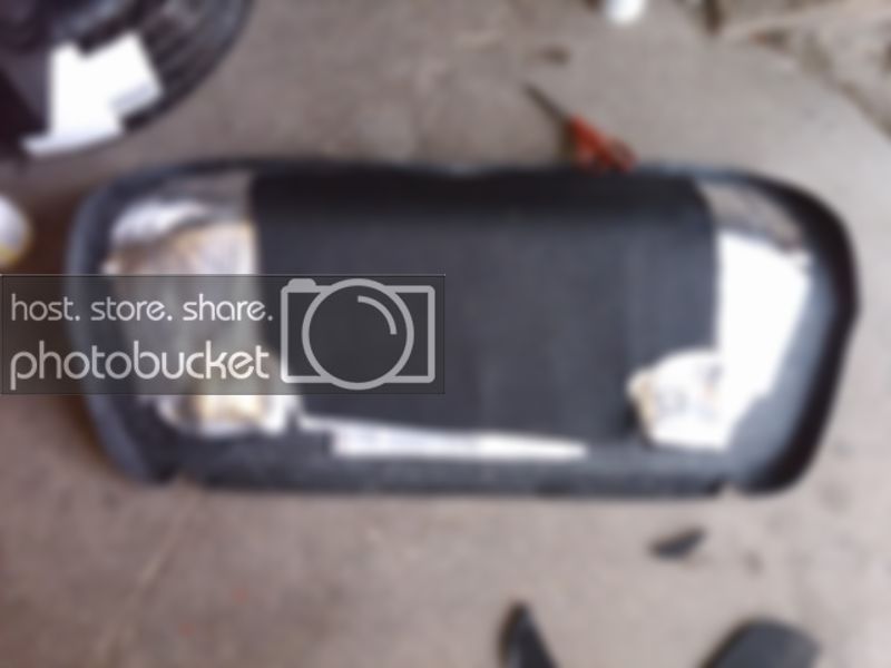

Here is the liner that covers the trunk deck lid. I covered it all in OKP but was just showing the first piece of it as I had a spare piece fromt he doors left over.
