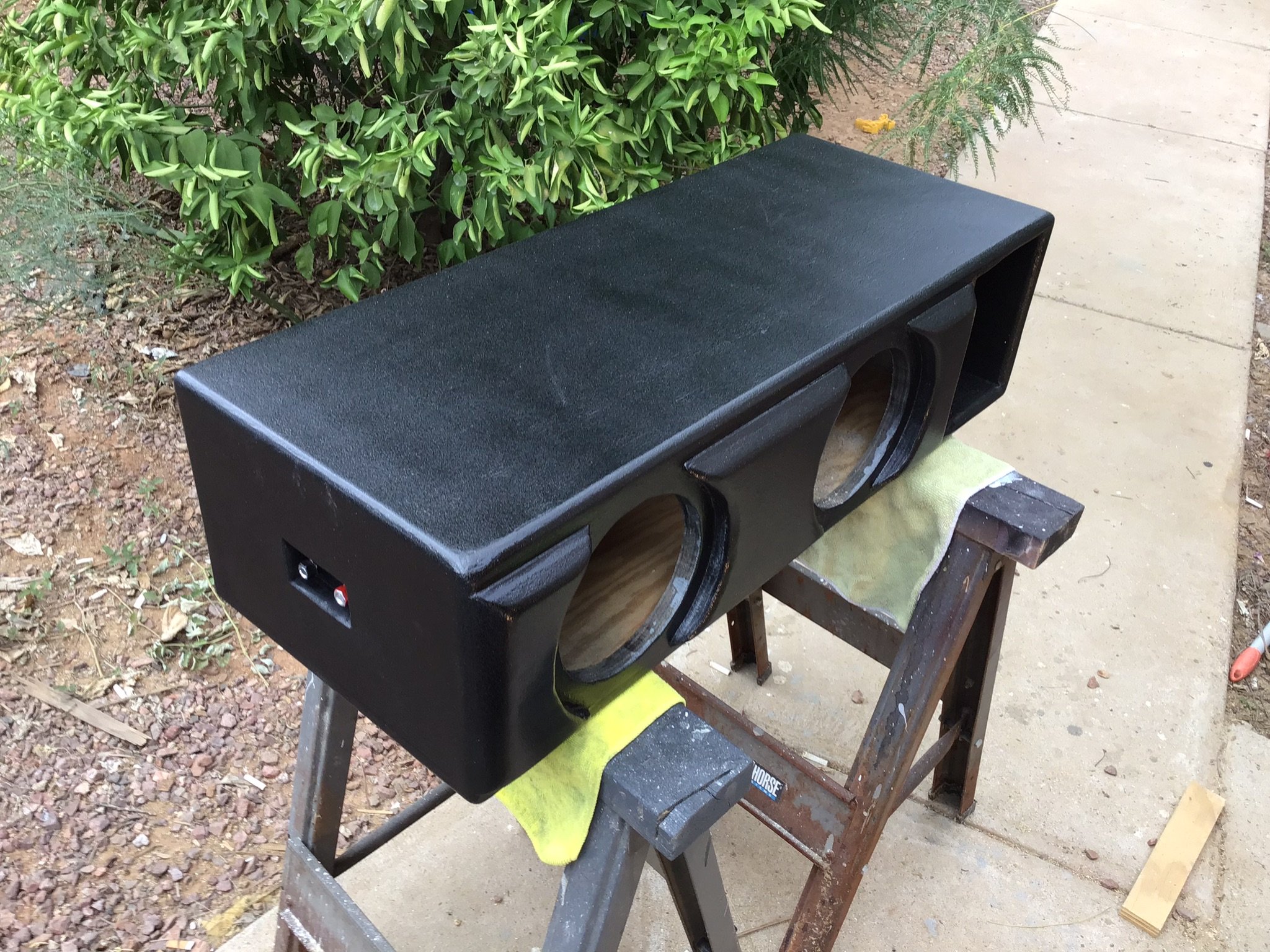

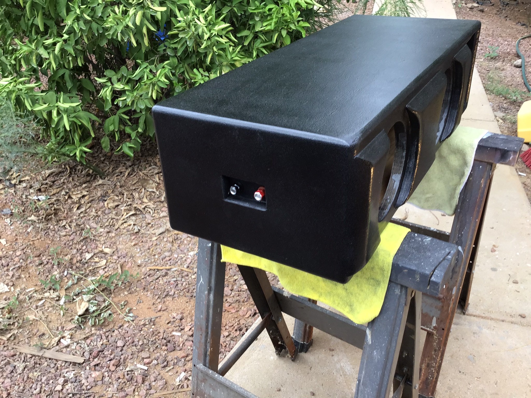

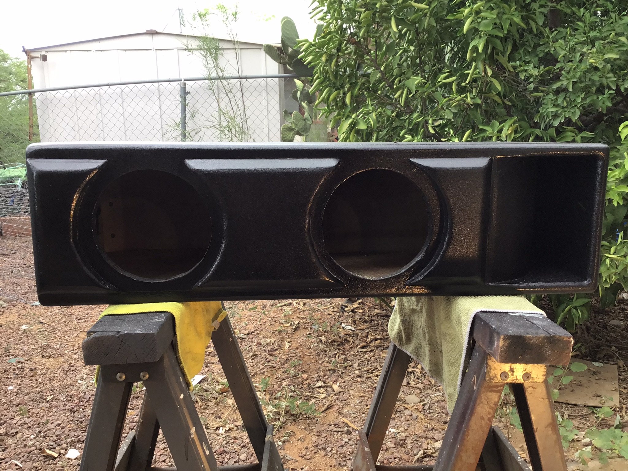

I’m screwing around with radiators now. I have my little 8 inch in a radiator box using 2 10 inch radiators tuned to 28 HZ. A more traditional way of doing this is to use a single 12 inch radiator. This 8 Im using has a ton of xmax, but most 8s could get away with using a single 10 inch radiator. 4 8 inch subwoofers and 2 12 inch radiators would be a cool setup. Air space and weighting for radiator setups can be done a couple of different ways. A sealed box air space size with a really low tuned radiator (25 HZ or so), or a ported box air space size with radiators tuned at a more traditional 30-40 HZ box tuning. What I really like is being able to tune a small box to a super low tuning without the giant port or any port noise. I’m ordering dual 12 inch radiators for my single 15 to play with next.

Wow, those are some creative sub grills!
