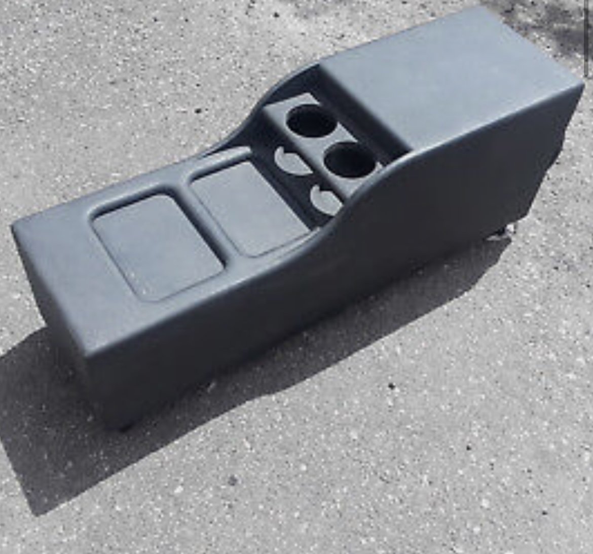

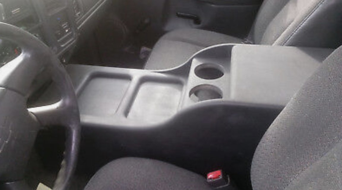

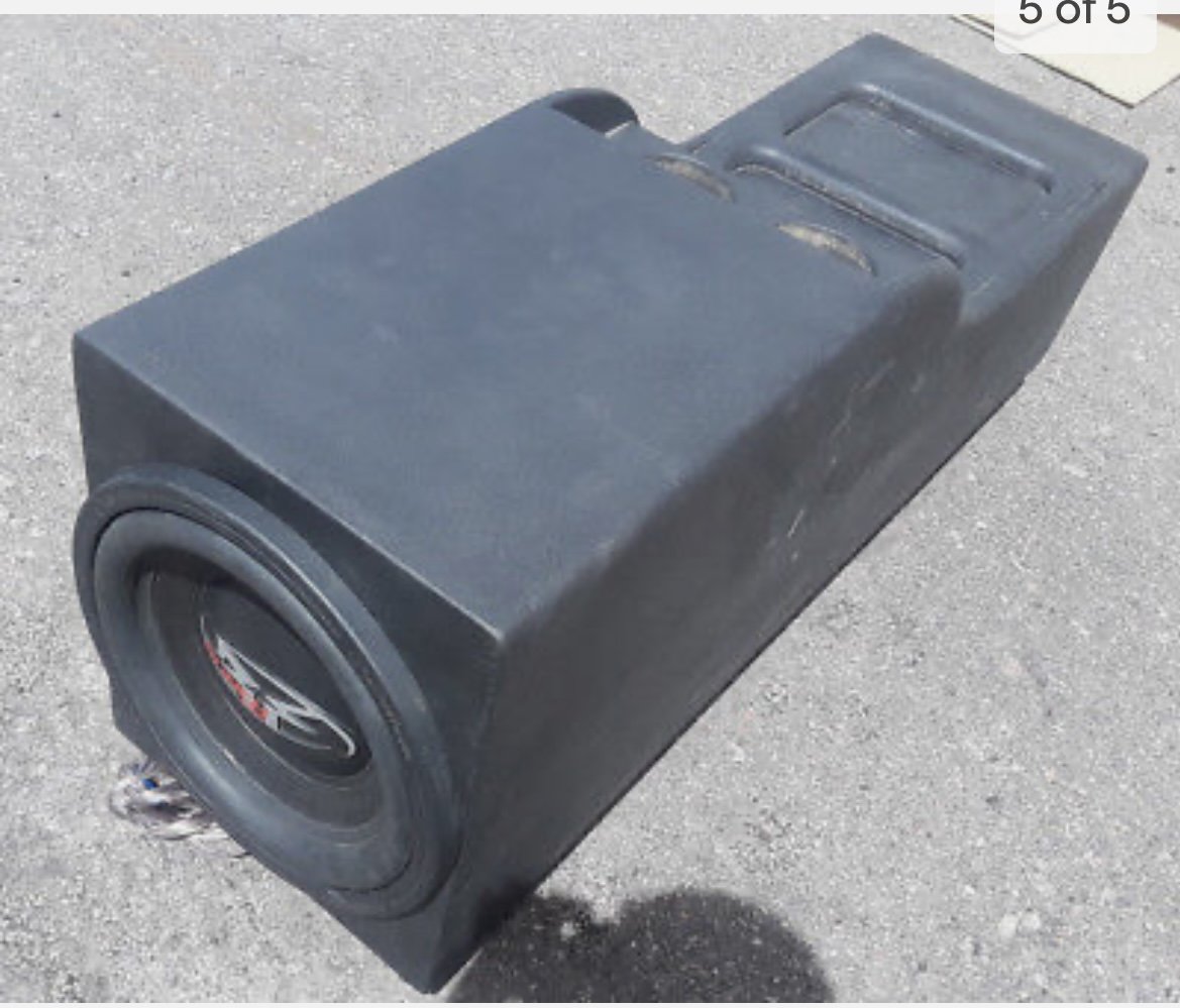

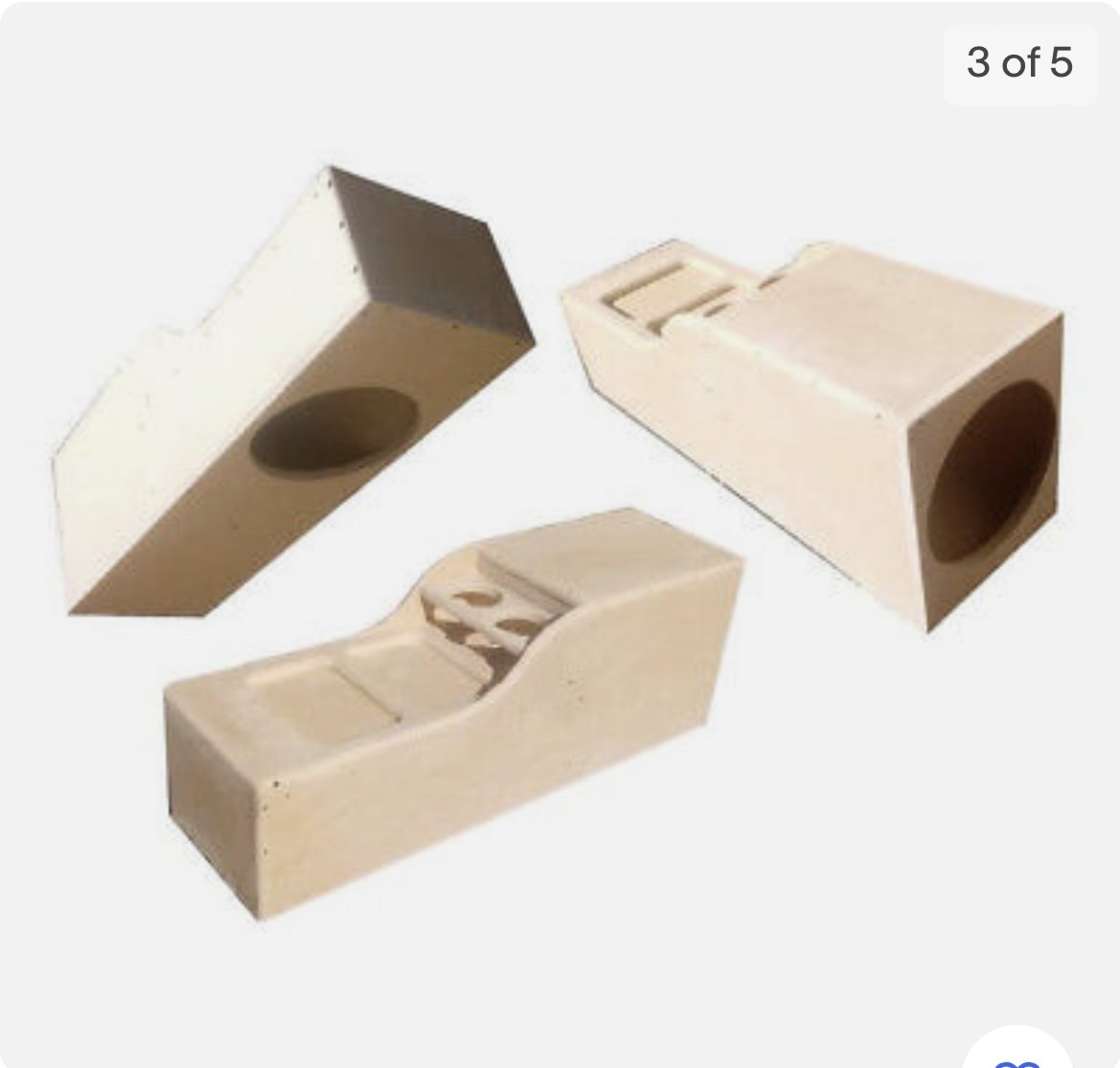

Ok, I’m pretty much sure this is what I’m going with. Someone is selling plans to make this box but I think I’m capable of making it without the plans. I will build my box according to what air space I need and add in additional pieces. I think the visual is all I need, I hope,lol. Not sure where I’ll face my subs but I’ll figure it out.
Ok, I’m pretty much sure this is what I’m going with. Someone is selling plans to make this box but I think I’m capable of making it without the plans. I will build my box according to what air space I need and add in additional pieces. I think the visual is all I need, I hope,lol. Not sure where I’ll face my subs but I’ll figure it out. View attachment 43526View attachment 43527View attachment 43528View attachment 43529
Nice!! Hopefully whatever sits in the Cup rest has a lid on it.. LOL. Looks Nice
