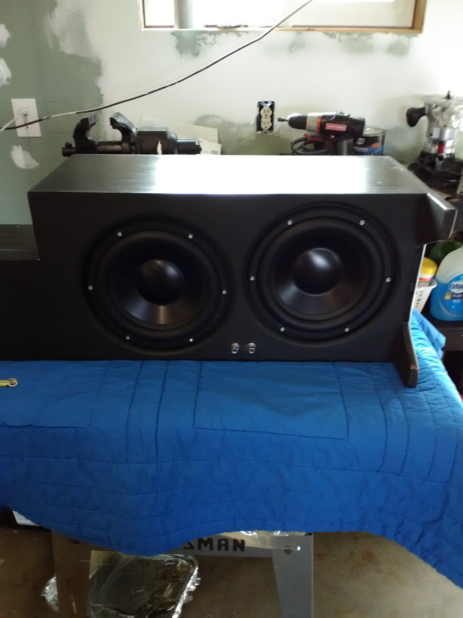

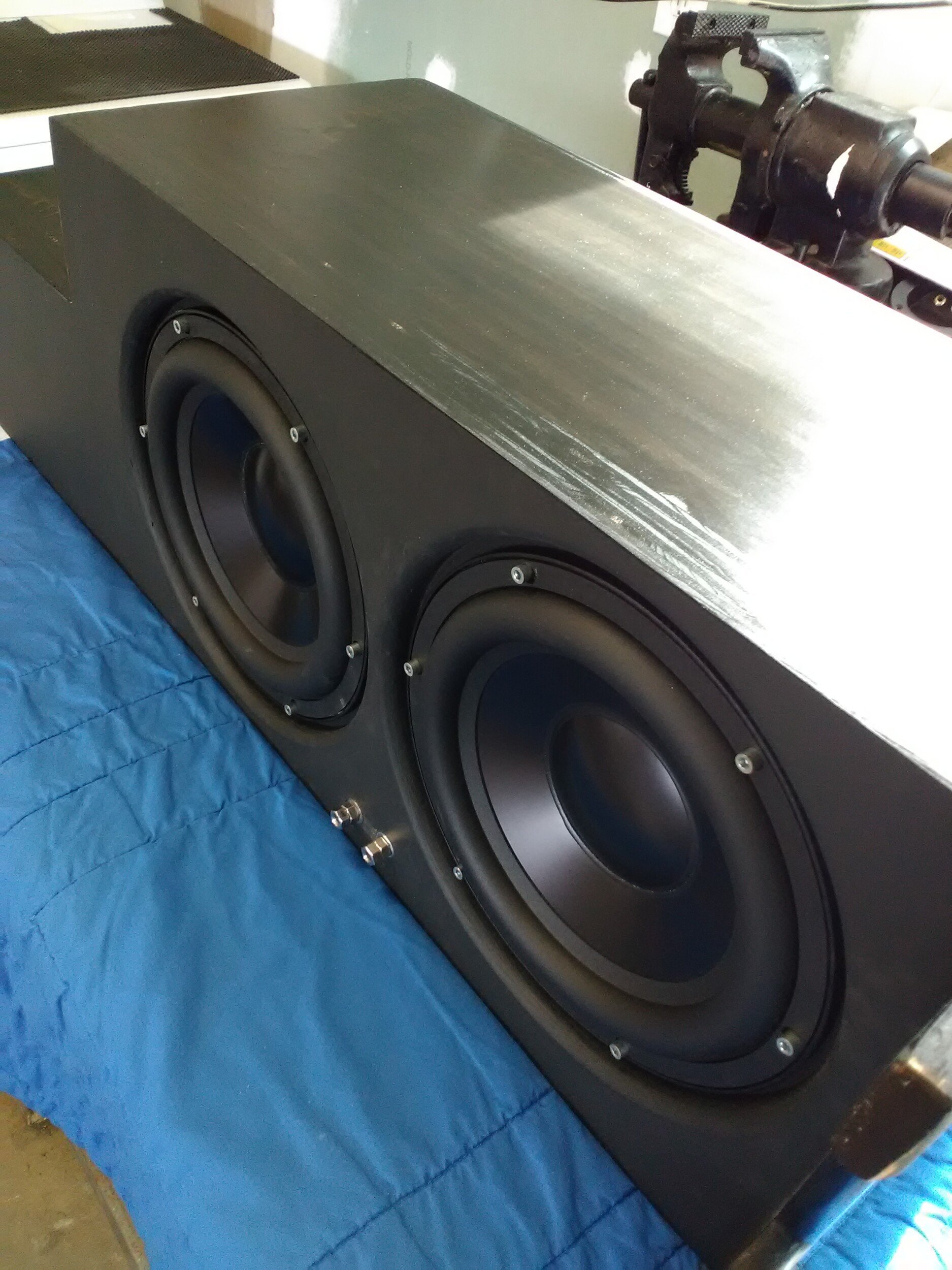

Nice! Please. Share pics. I tried a doenfiring setup once but it was half @assed. Didn’t put much effort into it other than the nice box that @Buck designed. I should have put more time into it.
two 10’s in that small of airspace?

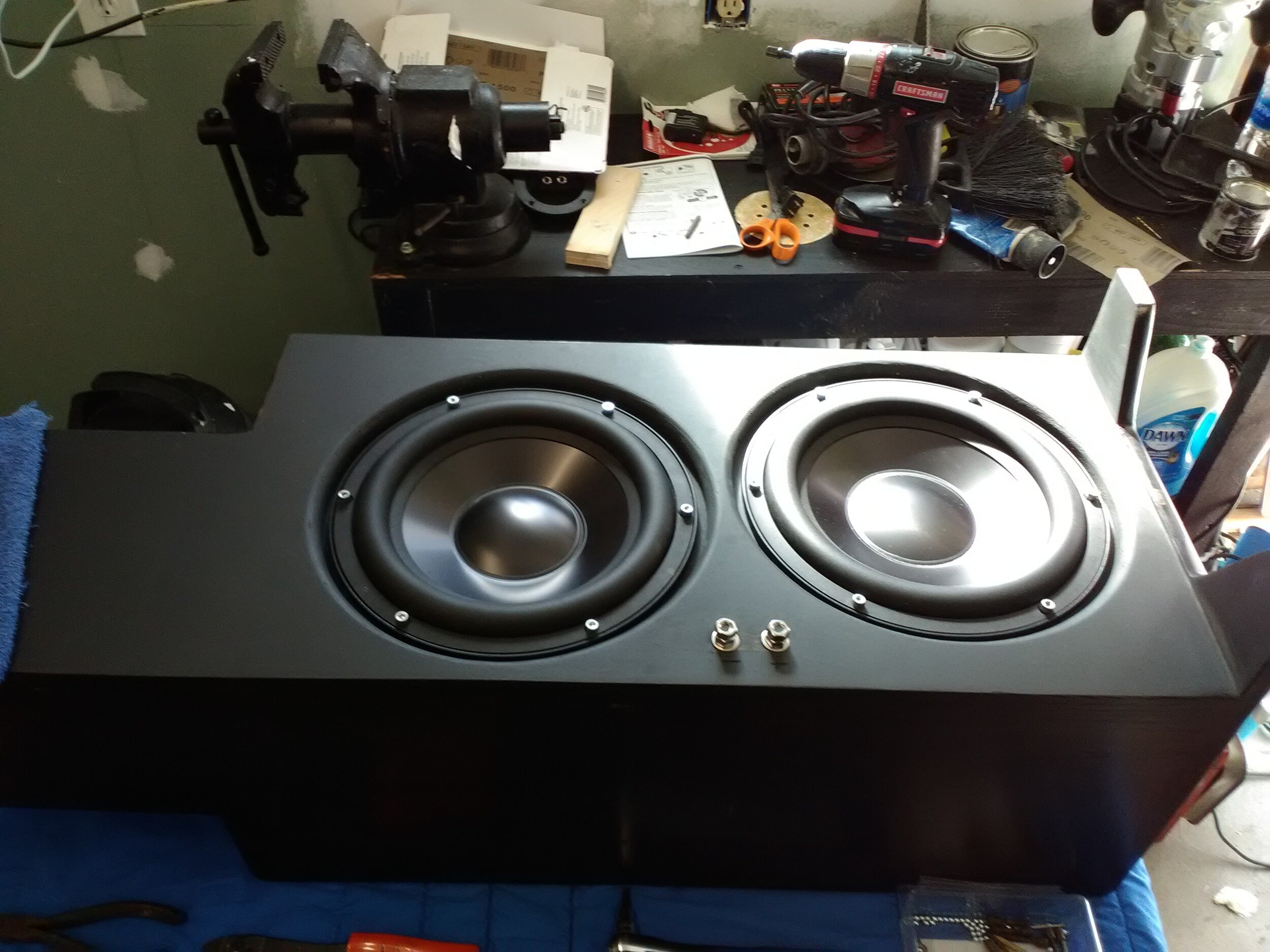

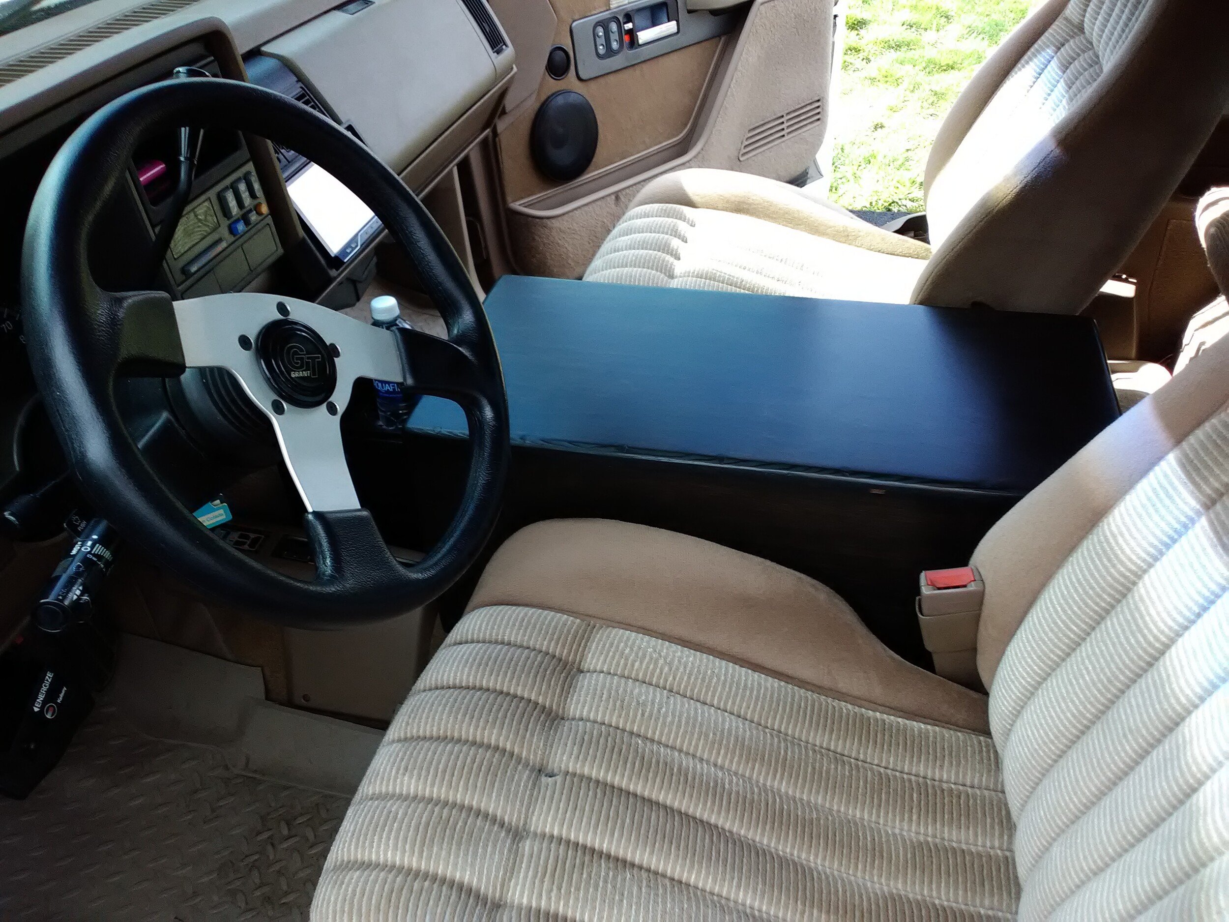

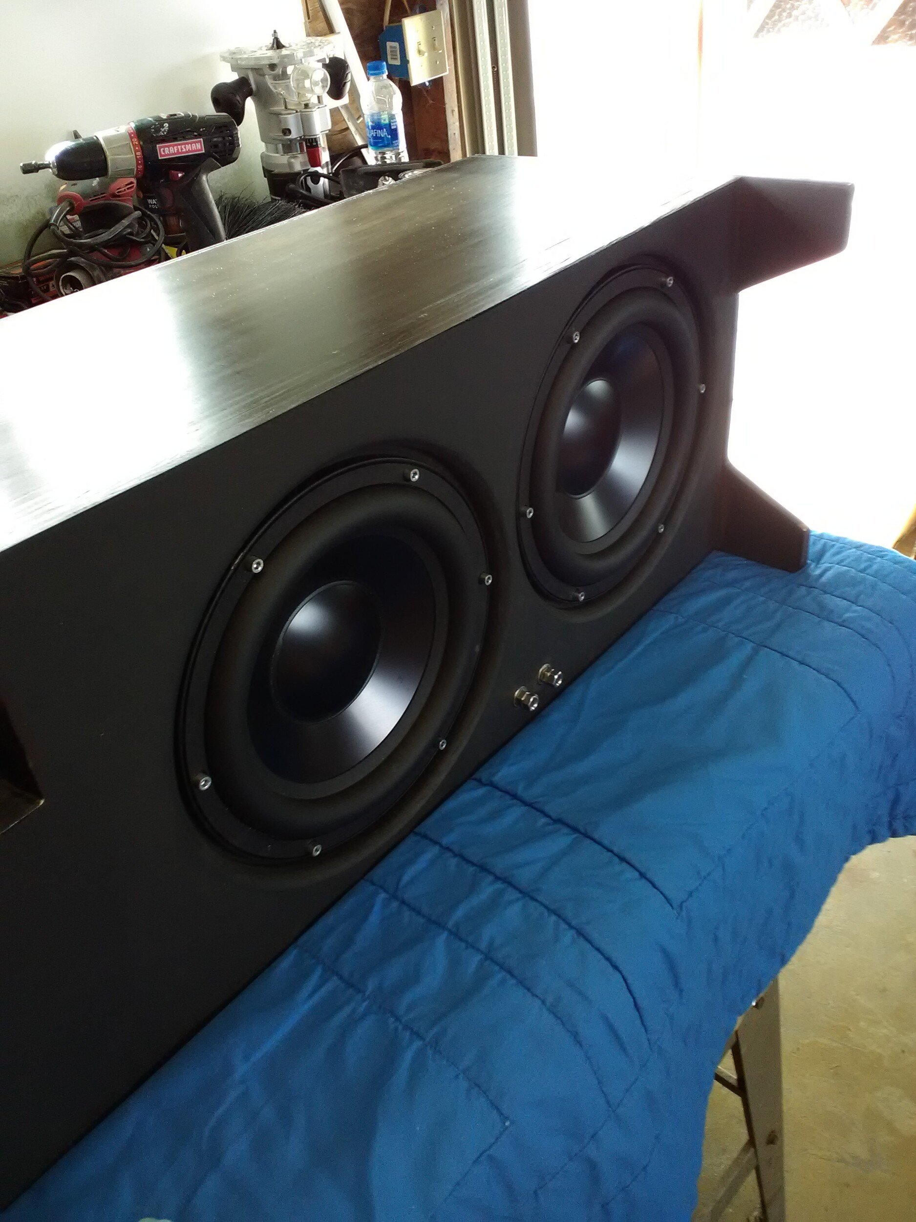

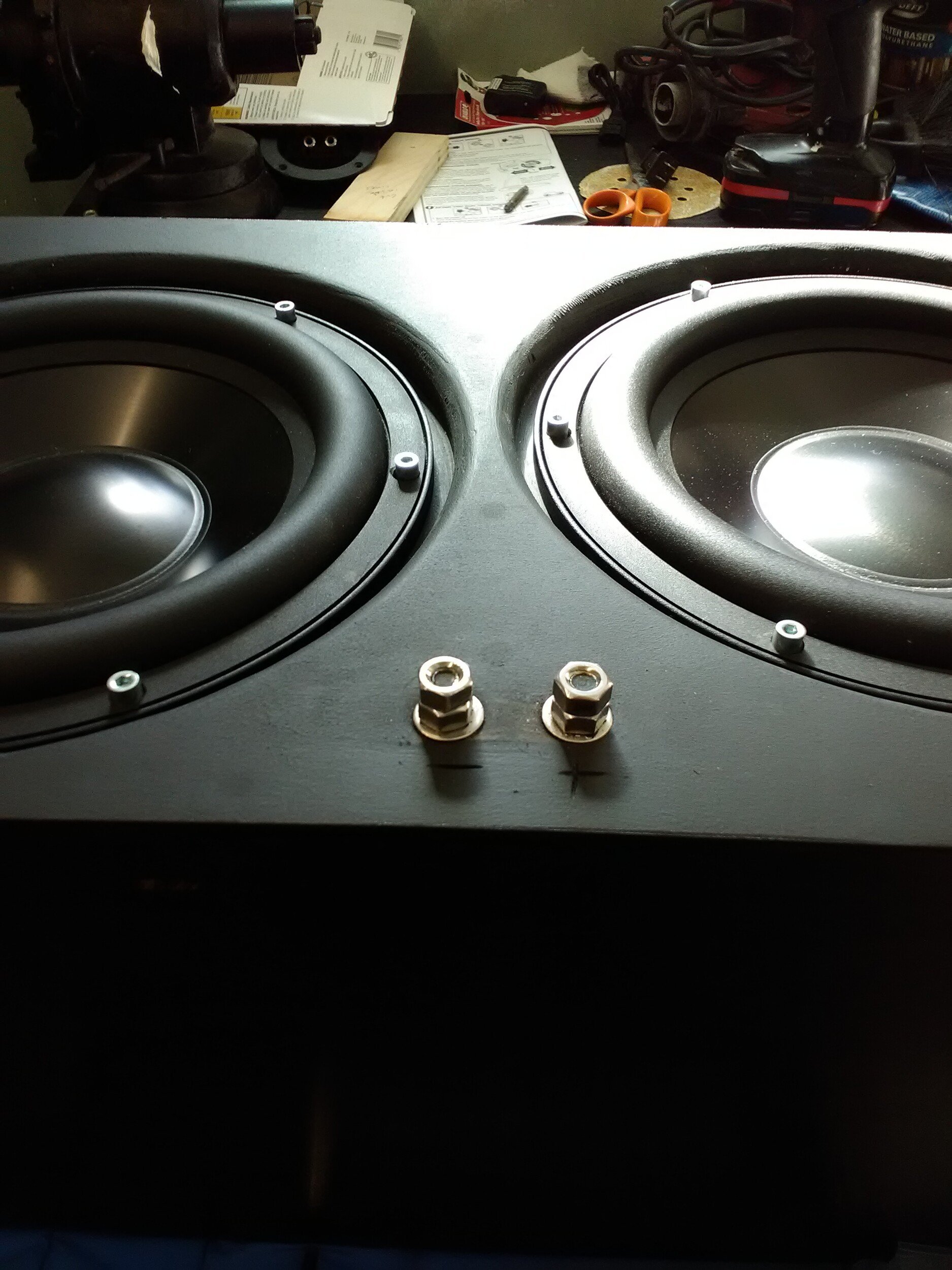

Here's some pics I had on my phone when I built that.
The legs in the rear made the box sit level so there is quite a bit of room between the subs and floor.

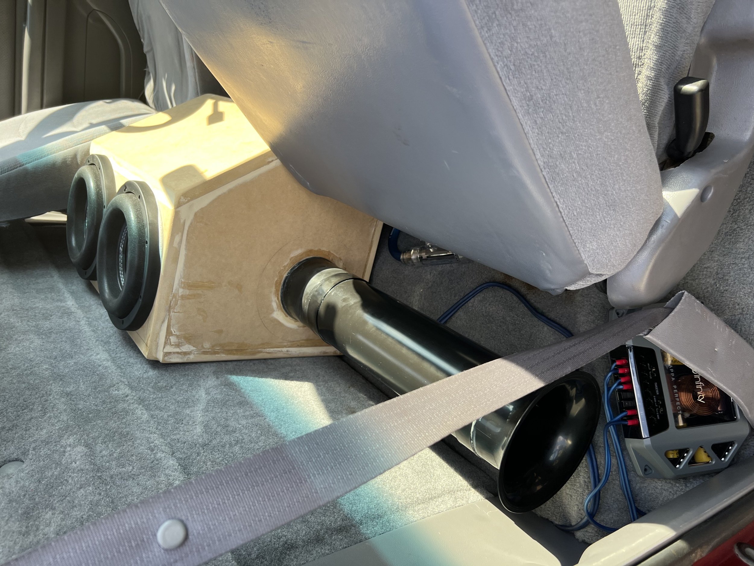

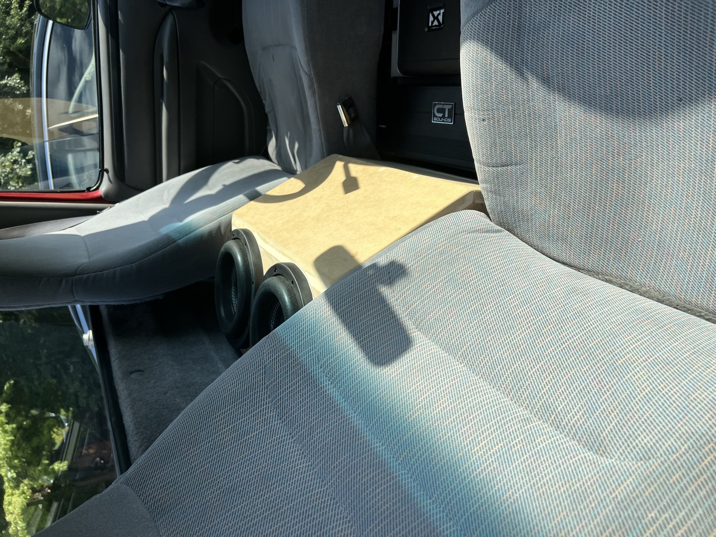

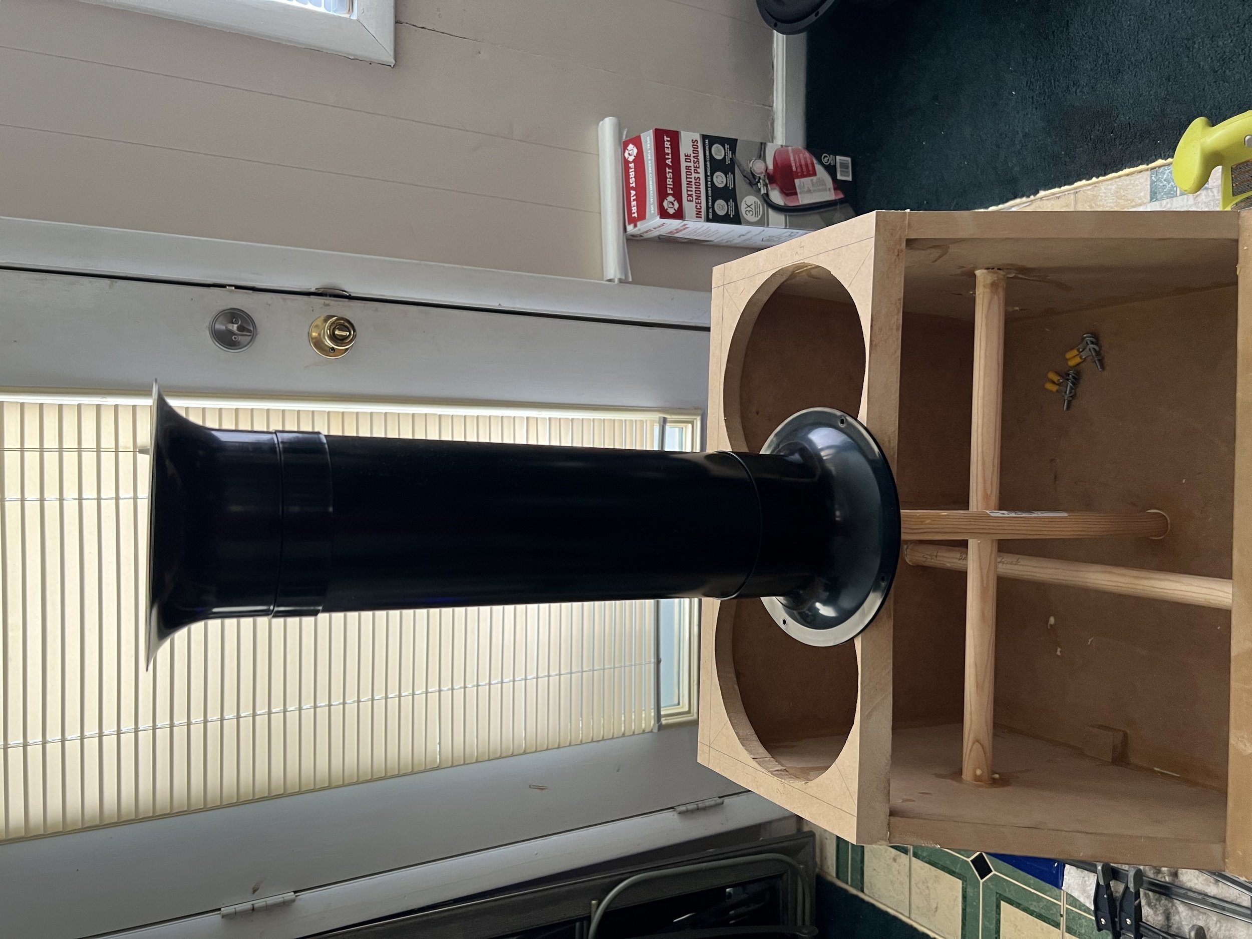

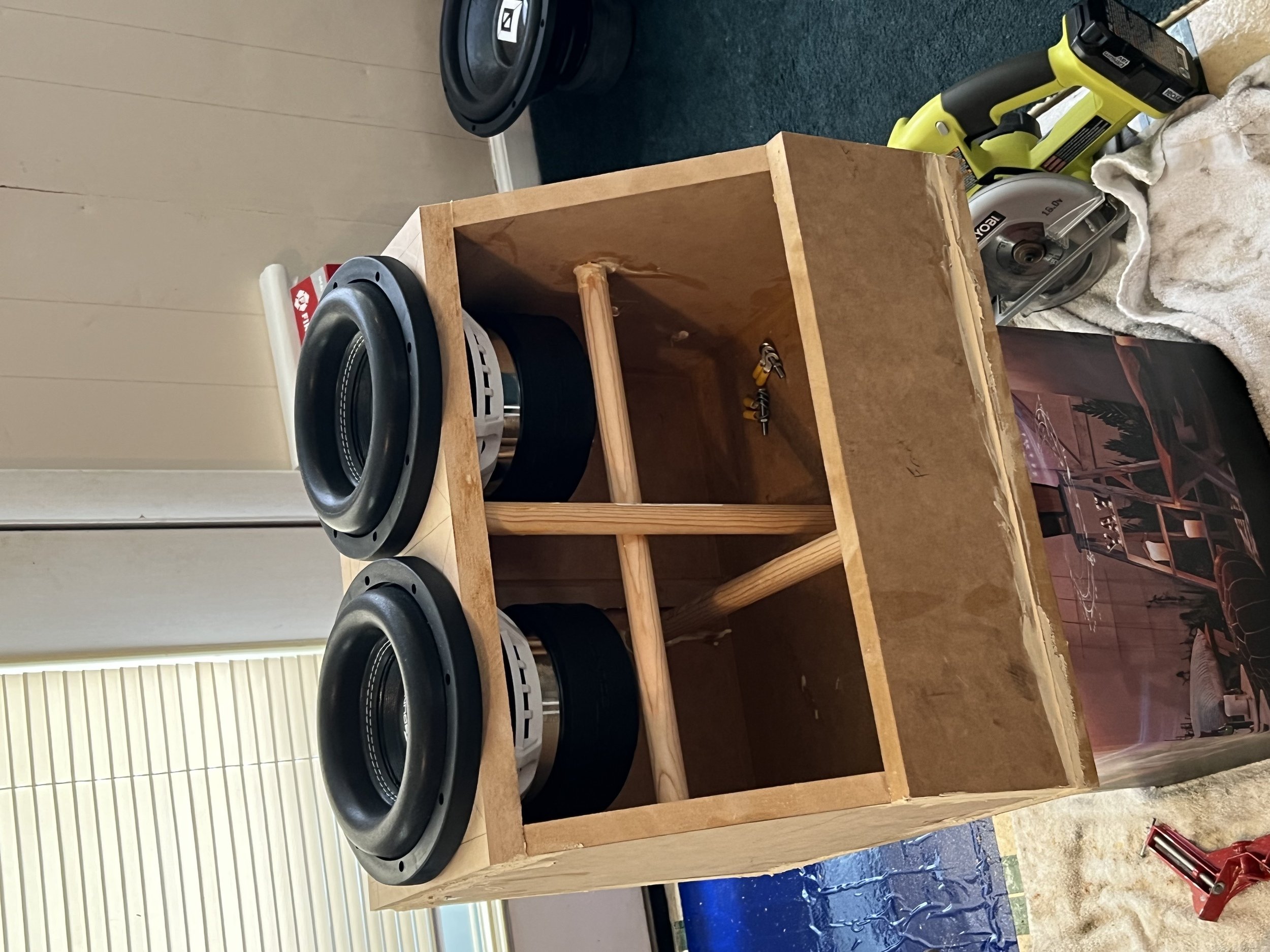

Ok guys, so I decided to do some riding around today since it’s soo nice outside. Playing a variety of music. I discovered that my box isn’t as solid as I thought. One of the angles seems to be coming apart. I wondered why my bass sounded better when I would push the box against the back wall and once I moved my hand applying pressure, I would hear this weird sound. Also, I am not sure if my 4” port is sufficient. I did a design in bass box pro and the 4” port seemed to be stir simplest.
Can someone model my Strato 8’s and see ifI have enough port area? Amp is Ct sounds 2000.1. Instead of going a different sub route, I want to see if I can get my current setup to sound better. If I need more port area, I can just build another box and this time take my time and do it right. Thanks for all you guys help and suggestions but I’m going to try and make these strato’s work. They put in work and I do like them.
