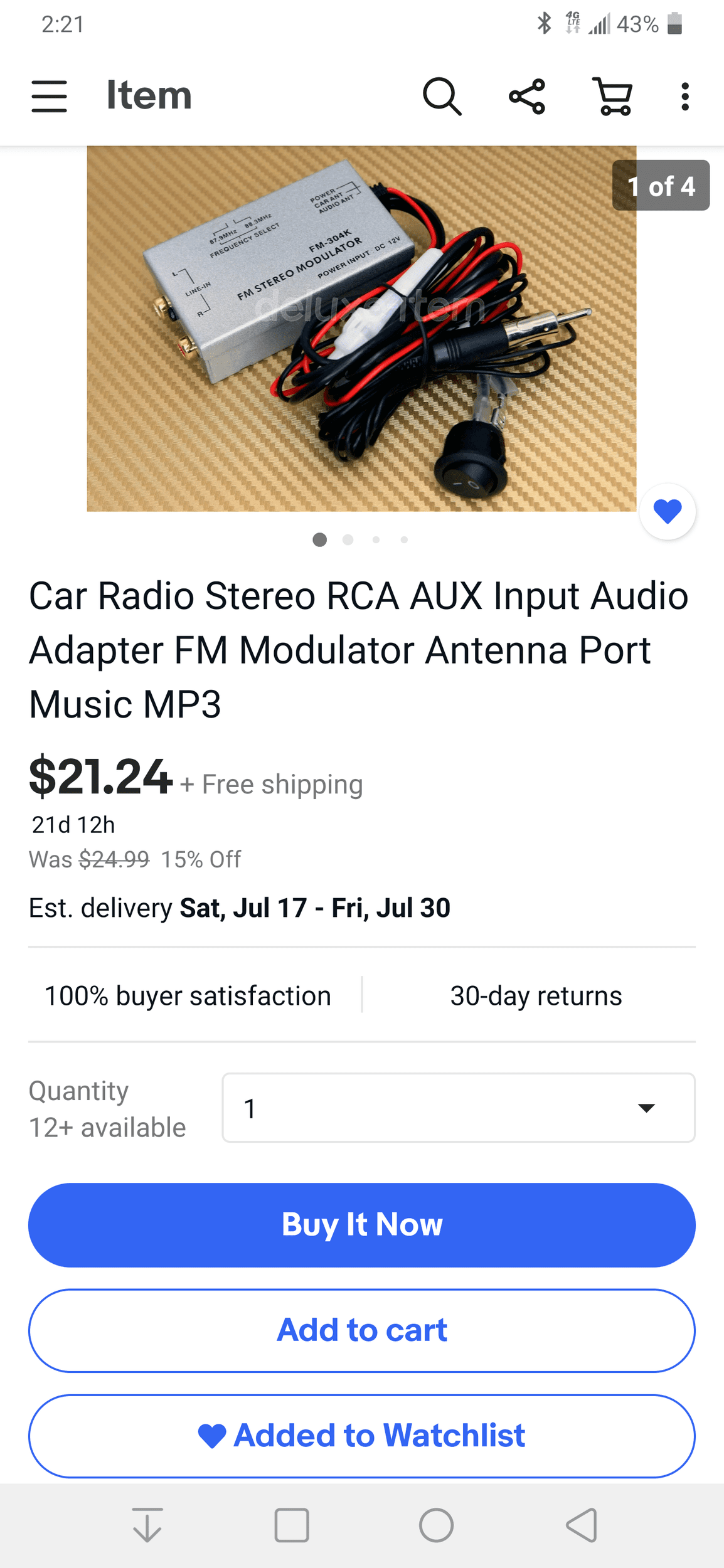

Auxillary cables are simple 3.5mm to 3.5mm wires that conect to the front panel of the radio from the headphone jack of any player. So no labor is required to connect them, and the cost is about $7 in any gas station. Most radios change input to AUX when the button is pressed, BUT, I have seen some that do not change unless a source is connected to them. If that does not work, you can try the following.

It might be worth trying it for shits and grins, but I have a feeling I'll pull it all open to plug in the connector and it won't work anyway. The mod I have my eye on is $140 which is the main reason I'm hesitating so much.
I remember using one of those many years ago to play my CDs through the radio. I had a 10-disc changer in the trunk, and it worked fine.
