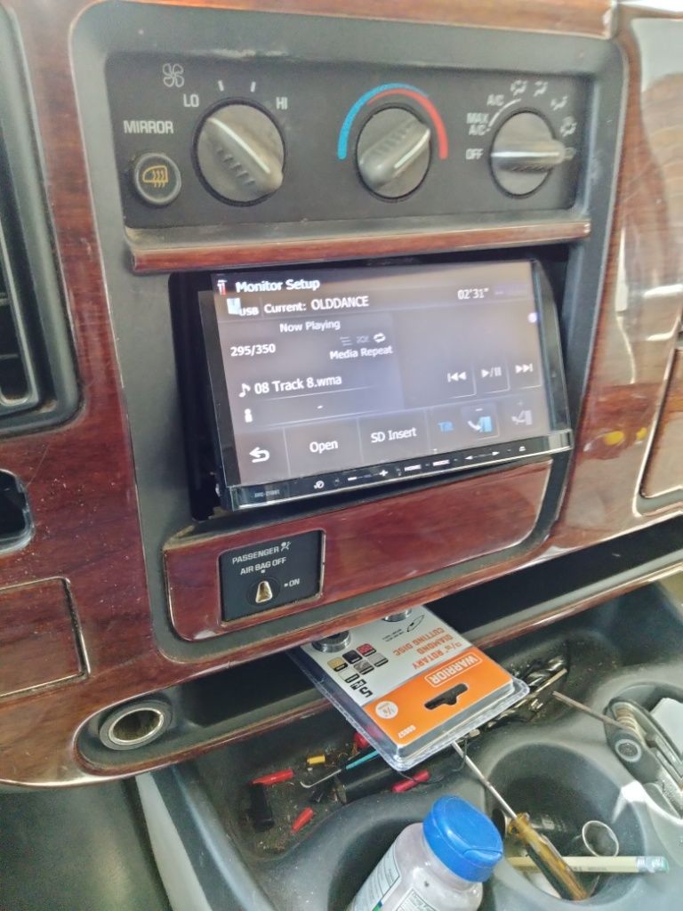

Recently installed a new radio in my 05 chevy express 3500 van.
The radio needs a constant 12VDC GMs yellow wire an a switched 12VDC red wire.
Since my radio doesn’t have a on/off switch like the OEM radio I’m thinking I may have to splice a switch inbetween the switched 12VDC yellow. Will doing this effect anything other than the radio? thanks
thats just a fuse I want turn on/off the AVIC when I feel like thanks
No, it's fused lead to use from your cars fused accessory panel in case there wasn't one from the previous radio. It would turn you radio power on whenever you initiated the ignition. Your post is a bit vague in why there is no turn on/off option.
If you use a toggle switch on the main constant for the radio will do the trick, but you won't retain the settings each time you turn it off.
How about telling us whey you don't actually have the normal on/off/acc option?

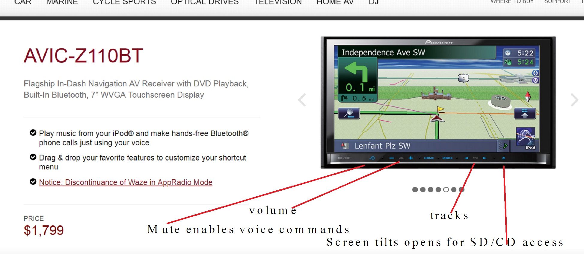

Pioneer didn't put a on/off switch on the radio or I missed it. like there are times I want it off.
my orginal chevy radio had the on/off switch as did every after market radio I've ever owned an I've over a dozon. this on/off is always on the far left.thanks
There must be a soft screen switched on/off somewhere. In the manual it states:
Tolerable temperature range:
Power on ............................ +14 °F to +140 °F
Power off ............................ –4 °F to +176 °F
which tells me that you should be able to turn it off and on (and that sucker gets hot)
It may be that the off does not completely disengage the unit so while the screen is on, the unit is not actually on. There is some info in the manual about turning BT off/on, etc. I would google the model and turning unit on/off. Might be a Pio forum too wirth looking into as well.
