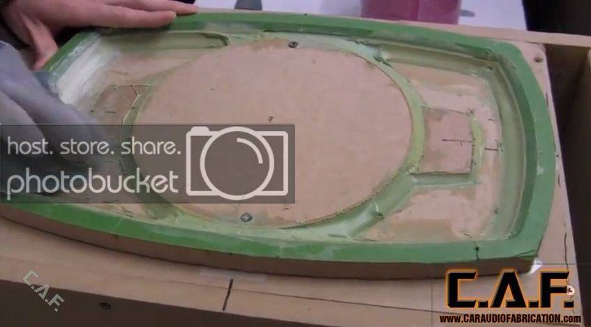

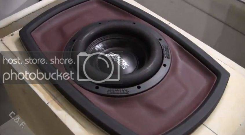

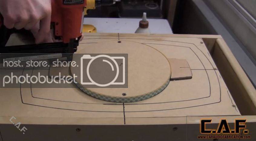

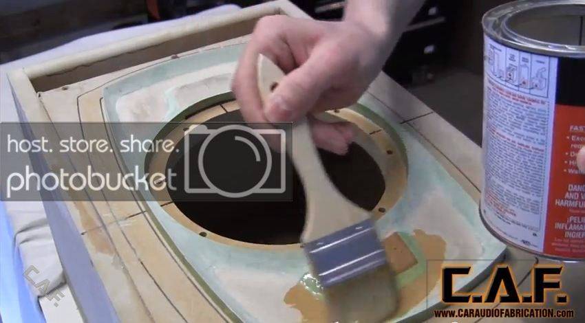

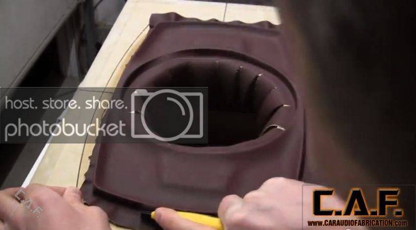

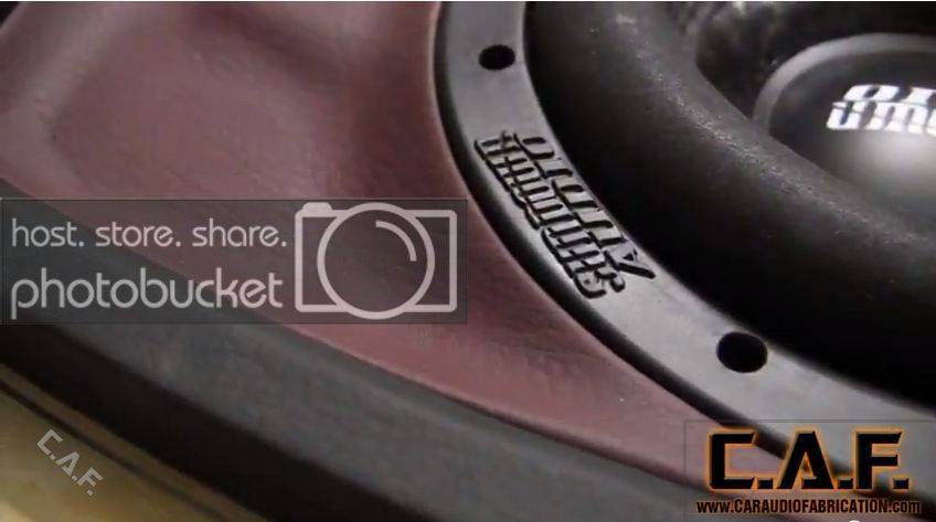

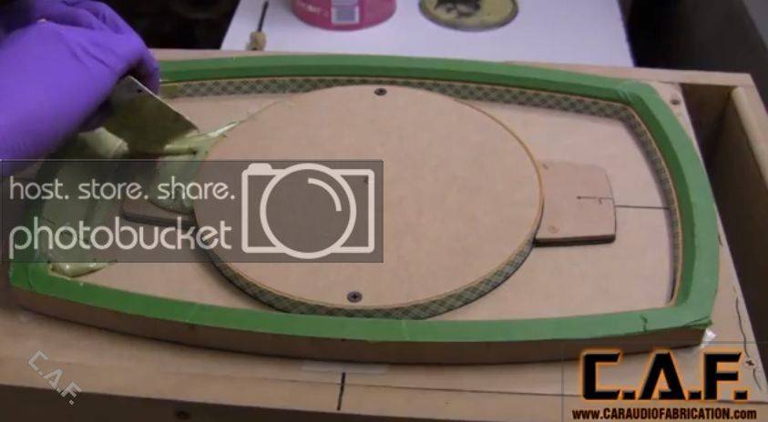

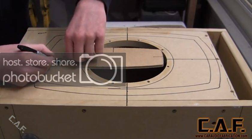

Hey guys, in this episode I show you how you can take a seemingly normal box, and make it truly custom and one of a kind, and integrate it into your install, and really give your builds a PROFESSIONAL look.
Here is the video:
[video=youtube;EbP-H3hh5XA]
The pictures below outline the steps:
1: Laying Out your shapes and ideas:
2: Preparing the shapes for body filler:
3: Applying Body Filler:
4: sanding Bosy Filler:
5: Prepping for Vinyl or Paint:
6: Wrapping the panel and triming:
7: Finished Product:
8: Finished Product:
