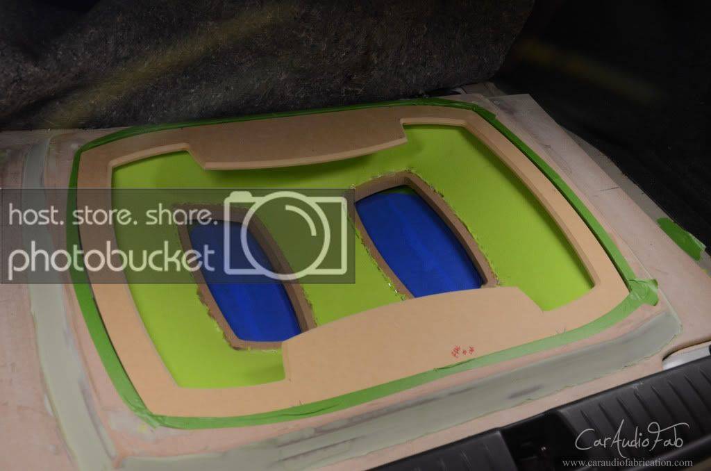

Once you have all your skeleton pieces built for both supporting the equipment and hiding the equipment you are going to want to prepare the skeleton for fiberglass, the professional way.
3) Prepping Skeleton and Templates for Molding
Here is where the rabbeting bit and the router come into play. If there was ever one ‘most important step” within the process I would say this is it. This step is often skipped and leads to tons of more effort in the fiberglass stage. Pay close attention to the steps performed here, and follow them!
How to rabbet a groove for fiberglass treatment - Amp Rack 101 - Car Audio Fiberglass How To - YouTube
Following the steps in the video will allow you to cut a perfect step in your skeleton pieces. This step will lead to a flush fiberglass surface that is easier to sand and fill with body filler.
4) Applying Fabric – The Skin of Your Shape
Here is where your design will really start to become a reality. In this step you are going to stretch material and adhere it to the bounding surfaces of your amp rack. This is where properly preparing your amp rack skeleton will really pay off.
Within the video you will see how I stretch the material properly in a manner that avoids sags and wrinkles, and also how to easily adhere the fabric and trim it perfectly.
How to stretch fabric fleece - Amp Rack 101 - Car Audio Fiberglass How To - YouTube
Upon completing the stretching of your fabric you are ready to move onto adding some fiberglass strength!
5) Glassing and Strength:
Now that you have a super clean and functional fabric surface prepared it’s time to add some strength! After all we want our fiberglass amp rack to last for years in the harsh automotive environment, so let’s get to work making it ready for the abuse!
In this step you are going to learn to apply fiberglass resin to the fiberglass, you are also going to learn how to apply fiberglass chop mat. Though there are different techniques that can be used in this stage, this is the method I use and have never had any issues. Note that if you do in fact have access to the “rear” of the panel it is advantageous to apply the fiberglass mat to the rear. This allows for a smoother surface to sand later on, but in my case I did not have this option.
People who are new to fiberglass are often surprised how simple this step actually is! Watch and enjoy!

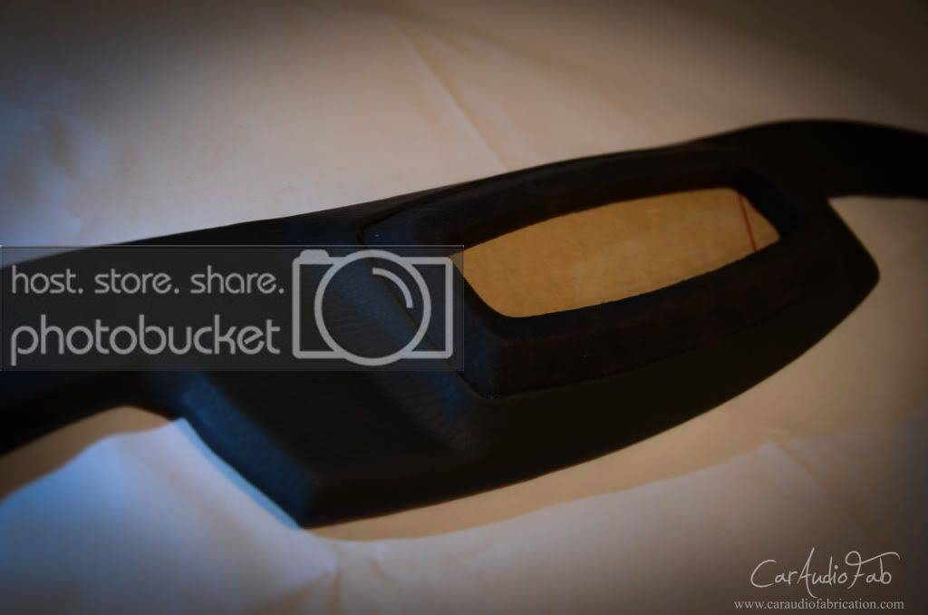

8) Wrapping the Amp Rack: Vinyl, Suede, and Carpet:
So it’s finally coming all together! You’re ready to finish the amp rack off! In the first video you will learn how I wrap “basic” panels, which basically does not require the use of a heat gun, but requires you to rabbet the edges of the panel for a clean finish on the rear side. In the second video I will show you how to wrap more complex panels, which requires a more aggressive adhesive as well as the use of a heat gun when using vinyl to properly form the piece and avoid wrinkles.
It is very important that you take your time in this step, do not attempt to secure materials before your adhesive is tacky. If you try adhering the materials to early will pay for it later when the material pulls away from the panel. It is also important when wrapping a complex panel to utilize high quality glue, as I will recommend within the video.
How to Apply Vinyl or Suede - Car Audio - Amp Rack 101 - YouTube
How to wrap an Advanced Panel with Vinyl - Amp Rack 101 - Car Audio Fiberglass How To - YouTube
