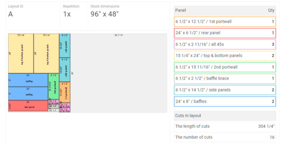

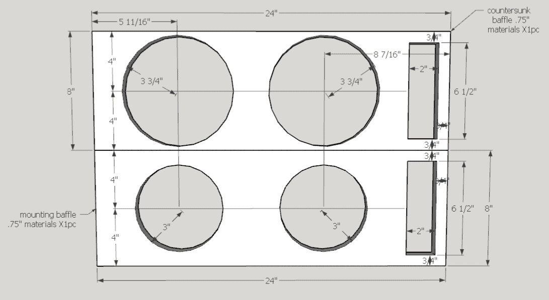

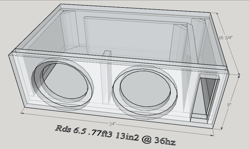

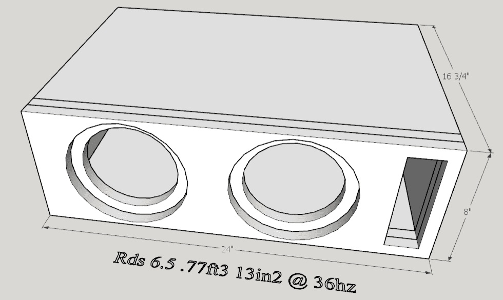

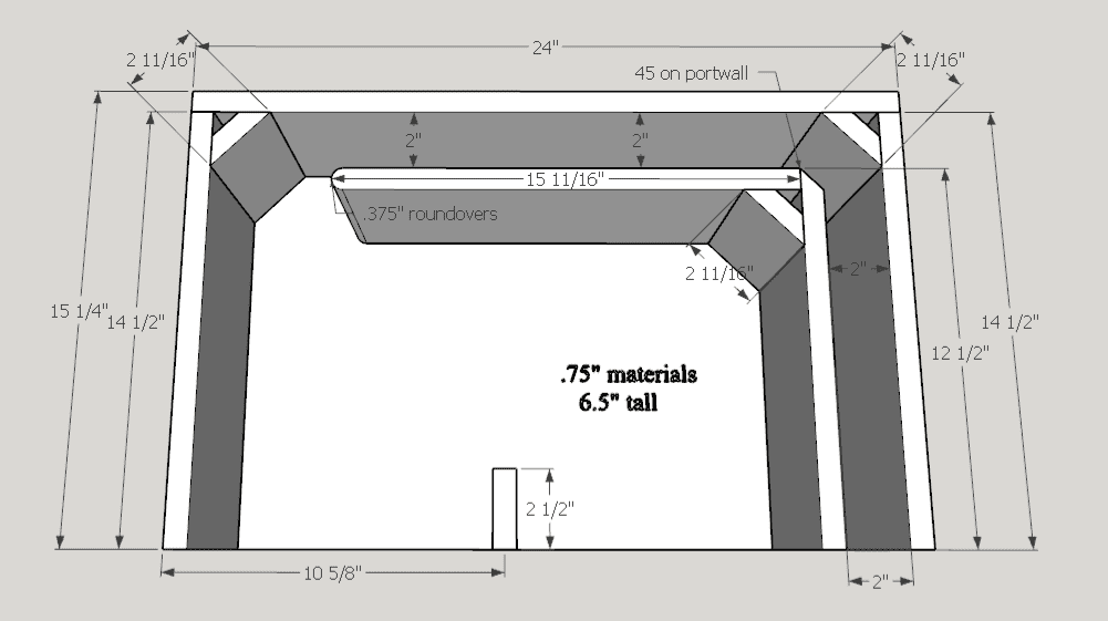

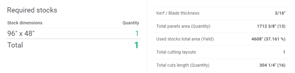

Jmho but until it approximates an actual modeled and rendered design it looks like a box calc program to me with a few bells and whistles.
If it modeled it up custom then produced a rendered result with cutsheet like this, that would be slick... this was all done with free software and screenshots.

The free software I use is Torres to rough in the overall size, Winisd or BBpro to model volumes, velocities, response etc. I can also to some extent simulate cabin gain as related to response due to extensive experience and testing. To truly learn Winisd or BBpro requires real world results and testing in my opinion. I am still learning myself but have 10yr+ just using modeling programs (car audio 35yr hobby) Modeling is not the mechanical drawings btw. A great many people think subbox is modeled since it has a rendered 3D model that can be changed. I am sorry if you think that is modeling as related to sub enclosures... it is not.
I don't whip up generic manufacturer recommended boxes unless asked to do so. I usually take Musical taste, vehicle, power, electrical, goals... etc into consideration when contacted about a design. Its a process that usually requires some back and forth.
The rendered mechanical drawings are done with Sketchup. Its not hard to learn but can be tricky.
Every step of the process is backed up by pencil on paper or a calculator to verify volumes and displacements before I model it one last time for final tuning. 6ths can be fun, I try to nail a 1/2 octave spread on tuning exactly in most cases. Weird, but it keeps my mind active figuring displacements/volumes while I finish up the last modeling session before finalizing the design.
A designer can use his extensive experience to help in most cases, knowledge is power. Drawing up boxes is easy. Its putting it all together in a way that best performs in a specific vehicle with a specific goal.
