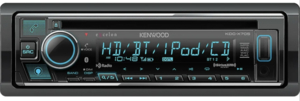

I wouldn't go with that head unit. It has one preout, (/RCA output to an amp). There are ways around this, but if you haven't bought it yet, you are really limiting yourself. You can buy a better head unit for $20 more now, or buy a bluetooth or 5 ch amp later, and both of those options cost more and are really limiting. - Find a head unit with at least 2 preouts. (2v-5v is most of em, higher voltage is better).
With your speaker choice, what I would actually do is find a head unit that has 50w x 4 RMS. That's what those speakers you picked call for, and it saves you from buying an amp (, wiring, a fuse holder). It will save you the cost of the amp + about $50, not to mention space, and the install. Being in a small cab pickup, I would try to "biamp" a set of components off just the head unit, so instead of 1 ch to each crossover then split to a mid and a tweeter, you are sending 1 ch to each speaker. You could get some more power to em this way, and you aren't losing anything if that's all you do. If this interests you, I would start by looking for a set of components before you buy anything else. Get an idea of your total budget, and this is where you have the most flexibility on cost depending on what you want. See if you can find a set that you CAN biamp, and then you would have to find a head unit with more than average power.

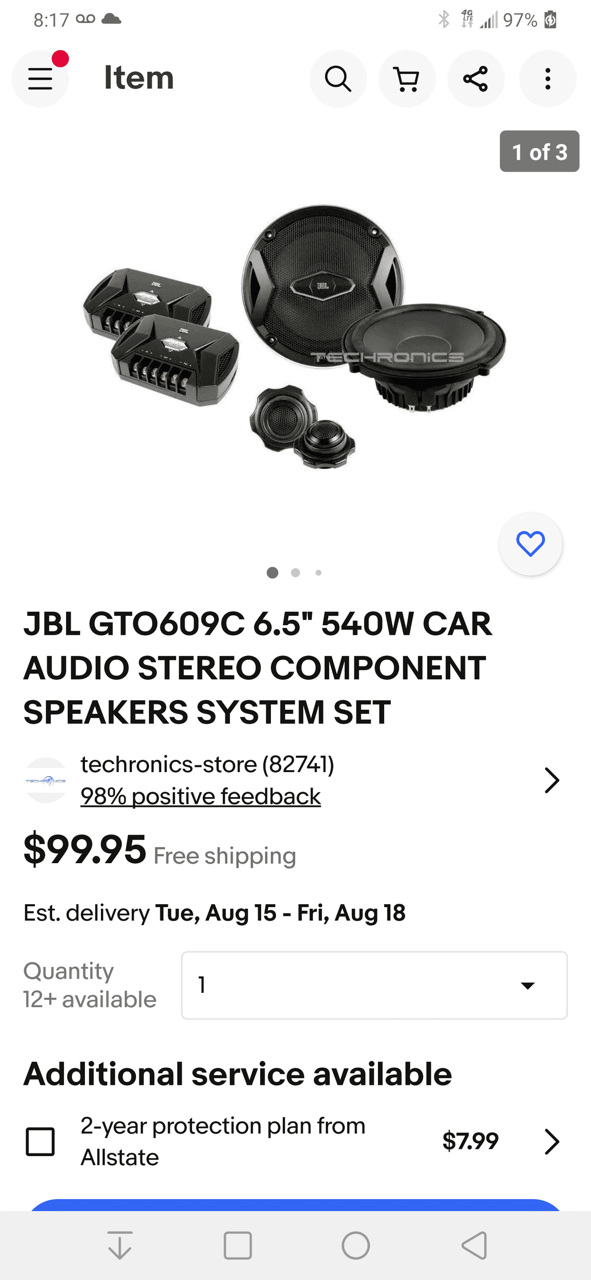

The plan looks good. 3 changes I suggest-
1. Change from the coaxials to component speakers. That way you can set the tweeter higher for a wider stage. These JBLs are pricier but worth the coin

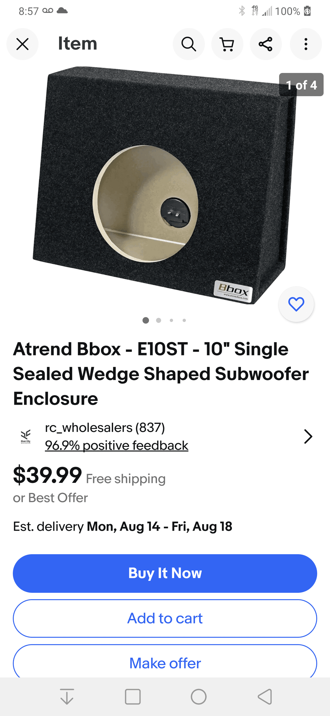

2. I would do away with the underseat sub. IMO those fall short of their intended purpose. Instead I would opt for a rear seat sub enclosure powered by the rear channels of the 4 channel amp.

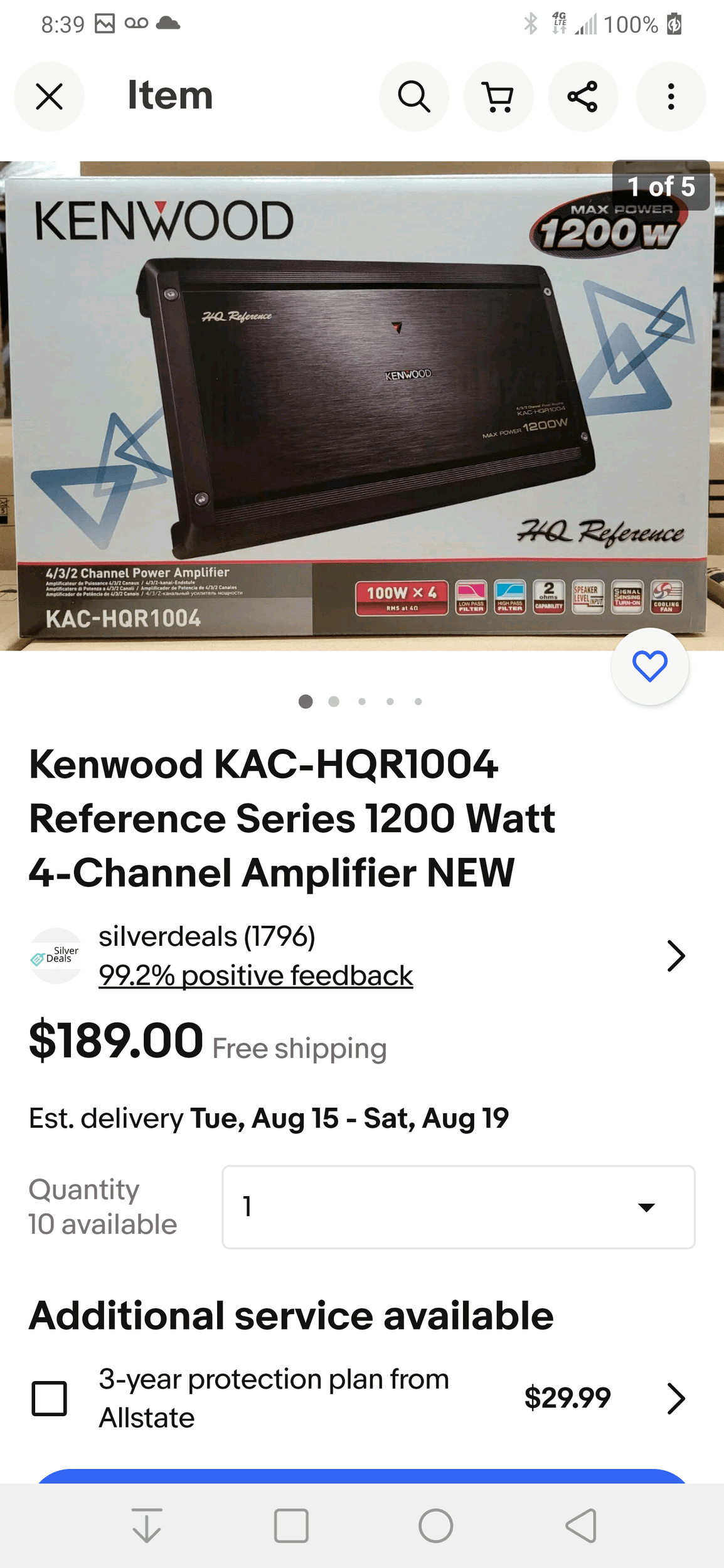

The front channels can power the JBLs. The signal will come from the RCAs of the radio. You will not need the radio's high output.
3. As for the amp, I tend to trust one with a bigger footprint for actual output and heat dissipation. This Kenwood has more power and better wiring terminals for the speakers. The bridged rear channels will give a nice 270 watts. That is plenty for a nice kick to your seatback.

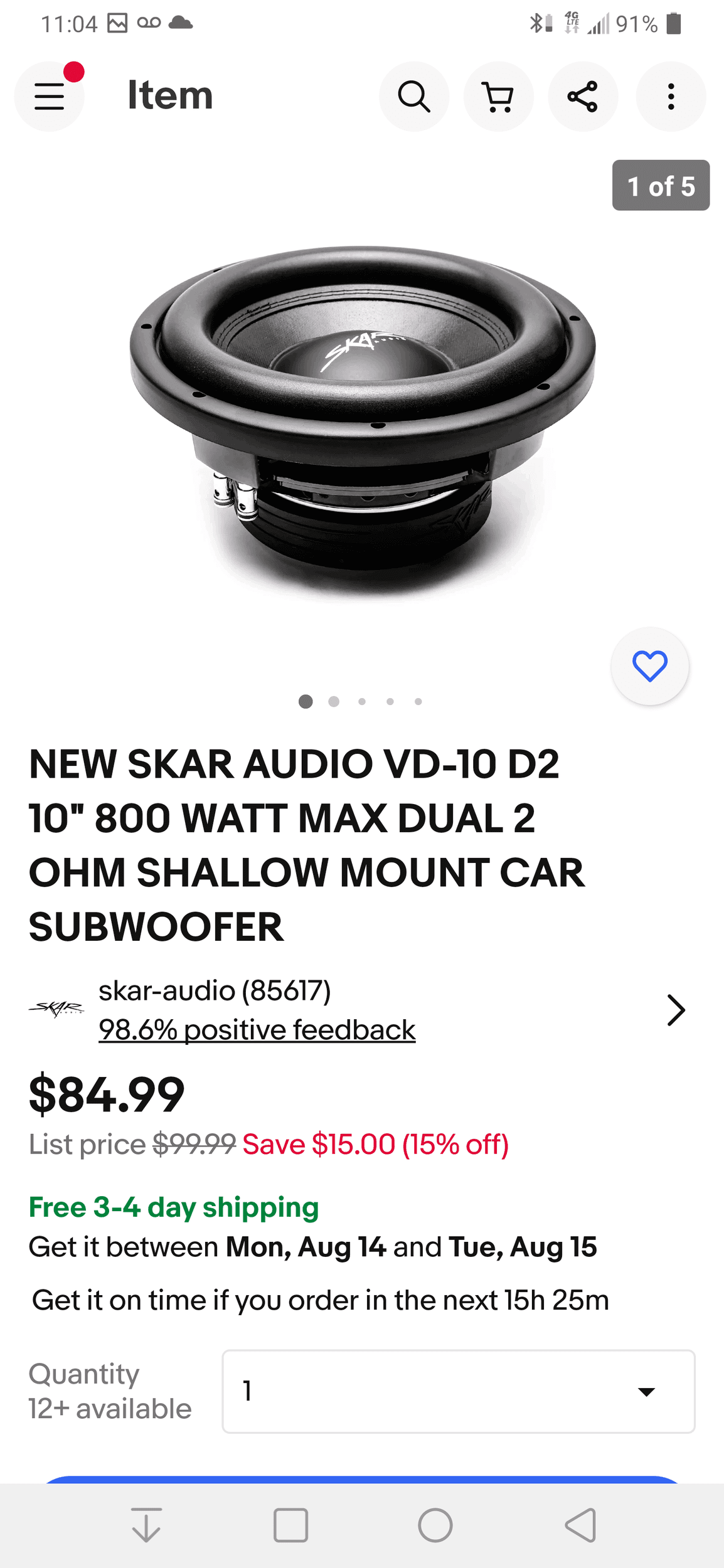

As for the sub, I do not know how much space you have behind the seat, but this type of box is universal for most single cab back seats. The shown sub is the perfect fit for the box.

HU? Simple HU. The HU is your WorkHorse of your system. I would prob go with something like these

You will have to shave the Diameter of the enclosure for the sub. Its pretty easy to do with a Wood Bastard file and a little patience. Just a few recommendations for the truck system. Im sure others will Chime in
