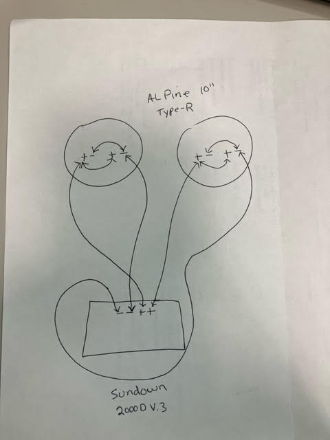

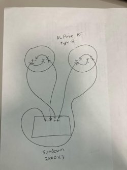

Going to try and run the Alpines at 1ohm in a 1.5cbft sealed box. Does that sound correct?
I'm trying to utilize space in the bronco so my sons Guitar(he plays for our youth group at church) can still fit and still have space for groceries when shopping.
That should be work...alpine recommends .4-.85 cuft per sub...so you'll be right in line
