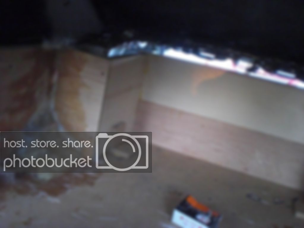

started the day off with a trip to get a new angle grinder because our other one blew up before i could clean up all the cuts, and some cut off wheels. cleaned my back deck up all nice, then started on the trunk portion of the box.

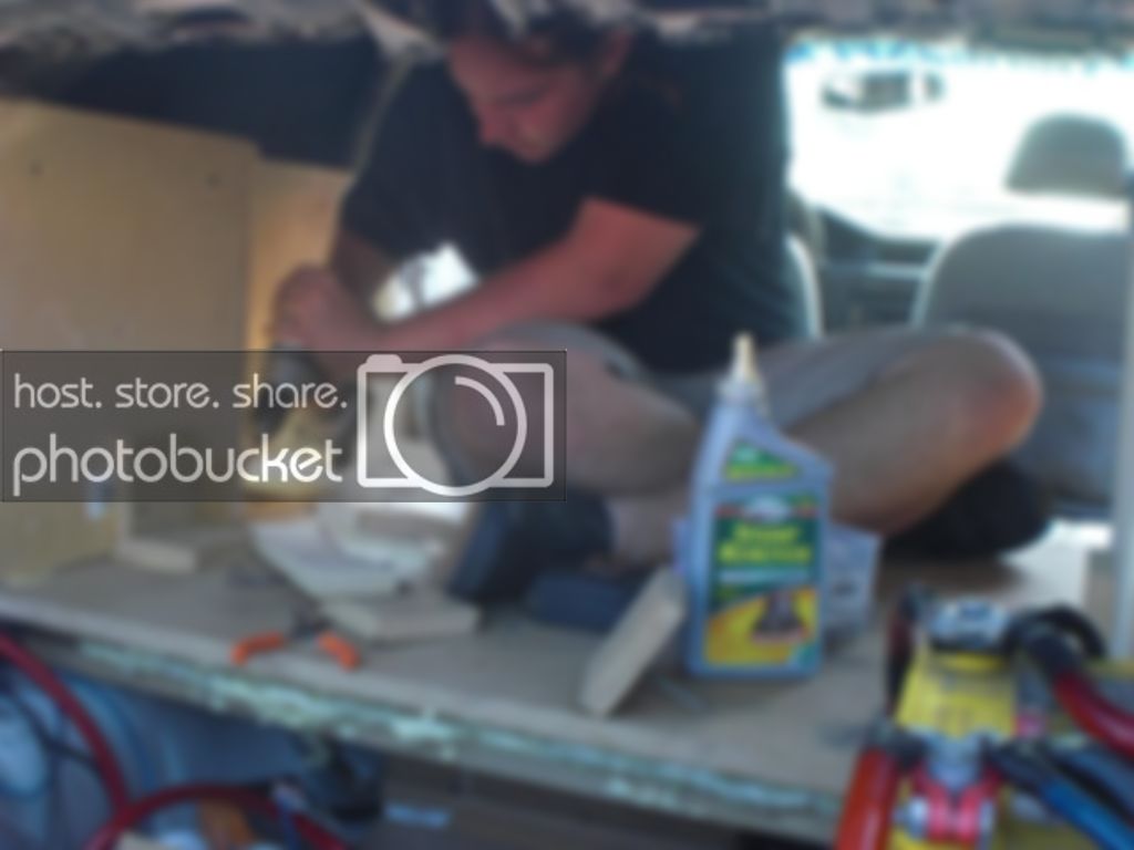

the stump remover bottle is actually wood glue, we use it because the tip is circular instead of the flat line on the woodglue bottle that i hate so much haha

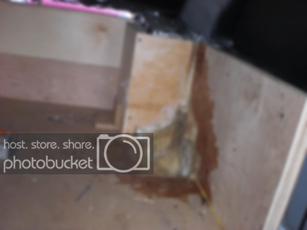

glassed in the wheel wells. ~4 layers on each side. doin 4 more tomorrow, along with all the bottom seams
the reason i 2 pieced the back is because im double baffling it, and im trying to use all of our scrap wood layin in the unit.

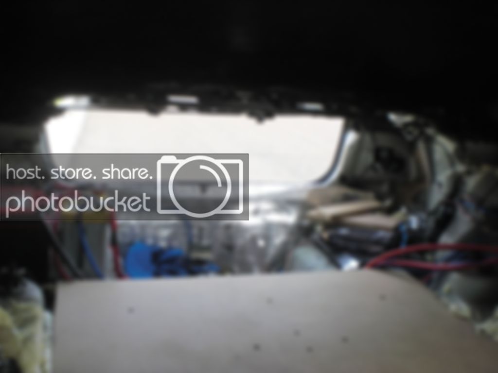

the shell is built and glassed in. 6 cans of spray foam went into the top of the car and around the top half of the wall. gotta clean up the glass a bit and ill take some pics. now that the shell is done im taking measurements and building it in google sketchup //content.invisioncic.com/y282845/emoticons/biggrin.gif.d71a5d36fcbab170f2364c9f2e3946cb.gif
